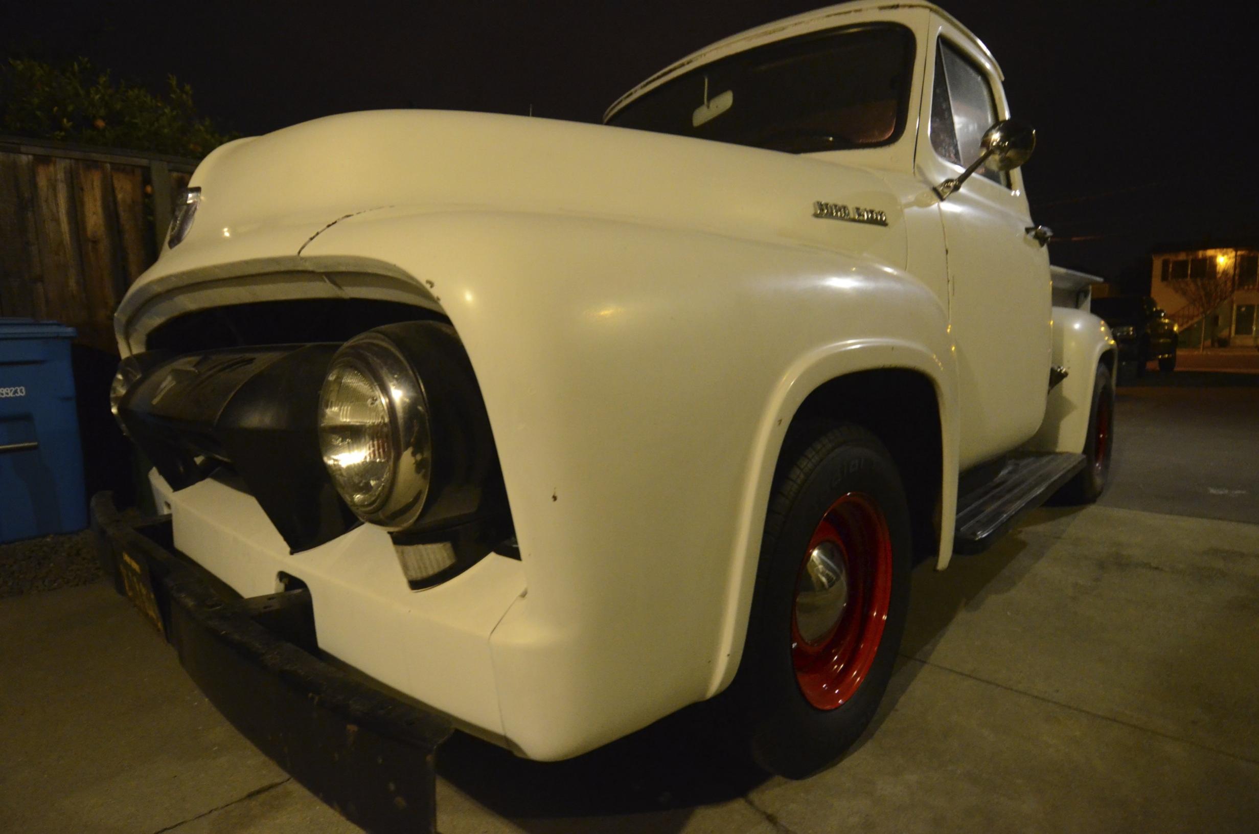

  11. wreckfixer
    Joined: Jun 15, 2009
    Posts: 322
    wreckfixer
    SIDS dropped axle on mine and a leaf or two removed. ImageUploadedByH.A.M.B.1430509801.252463.jpg
    Sprout likes this.

  13. That is one fine truck sits about perfect.
