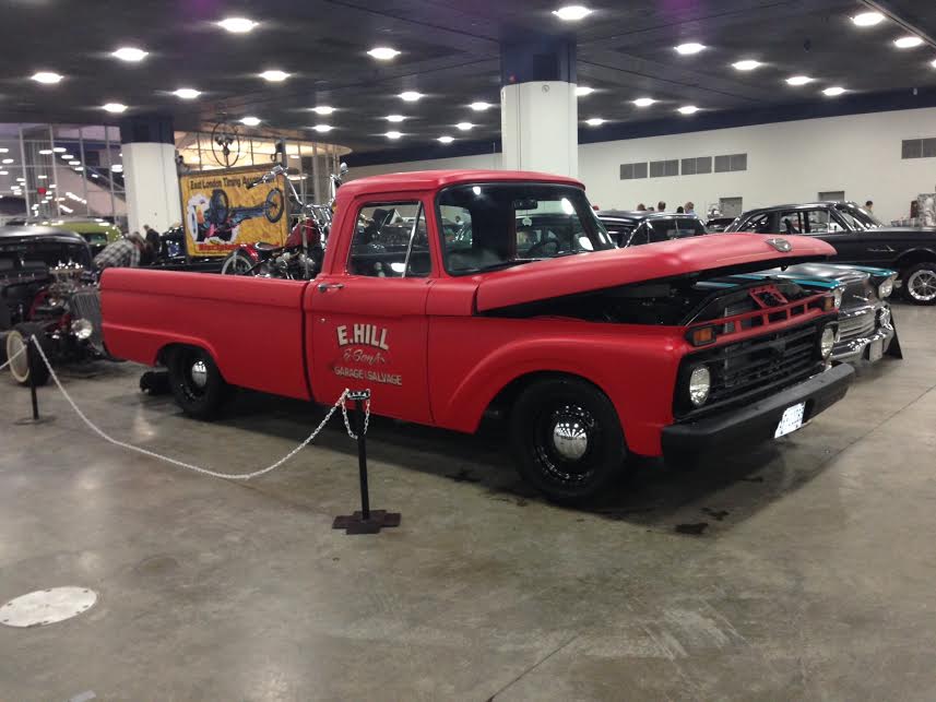

  12. Here's my 65 shop truck with a CV front end, I sectioned the front end in mine by 2 inches, makes a big difference, I have 16's. I think it looks good, the rims and tires fit nice, I'll notch the frame on my 64 when I do it to get it a couple of inches lower. It works really nice, I just put 4000 miles on it in the past three weeks.
  13. Here's the picture.
