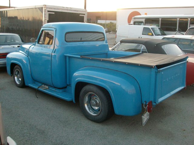

  26. metalman
    Joined: Dec 30, 2006
    Posts: 3,299
    metalman
    The windshield doesn't scare you but the headliner does? Really?
    I'm ***ume you have lots of experiance with wrap around windshields and cutting them since it doesn't scare you. I hope so since more 56s have been s****ped after attempting a chop the almost any other chop I know of.
    I've chopped a few 56's but I agree with some when they say it throws the proportions off. I chopped one 4" (owners request) and I think it looks bad. Chopped one 1 1/2 and it looks good but a lot of work and most folks don't even notice the chop. My favorite is the one below. I cut 2 1/2" but also sectioned the truck 3 1/2", It's low but doesn't look out of proportion.
    (Ignore the wheels, just rollers!)

    that looks great metalman^^^
