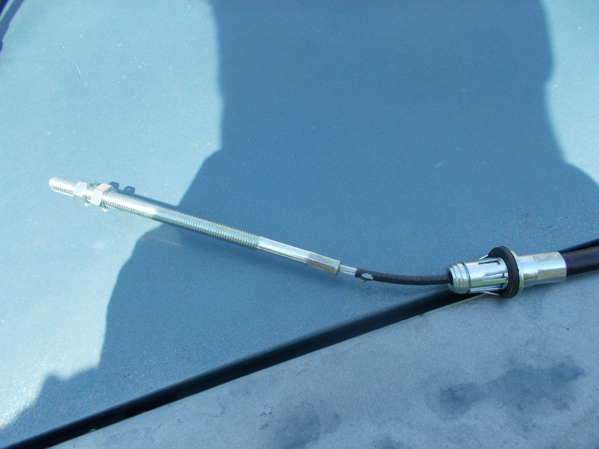

    Early Bronco 9" rears used a long and a short emergency brake cable, short one is fine... but notice the aftermarket long one has 2 hose clamps and a section of black rubber hose slid over the co-axle tube... the co-axle tube is cut in half underneath the hose... there is a foot or more missing... when you anchor the ends you can pull the cable, it taking the slack from the hose, pulling the tube halves together letting the cable extend by a foot before it engages the shoes... no brake brake cable I know of has that much travel...
    . Checked on ebay, all the long cables I saw had the black hose and a hose clamp at each end... please check different pix, some show one with a kink that couldn't happen with an uncut tube...
    Local ford rearend guy says '78 Malibou [10" brake] works for the long cable...
    It has 5" of threaded steel shaft at the forward end, great for adjusting...
    67" overall cables... 52" uncut co-axle tubes... reversed prong clips to secure them, 1/2" hole- anchor measurement...
    ... hope it saves someone else multiple trips to the parts stores...

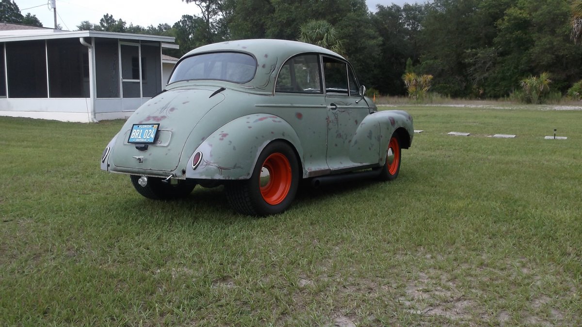

    Used a 70's Econoline 9 inch under my last pro street Morris Minor. Hudlow's 4x4 shop narrowed housing cut and resplined the axles and redrilled the axles and brake drums to 5x4 3/4 to fit my Chevy wheels. Bought a Speedway 4.11 posi 31 spline chunk. Everything fit and worked like it should.
    Stock carriers with a 4 speed ,you better be careful with sticky tires you can blow the pinion out of the top of the housing. Did that with a small block and p/g with a trans brake. Went to a Summers Housing. DSCF0952-001.JPG
