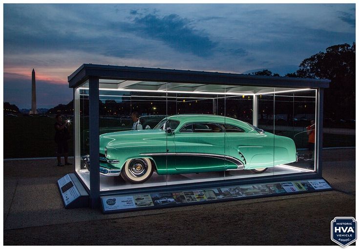

  6. That's what I was thinking for my original post also. You can put gl*** on 3 sides, paint the rest and put in some vents.
  7. Clydesdale
    Joined: Jun 22, 2021
    Posts: 424
    Clydesdale
    I feel like anything you do for 3k is gunna look like something that cost 3k.
    Surely the whole point is to allow attendees to view said vehicle, the display has to enhance the experience otherwise you'd be just as well putting it on a plinth with a wrap around walkway.
    No way any sort of painted plywood, stretched PVC, chopped up container etc etc is going to enhance the view of said vehicle.

    If what you need is something similar to what is pictured in post #1......
    Step 1: Take said $3k budget to the horse track and try to turn it into $20k.....or even better, $30k.

    I'd look into how the high dollar designs are done and try to find economy, but 3K isn't going to be much more than the tent shown.
    If possible, look into local businesses and millionaire homes being remodeled. Low end, gather up sliding doors that have been replaced and weld the frames together.
    I understand the visual impact of trying to emulate the display, but it's going to take a lot of funds and design to even get something like that on paper and signed off on by museum and city/county/state, let alone sourced and ***embled.
    Even Amish sheds require site work, and they can be hauled on a trailer and dropped in place. Add in a path and circle for visitors, and ensuring access and safety. What is 3K going to get in them? 10x12 foot.
    https://www.glicksheds.com/blog/planning-your-shed/affordable-sheds
    So you have a pad with a path to and around it. You drop off a big enough shed. You then remove the siding and replace one or two sides with the scrounged sliding doors. Decorate the inside 2 or 3 walls as a garage or shop, making sure the clear side is North to avoid sun damage and heat gain. Much more realistic, but probably 3-4 times the budget. Not nearly as dramatic, either.
    EDIT: Went back through OP's other content. Seems to be based in or around the Los Angeles area. With the other local car museum closing down, and the need for materials to rebuild after the recent fires, this task seems even more difficult. Either there will need to be a generous benefactor or they could try to gather up used stuff from rebuilding or both to get anywhere close to the vision.
