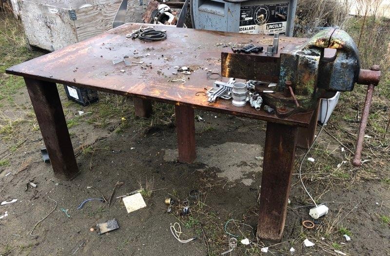

  4. Mr48chev
    Joined: Dec 28, 2007
    Posts: 36,237
    Mr48chev
    I would have to believe that it has more to do with what you are inclined to fabricate as far as size and thickness of the top. I have two 2x4 steel work benches with 5/8 steel plate tops that are good for fabbing and pounding on. .
    I keep eyeballing this table on FB Marketplace but don't have enough room for it. No idea of the cost. they had four and this is the last one. Welding table.jpg

    A five legged table. o_O

    Always glad I read this stuff.
    5 legged table. Good solution.

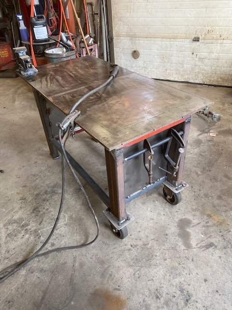

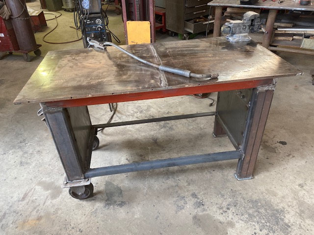

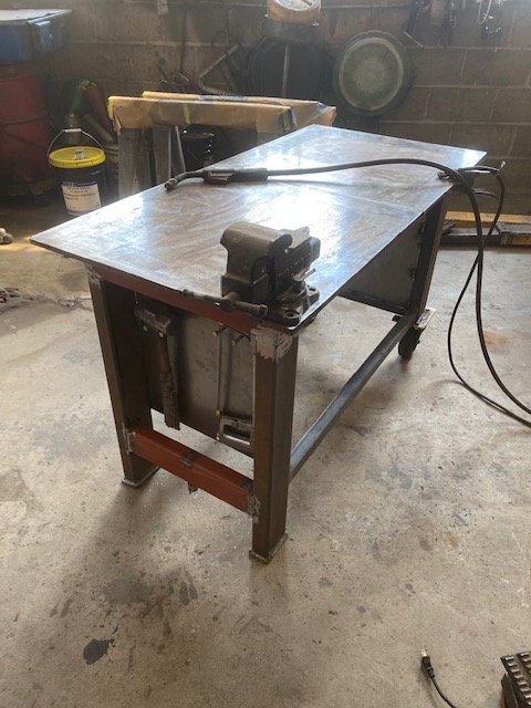

    here is a handy little table I just built. 23"X46" with a 1/2" top. two fixed wheels on one end. legs under the vice with a jack point to move it with a floor jack. under the vice a spot to hang a hammer, hacksaw and a shelf for an oil can. on the other end a pipe to hold C-clamps. stainless shelf across the bottom. two of the corners were cut, one with a 45 degree angle, the other a 2" radius. 60883237863__25154B16-7F2D-4DD9-A3D8-02DBD13DF071.JPG

    Posts: 2,046
    Fitnessguy
    Nice, I like the idea of the wheels on one side. Would make the table more stable vs 4 swivel casters. Would be great to have a huge table with a 1000lb top but for smaller shops like mine, just doesn’t work. Nice design

    The 5-legged table looks solid and that monster vise is beast! Older Parker or Reed? That piece you could p*** on to your kids, their kids, their kids and probably their kids!
