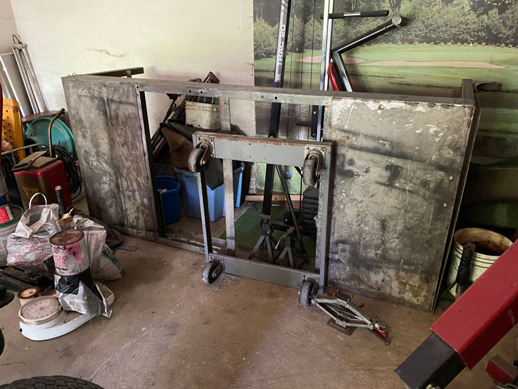

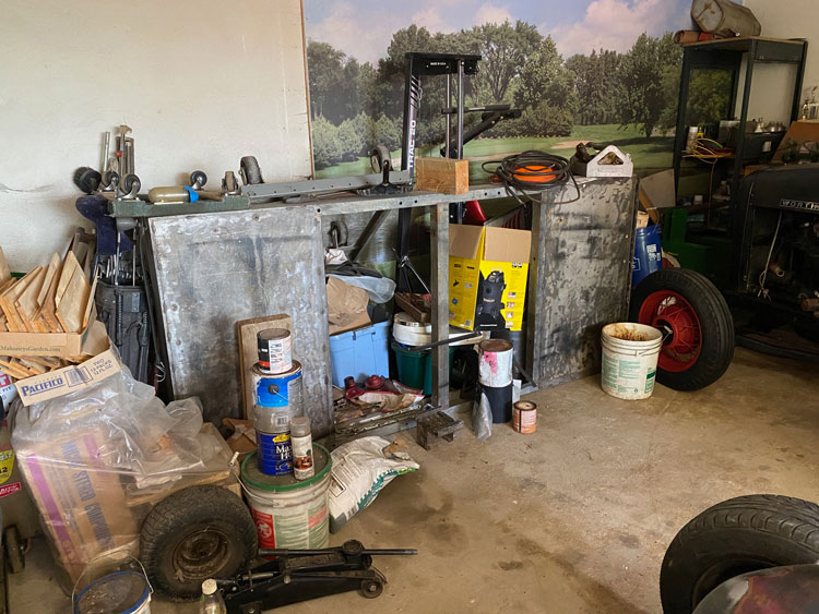

    My friend has a frame table used to build '32 Ford frames. $300. Located in Central New York 13346. 315-749-4649

    Here are some photos of the frame table. It is sitting on its side here. The top surface is 4'x 8' and is very heavy.
