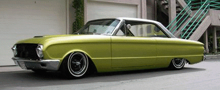

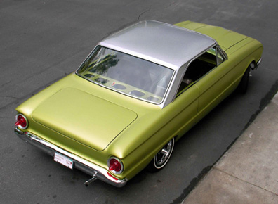

  15. I wanted lime and there are a bunch of new cars using it: Honda, Kia, Mitsu (I think), VW (but way too popular) so I went with Saturn. 2004 Saturn Lime, used only one year on the Ion and Vue. I used a matt clear instead of gloss and it looks like velvet. I absolutely love it.

    Love the paint LaGrasta!
    This thread is excellent.
