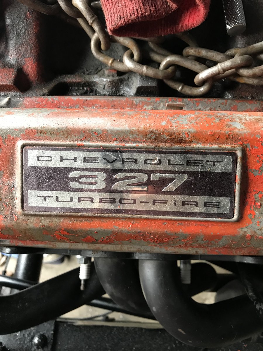

  18. superduper88
    Joined: Sep 13, 2007
    Posts: 214
    superduper88
    33BCB6C4-4990-4039-938D-9BD27CD6D490.jpeg VIN pad on front of block - F06I9DE
    Block number - 3849852
    Head number - 3795896
    Neat-O valve cover - lol
    Bowtie Coupe and catdad49 like this.
  19. DDDenny
    Posts: 23,428
    Boy, I'd say!
    That's a pretty rare cover, one year only , 1962.
    Bowtie Coupe likes this.
  20. catdad49
    Joined: Sep 25, 2005
    Posts: 7,342
    catdad49
    Looks to be a 283 block, possibly from a Chevy II or a Chevelle, heads were used on 283, 307 & 327.

  22. superduper88
    Posts: 214
    superduper88
    I never seen a cover like that one before, I liked them so much I removed them before lifting the engine so they wouldn’t get dented haha
    So looking like I got a 283 with sweet 1 year only 327 valve covers? Damn.
    It’s ok, not the end of the world, but I was really wanting a 327. Oh well lol
    Thanks guys! -John
  23. catdad49
    Posts: 7,342
    catdad49
    Hey, just put on some finned aluminum covers(yes, you know the ones) and you'll be all set. I used to see those valve covers from time to time, never realized they were rare. I have seen some chromed, but don't know if they were factory. Good Luck with your build.

  25. Bowtie Coupe
    Joined: Feb 16, 2009
    Posts: 4,364
    Bowtie Coupe
    It's not the end by any means. Yeah, we all want a 327, but you have a sweet little engine there. A carb, a cam, and a set of headers and she ought to run pretty good. Those heads are of the "powerpack" design, although they were used exclusively with 2bbl carb engines. They have 1.72" intakes and 1.5" exhausts with a 59.669cc combustion chamber. Plus, you have those sweet valve covers, although I'm kinda partial to catdad's idea of those seven fin aluminum ones. Best wishes on your build.
