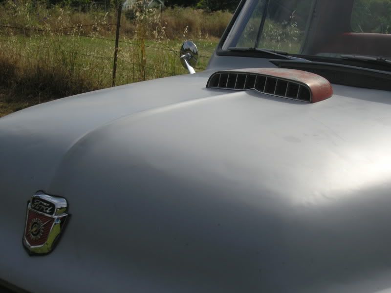

    I've been hunting for one of these Ford hood scoops available on Ford's F600 and larger "Big Job" type trucks. I finally scored one and got around to mounting it on my 1953 F-100. I'm not used to cutting up my sheet metal, so although I had easily envisioned it in place, it took me about two weeks to getting around to actually doing it.
    Well, a cardboard template, some blue tape, a pencil, drill and jigsaw along with my newly found nerves of steel and it was in place. Not having anything to use for placement along the rib of the hood, I went about centering it over the dual Strombergs and called it good.
    I'm going to run it as is for a while before probably painting it the same red as my firewall, dash and wheels. It is most surely in for some pinstripes in the near future.

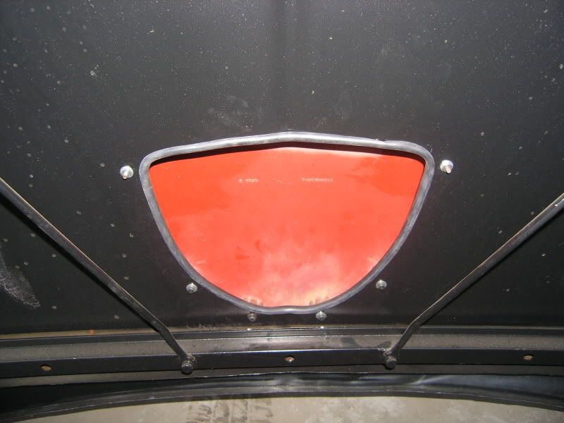

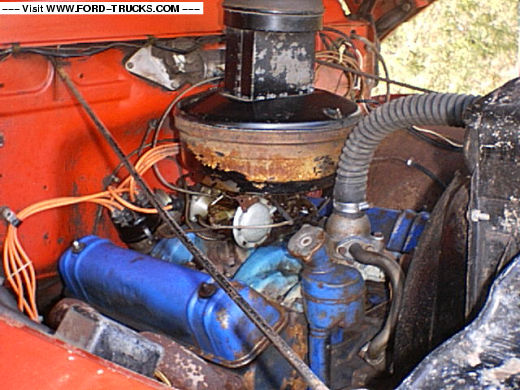

    nice!!!!! Here's my scoop i have been hiding in the garage. It came off a 56 T-750 Big Job cement truck.
    i considered putting it on my 56 F100 but decided against it. I have the whole "fresh air" setup. here is also a picture of what the fresh air setup looked like from the factory.
    Can i ask what you paid for the scoop?? ballpark. just curious what they are going for.

    It is pot metal, about 1/8" thick...much heavier than you might first think. Another interesting note, at least to me when I was at Ace Hardware getting screws to affix it, Ford cast the proper screw size and threading into the underside near one of the screw holes. I'm not sure why, but I thought that was kinda cool.
