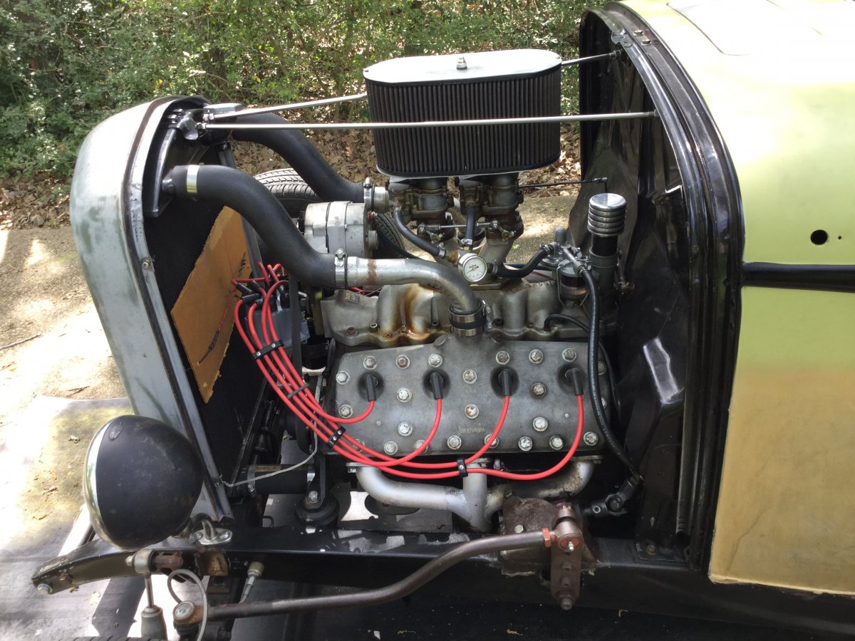

    image.jpeg According to Joe Abbin,flathead wizard from Albuquerque, the best flowing aluminum head is only 2-3-5 h.p. over a stock cast iron head that has been modified. His 34 sedan makes 335 h.p. with a small blower and he runs modified cast iron heads. He is an engineer; has a flow bench and a dyno and knows how to use them! His 34 sedan runs mid 12's and is regularly seen on the street at car shows and rod runs.
