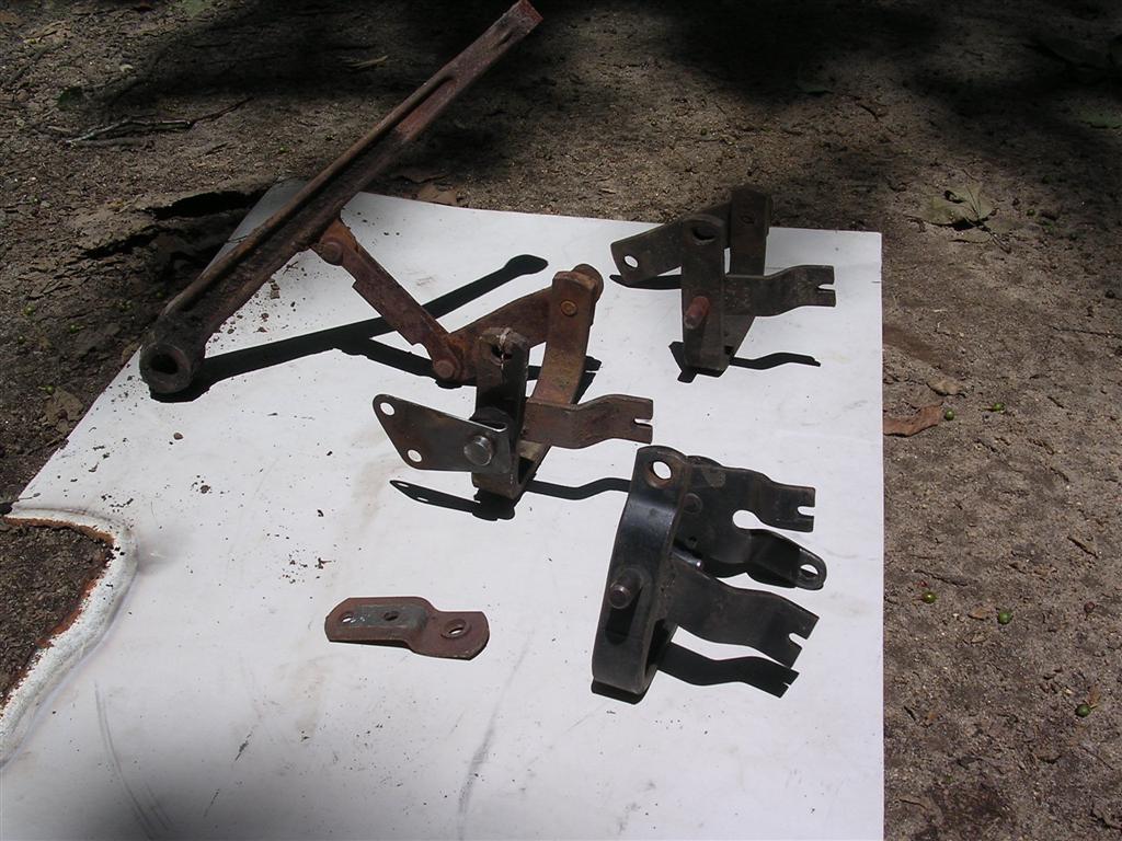

    Last summer, I chased down a C/L ad an hour from here, for a "bronze mounting bracket and a few other pieces of an Ansen/Olds selector shifter". Turns out he bought that and many other goodies new, back in the 50s and very early 60s for his Olds powered cars.

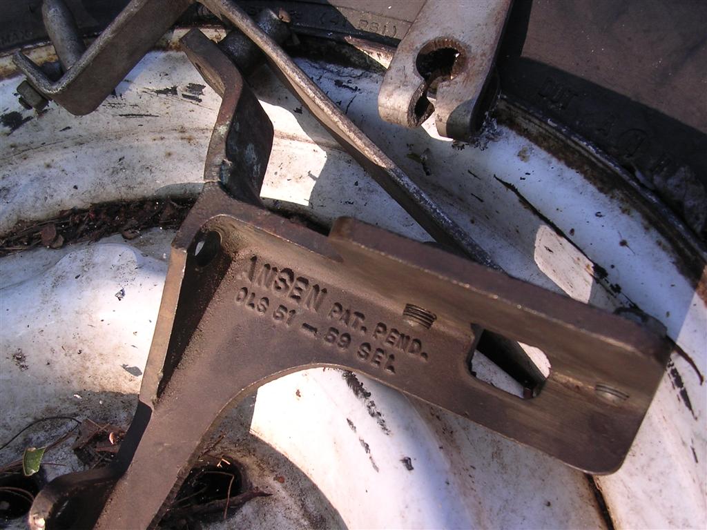

    Take a look at pic #1. The bronze cast bracket is one I have never seen before, the typical Ansen selector shifter mount is bent mild steel. This one says :OLS 51-59. I thought that proved the selector was all done after 59, until I read more on hamb then. I think this piece was cast in 1959, and that's why it says 51-59. I am now thinking the steel version is newer and did not break like this one did.
    Here are 2 pics of 50's to early 60's lower Z bars. The middle pic is showing the small brackets that bolt to the starter lower half bell. The heavy steel 3 bolt one, I think must be 1950. Note that the one in the middle(1957) and the one on the right(1960s), are thin spring steel. I think this gave more flexability as the motor moved. I do have 1950 bells, but not a 50 starter half bell; I'll bet they are the ones that have 3 tapped holes for that. All the others I have only have 2 holes and one blank spot for the 3rd.
    In the pics you can see a short, thick bracket. That is what is bolted to the ch***is, to use as the outer Z bar pivot. That one is 60s, and I would think the other years would be very similar.
    3rd pic shows the lower Z bars. The one with the pedal is all 1957. The new black one is for the 60's which I just found. The other is unknown year, and while it looks the same as the 57 one, the longest arm that goes to the pedal is welded at a slightly different angle. Most likely the older ch***is/body style, compared to the 57.
    That 1960's one has 2 forks for springs, the others do not, because those go with direct links to the underfloor pedals. When the pedal became a swing type, they must have needed the 2nd over-center spring to help push the clutch, IMO.
    You could most likely modify any one of these types for whatever year you are doing a stick swap into.

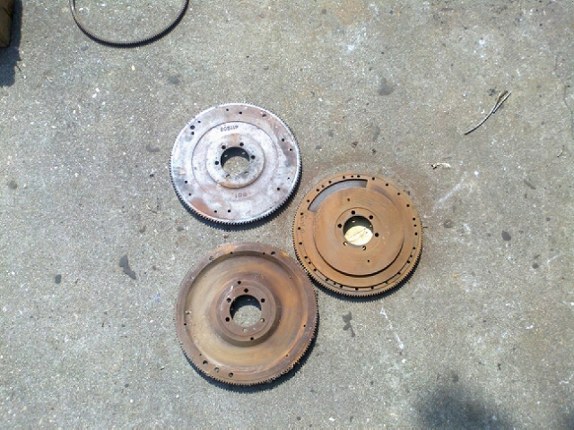

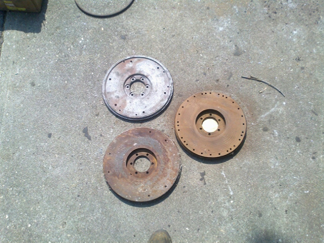

    Last 2 flywheels pics shows front and back of the 394 flywheel that Tony ID'ed for me. Note the multiple holes?? ... and the balancing divots cast into the back. It is the one on the right. The left lower is 54-56 Olds, the upper is 6cyl Olds.
    We'd like to see some pics of all the stick details :) ...and it sure might help you with your "needs" :D.

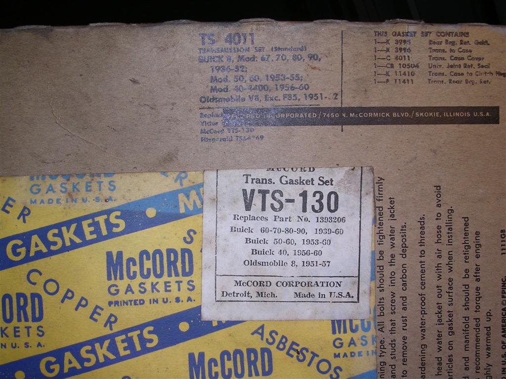

    The McCord set is very old and it's application seems a bit off, with 57 being the last year Olds that it would fit?, but does show it to fit up to 60 on Buick.
    Next is a slightly newer Felpro set with dates as high as 62, but as the company address does not have a zip code, that would mean this is older than a 1965 manufacture date.
    But that Felpro set gives the info, sort of, that Owen just stated about Buick selling off the surplus transmissions to Olds.. When? 1960...If you look at the applications on the Felpro, you can see Buick stopped after the 60 model, yet Olds continued to 62. this package may date to 62, and could be why it does not mention a 63 or even a 64 like Jacks car was.
    But it does makes sense that those 4500 surplus transmissions covered Olds' small sales demand for sticks through the 61 to 64 period?
    I have never seen a 58-or later trans, to know if anything is different from the 57 one I have, The 57 differs from the older ones, in that it has a bolt-on rear yoke to go with a new 2-pc driveshaft.
    Interesting stuff IMO, including the gasket info, that traces that transmission's history back to the 36 Buick.

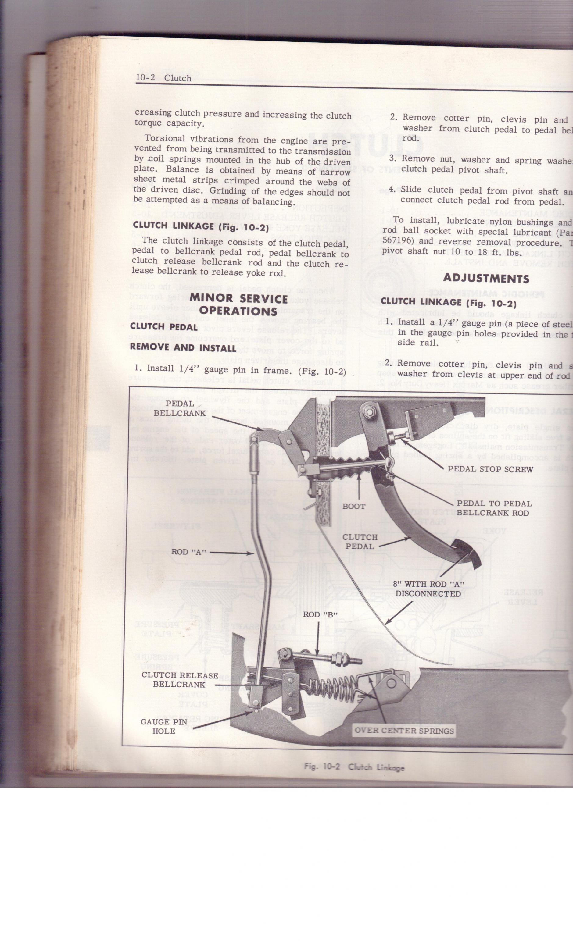

    Included is a scan of the 61 Olds service manual with the clutch pedal setup. It shows the 3 speed as the only manual transmission available . In the 63 manual it shows a 3 or 4 speed as options.
  15. F&J
    Joined: Apr 5, 2007
    Posts: 13,291
    F&J
    Thanks for the pic and also, the info on a 4 speed in 64.
    Well, I'd bet any ******** Rocket guy reading that, is wondering what bellhousing Olds used on the 4 speed, or how a 4 speed typical input shaft length could reach the pilot bushing in the 394 crank.
    Time for me to study that pic, thanks;)
    **Edit; Thanks a bunch for that scan, as I was wrong about one of the springs being a light duty. Both are listed as "overcenter" and they both were in that same box. The upper clevis that I am missing shows it is made from round stock with a simple slot. I can make that easily. Now I just need a car to put this stuff into :) Some guys like old speed parts, but these parts make me just as happy.

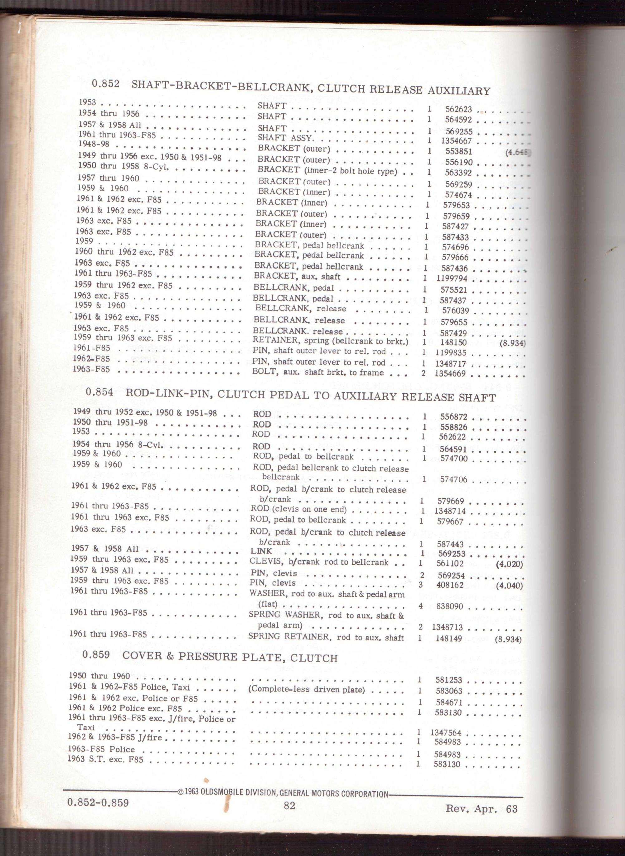

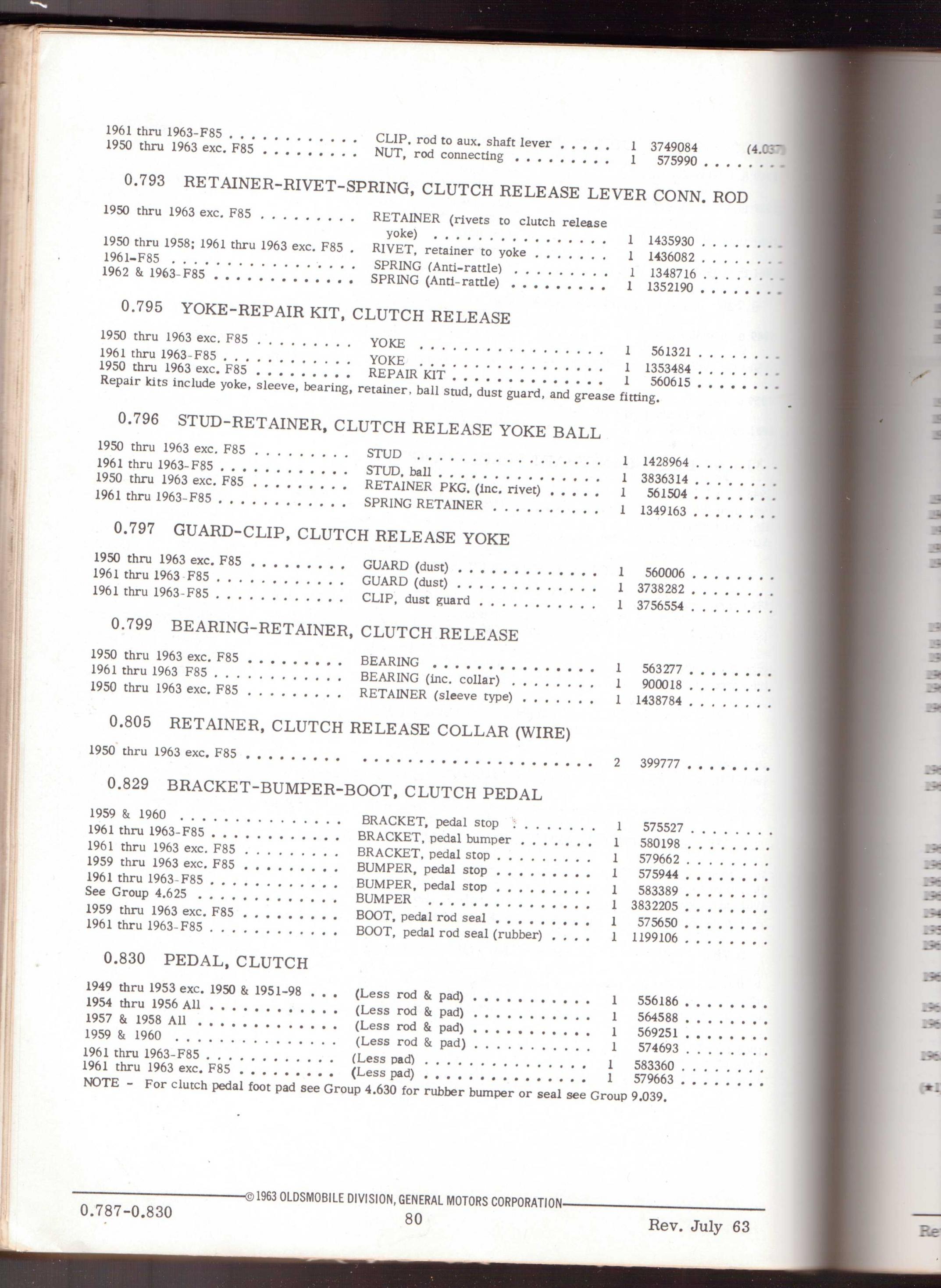

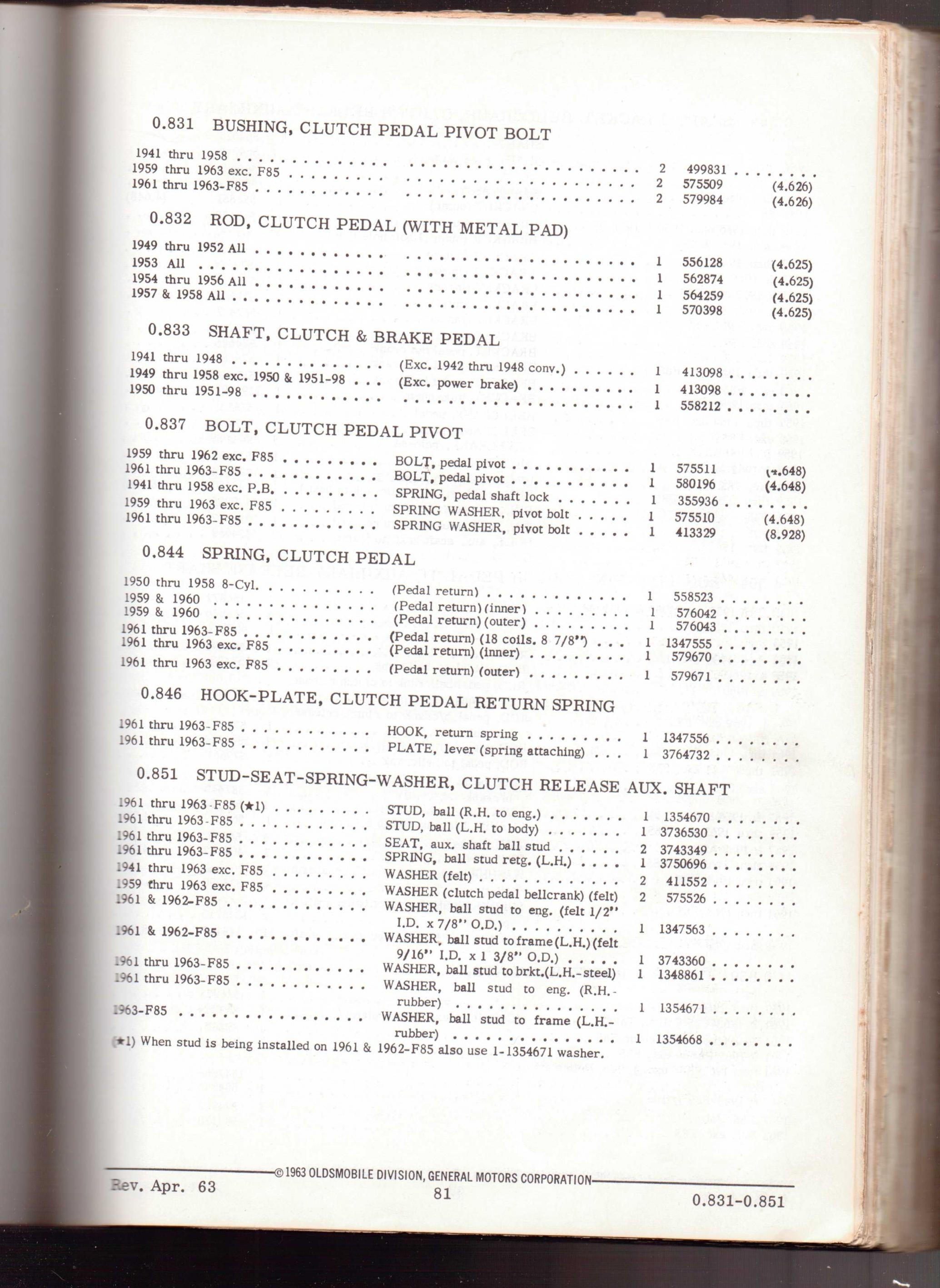

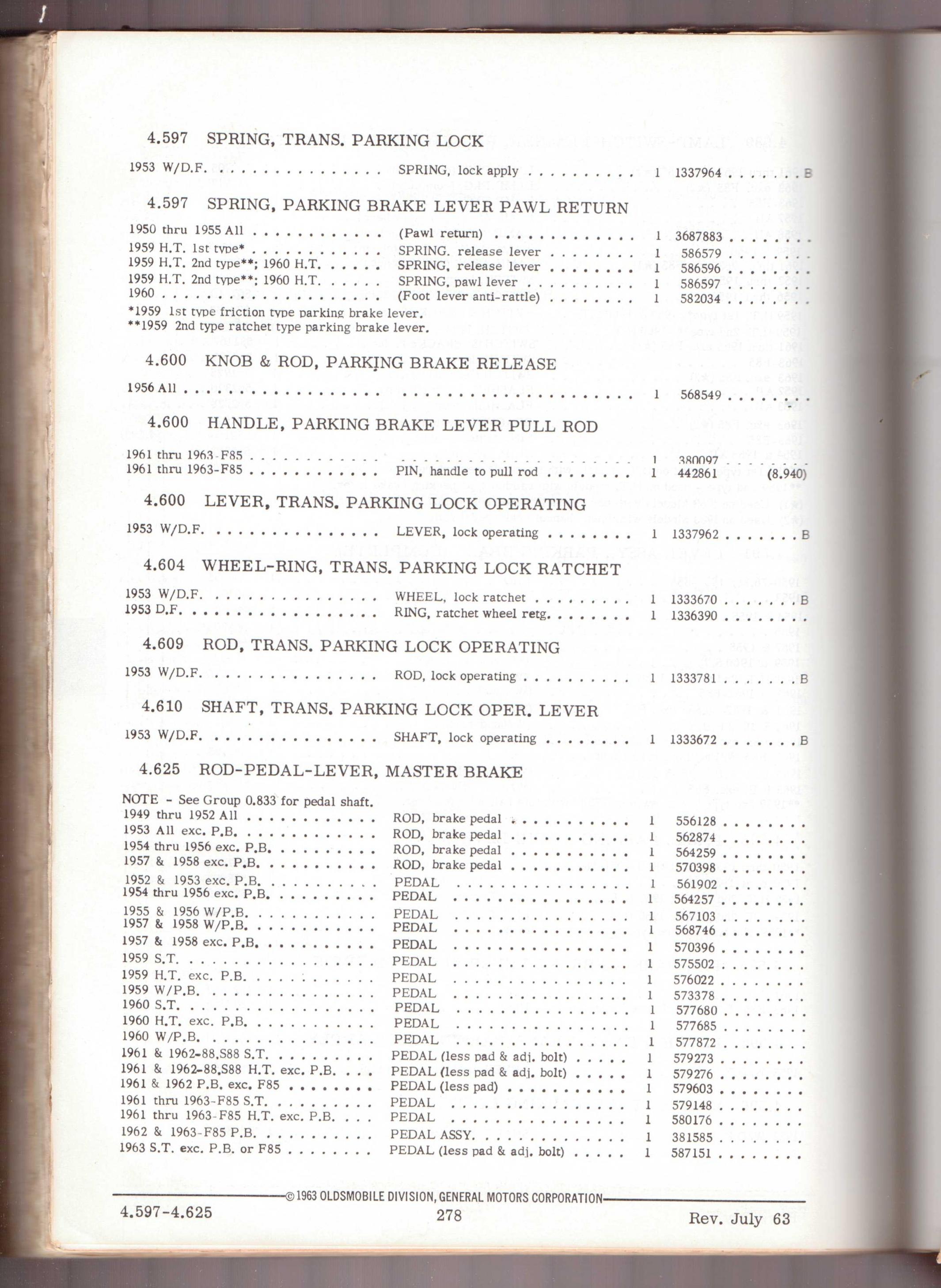

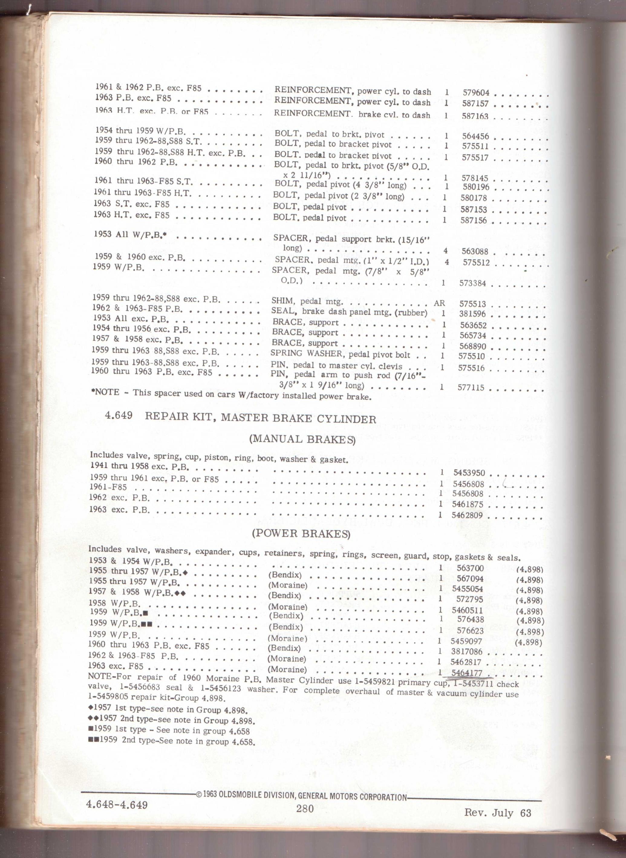

    I scanned these from my 1963 Olds parts books, hope this helps.
  18. F&J
    Joined: Apr 5, 2007
    Posts: 13,291
    F&J
    Thanks a bunch, Charlie. It has good views of the clevis and the brake pivot pin that are missing. I really needed a good pic of that pivot. I have everything else including even those felt washers.

  19. Charlie Jones
    Joined: Apr 3, 2009
    Posts: 66
    Charlie Jones
    from Apopka FL.
    Looks like you may need a brake pedal too. Or at least a lot of "re-engineering"!

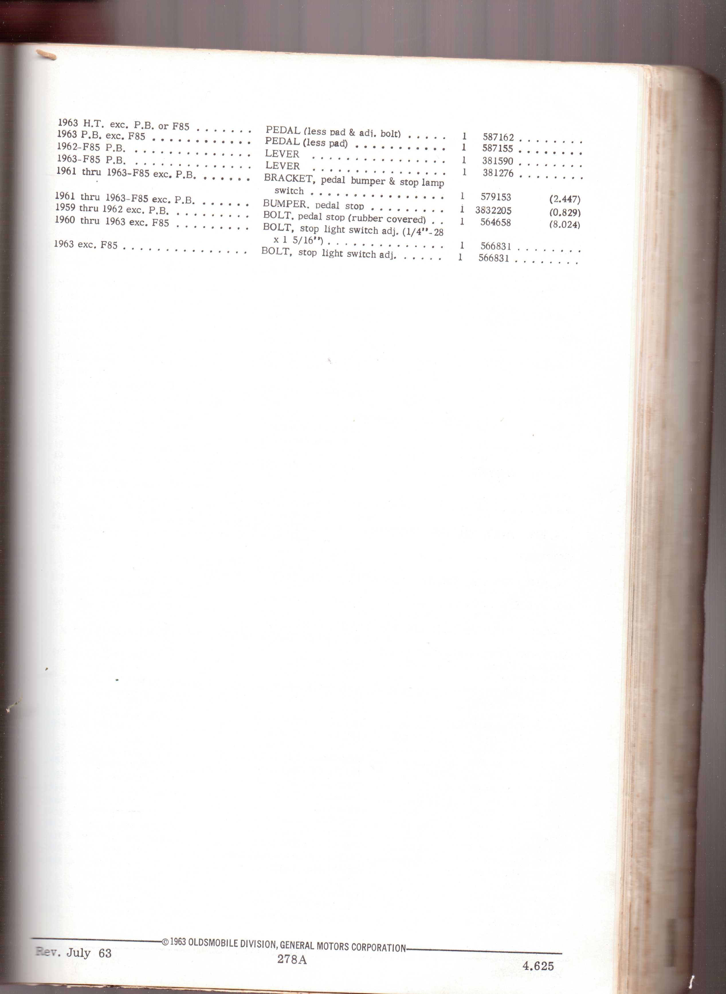

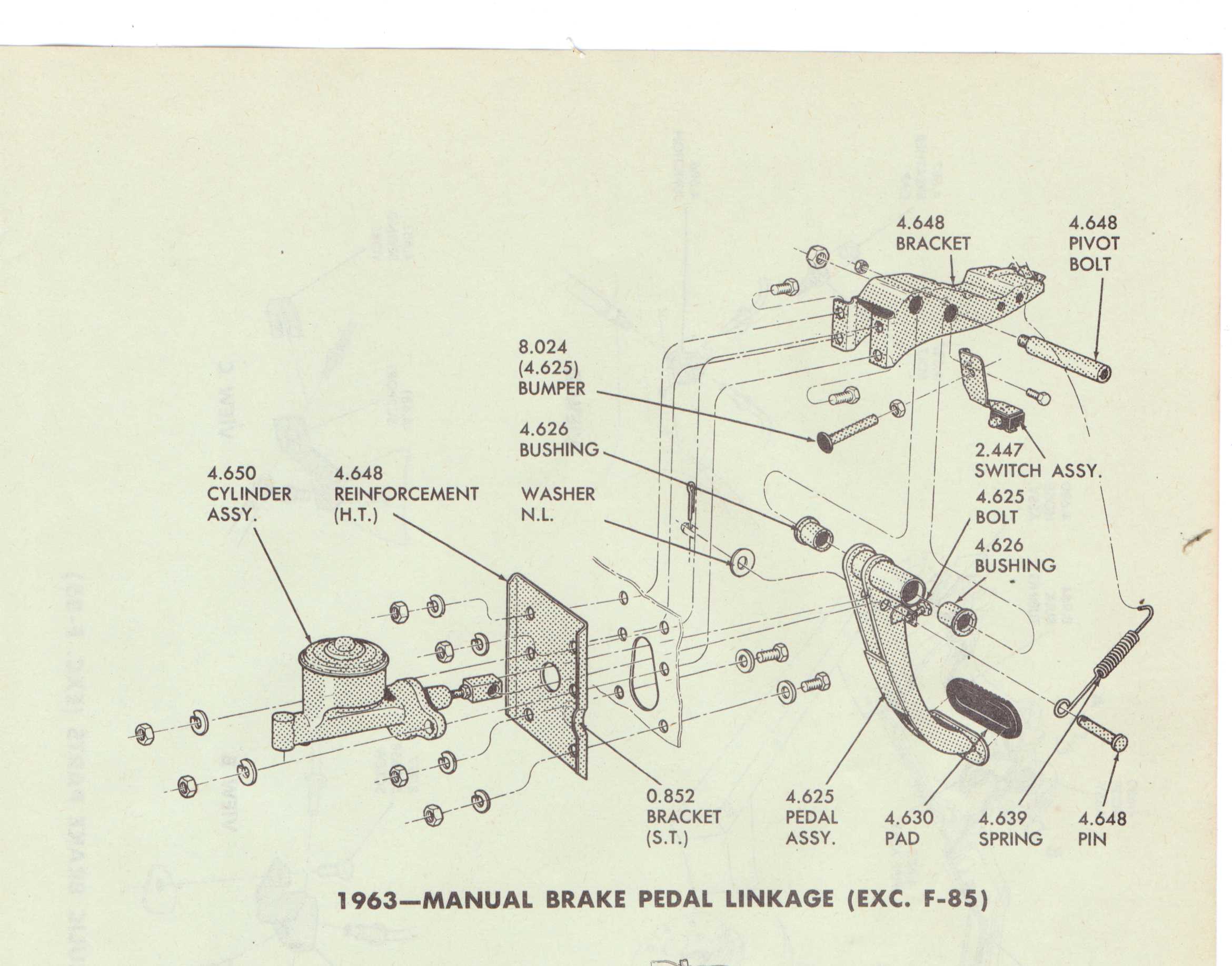

  20. Charlie Jones
    Joined: Apr 3, 2009
    Posts: 66
    Charlie Jones
    from Apopka FL.
    Here's a few scans of the brake parts too, if they help.
    I going to do a 4 speed conversion myself on my 63 Dynamic 88 two door hardtop. I'm gonna take the easy way out and use Pontiac pedals though.
    Besides, I get to keep my power brakes. The last pic is the Pontiac stuff which is available new from Fabcraft Metal Works.

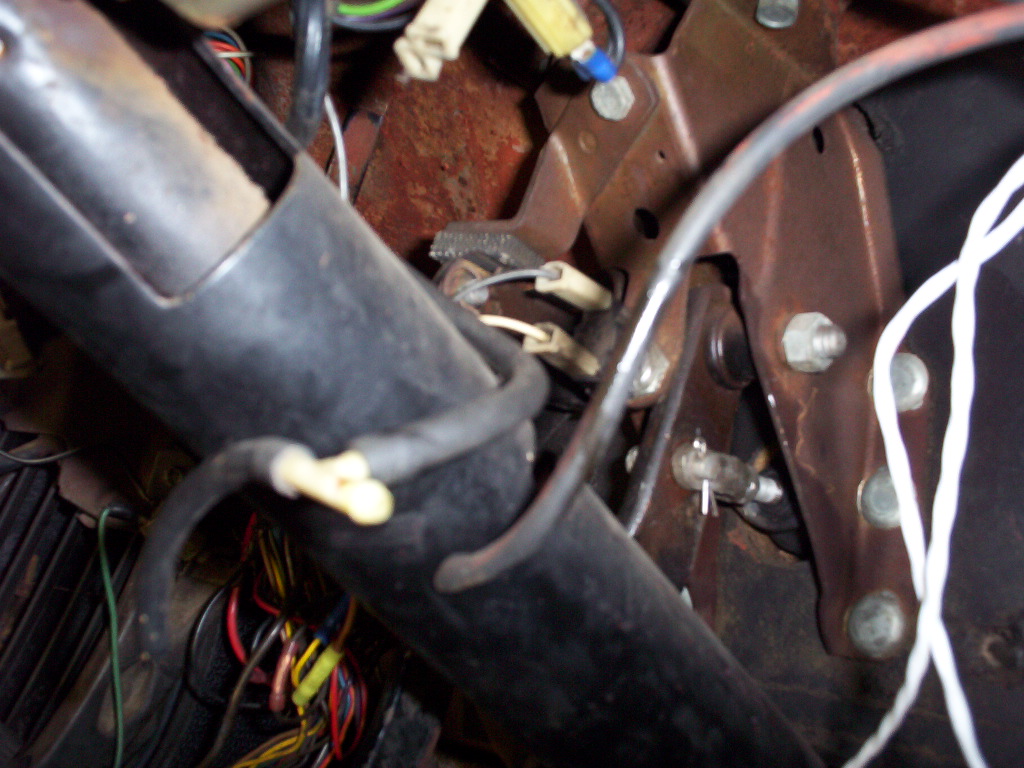

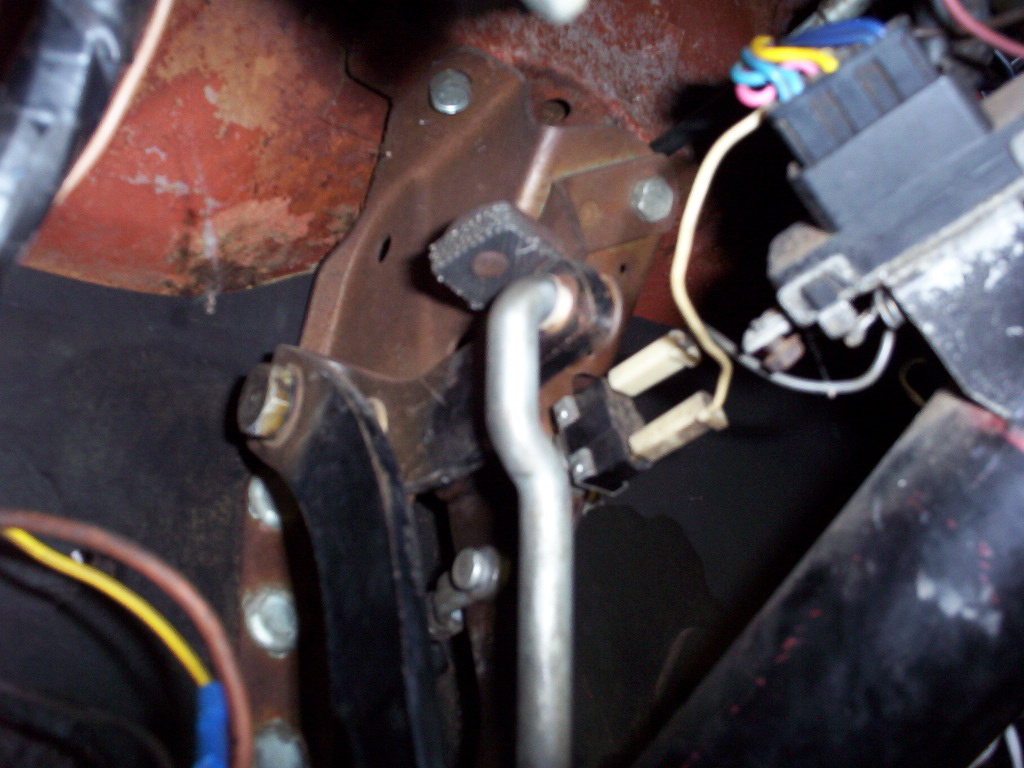

    Charlie. do you have your brake pedal to look at? I can't see the underdash pic that I put up very well, to compare with your parts scans that show the standard shift type brake pedal.
    Is the brake pedal difference in the longer pivot tube pipe, that is welded at the top of the pedal?

  25. Charlie Jones
    Joined: Apr 3, 2009
    Posts: 66
    Charlie Jones
    from Apopka FL.
    I don't have a manual brake pedal, only a parts book.
    The pivot tube pipe should be the same, as the support bracket #4.648 is the same whether stick or automatic. Maybe you could mount the clutch pedal beside the auto brake pedal?

    The NOS support bracket I found in the box of parts, is std shift only. It ties the firewall to the dash. The pic I put up of an underdash of a 61 Olds 98 A/T, shows a simple, very small A/T brake pedal bracket that only bolts to the firewall. It looks like that small one gets replaced by the long one I have,
    I'll get the A/T brake pedal to work, if I get a car to try it on.

    My bad! I didn't look at the parts listings. Olds designed 3 different brake pedals every two years for these cars. Stick, auto without P/B, and auto with P/B.
    It seems incredible that Olds and Pontiac would each design different clutch linkages. When the percentage of production was so low(4% maybe?)and they use the same basic body.:confused:
    I guess diversity in engineering really was the word back then!
