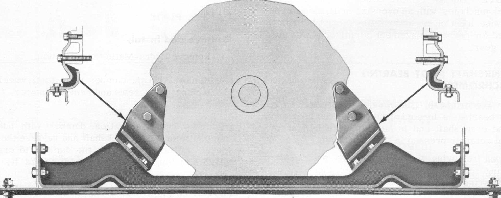

    Here's another curve ball! I copied these two pics out of my 63 Olds shop manual.
    They show two completely different rear engine mountings! stick or auto.
    this wouldn't be a problem with 4 spd conversions, but, would be a big PITA for anyone using the original 3 spd bellhousing!
    The one on the left is Hydra-Matic, right is stick.
    Even the 2nd crossmember is different for a stick.
