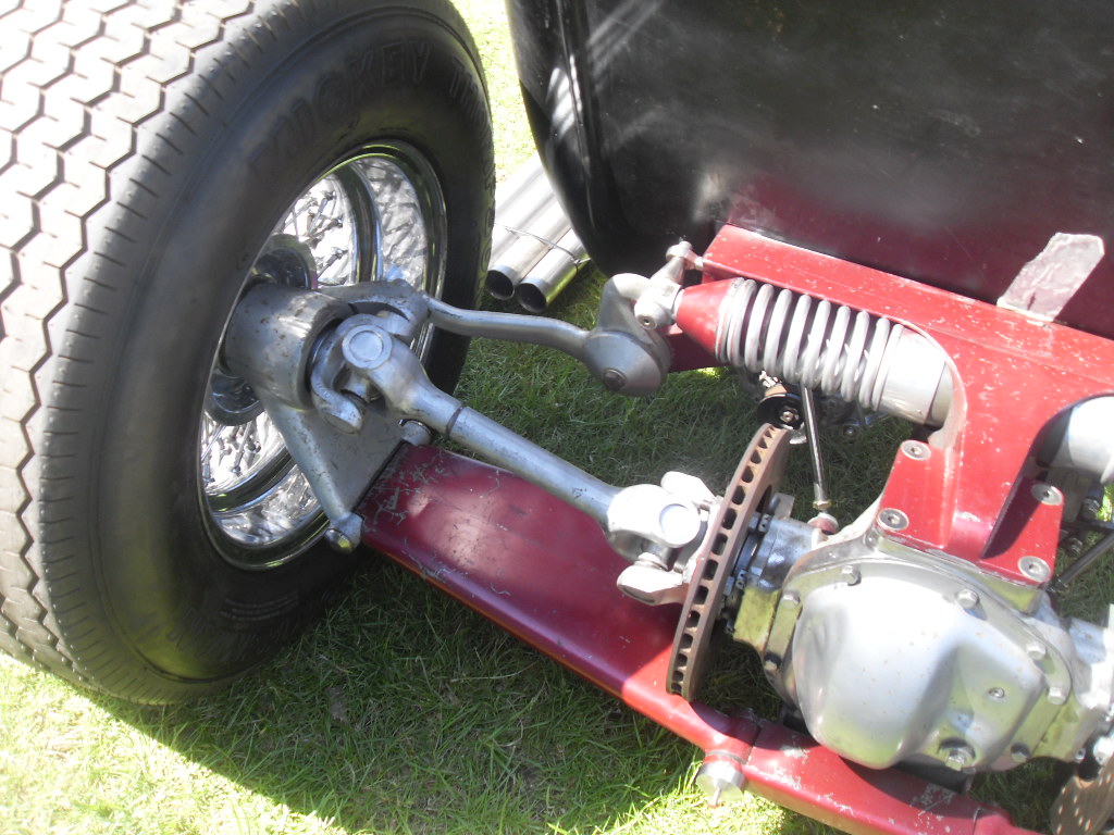

    I absolutely love the transverse mounted bell crank actuated coils, and the push rod bell crank shocks in the back.
    Excellent use of space, and a very sniggly design IMO.
    One question: Where are the front dampers? Are they inside the front coils, or hidden inboard of the frame rails similar to the rear? Or are they just not mounted yet?
    I'm also diggin' the rack & pinion in place of a worm and sector steering box, but performing the exact same function with very nearly the exact same motion.
    That is using a part in a manner other than prescribed by the manufacturer, to the betterment of the project. Such action is right in my wheelhouse, and I applaud it. :D

    Front dampers are built in to the front bell cranks. 2 friction disks, one in front and one behind the round section of the cranks where it pivots on the ch***is.

    Ahhh, friction shocks, gotcha.
    That mounting scheme is perfect for a coil over damper ***embly though.
    All you'd need is a double shear bracket inside the frame side spring seat, and another inside the bell crank spring seat to mount a short damper with heim ends.

    Been down that road. Might even end up doing just that. One problem though. Finding a damper small enough to fit. It has to be a 1'' diam.
    The ONLY place I can find them is an industrial damper company and they want a fortune.
    Steering dampers are not designed for this type of use. Also looked at gas rams... they are designed for max 6 strokes a min so no good.
    I spent a lot of time researching that idea and put it on hold for a while. I will see how the t rides with the frictions and go from there.

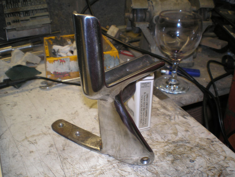

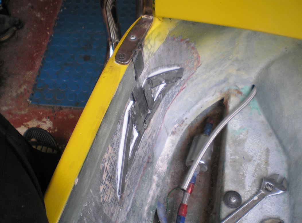

    The srceen brackets are not as simple as they look.
    Its held in with a bolt thro the bracket and cowl, plus one up from inside the cowl thro the bracket and in to the frame, plus there is another section which is screwed to the top of the body, (pheww) plus the drop down to the one captivated inside the body. See pic
    Frame inside is yet to be gl***ed in. I m hoping this should keep it upright... we'll see

    The thing I would worry about industrial dampers is the blow-off curve (or lack thereof).
    Most industrial dampers will have linear pistons and valves in them, meaning that as piston speed increases, so does the resistance they offer.
    This is good when decelerating a huge machine part from X inches per minute to a dead stop, but it's not so great for maintaining tire contact with the road surface.
    In most cases, linear dampers on a car will be far too stiff over large bumps, and cause the car to vault off them, losing contact with the road momentarily.
    Most road car dampers have highly digressive pistons and valves, which allows them to have very stiff low speed reactions to help control body roll, but very soft high speed reactions to allow the suspension to conform to the bumps in the road.
    The only saving grace you have in that front end is the very high motion ratio you've got built into the bell crank ***emblies. With that kind of motion ratio (looks close to 2:1 wheel:spring), you'll need a very stiff damper to have any hope of controlling the wheel.
    That's the one tricky thing that you absolutely have to watch when using push rod operated remote suspension, is that you keep track of the motion ratio when deciding on how you damp that end of the car.
    A ratio closer to 1:1 would have been a lot better for wheel control. In fact, some formula cars actually go the other way with ratios approaching 1:1.5, because they have so little suspension movement to start with. The extra travel gives the damper a mechanical advantage on the wheel, which greatly helps them control the movement of said wheel.
    If it were mine, I'd try a set of whatever will fit first, but be aware that those industrial dampers may be quite harsh over rough spots if you tune them to control body roll properly. Conversely, if you tune them to ride good over the rough stuff, they will not be able to control body roll at all, and the car will feel like a land yacht (and not the cool "go fast across the salt" kind either).
