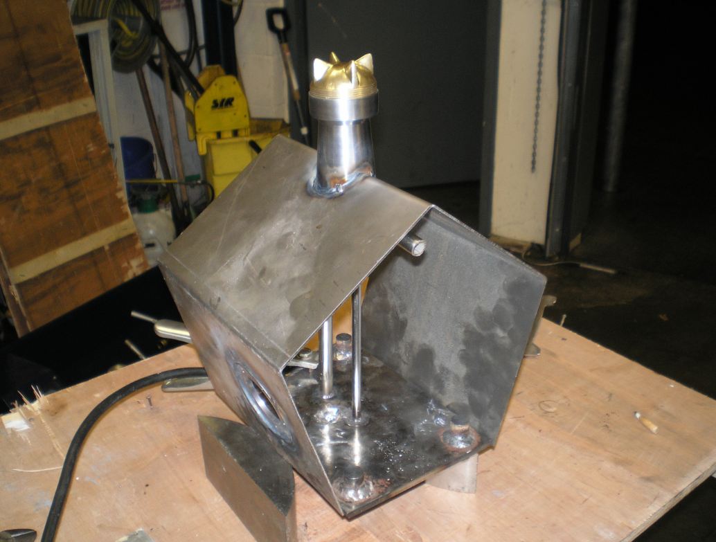

    Still working on the fuel tank Here a pic of the parts mocked up
    Gerry

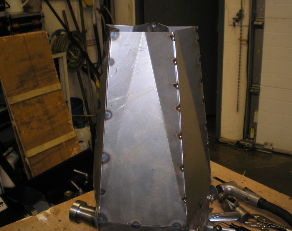

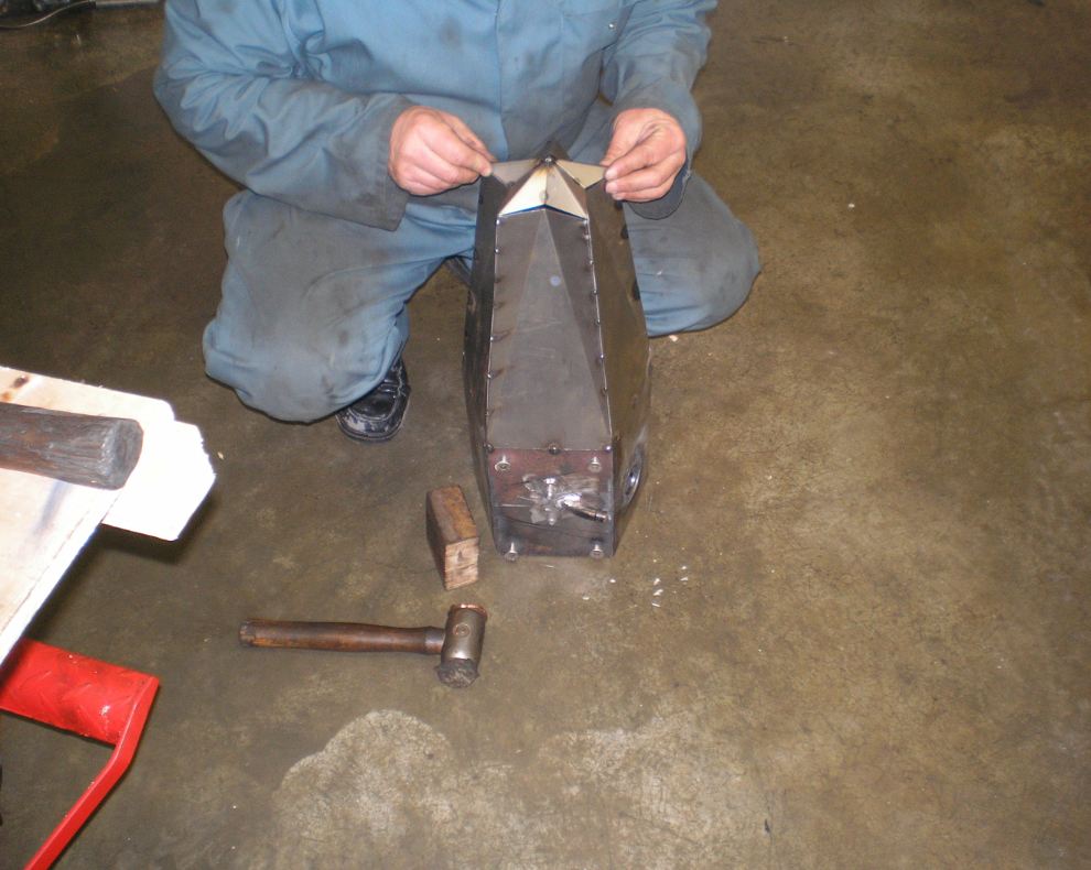

    A few of you asked about the fuel tank so heres the latest pics of it in the making. Only tacked up one side so far and that took over 4 hours. Hope to have if completed (tacked state) soon then on to welding and powder coating in polished br***

    Tank is looking good Gerry

    looking good,thanks for the update

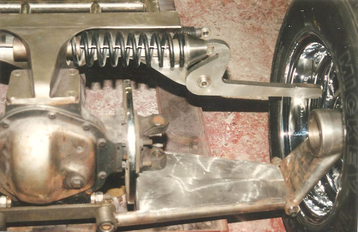

    there is a wealth of information in this posting. there are some fantastic pictures reguarding the opposing coil spring suspension.

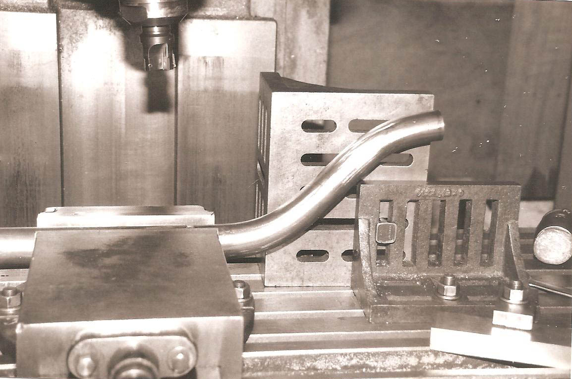

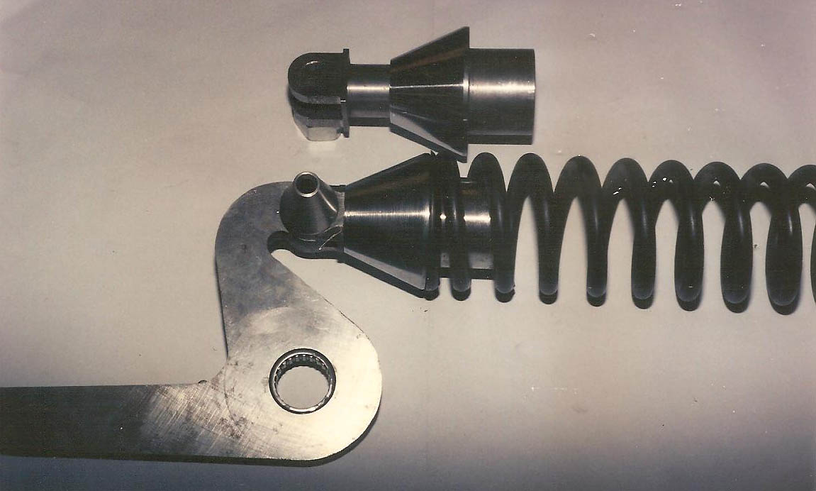

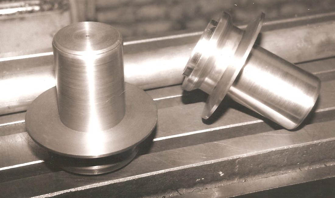

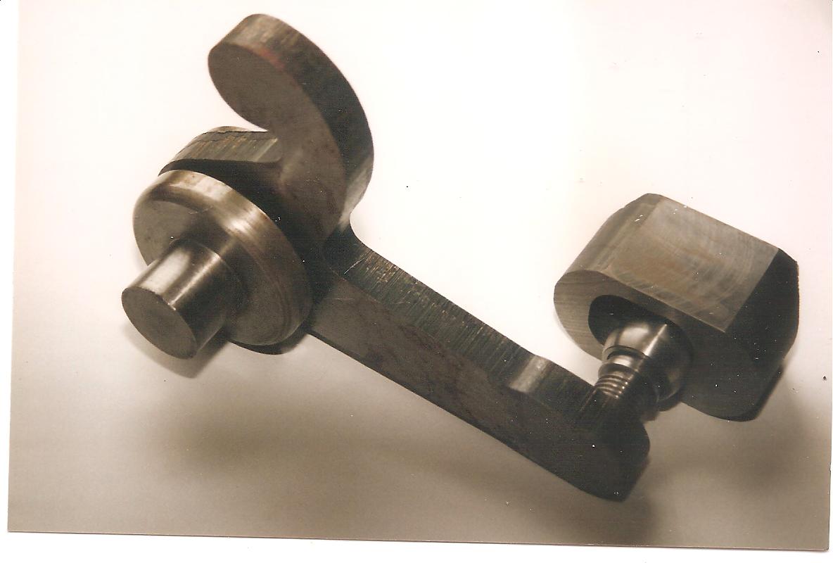

    Not an update but here's a few shots of Gerry's T during the buildup in my shop. Almost every part was handmade by me from my own drawings - old style, pen & ink of course.
    What a lot of people don't realise is: To build something as different as this, completely from scratch from a blank sheet of paper & in England, is not an easy task at all. It's a world away from buying a kit or parts which are already in production, I make it all by hand from scratch.
    I have to think first of how the vehicle is to look overall when finished, so I do sketches and scale drawings based on my previous experience & knowledge building T buckets....needs to be a little lower here, longer there, drop the radiator, widen the front track, deeper drop front axle, and so on....
    I then look at the basic suspension layout I have in mind and figure what I want to do with that aesthetically, rough ideas which may or may not work in practice - usually I attempt to make the design (the finished "look"), as simple visually as possible (nothing worse than too many conflicting parts on a T bucket, specially at the front), so the idea is to make one part perform two functions wherever possible, also to hide fastenings. Making it look simple / minimal while maintaining functionality in itself makes the whole build process more complicated for obvious reasons. I'll then do some full size working drawings where necessary.
    Once the engineering principles (making it work in theory), are established I then apply the art to the intended pieces I want to make, i.e. how to make everything flow, for want of a better word, together. This takes a lot of extra work, machining, milling, forming, grinding, filing often heavy steel into a shape which looks lightweight and designed to visually as well as physically fit the piece it's attached to.
    Anyhow, here's a few build photo's of Gerry's T bucket for now. I have more but haven't scanned them.
    Ed Wimble

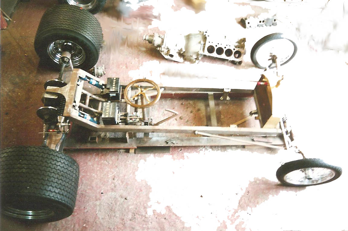

  22. EE-1
    Joined: Oct 3, 2009
    Posts: 34
    EE-1
    from London
    Here's a couple more.... Ed

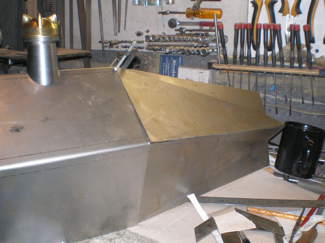

    And the finished tank

    You absolutely KILLED it with the tank! Almost a shame to see it powder coated. Not so sure about the wood blocks though.. Haha

    Holy hell on that tank....and I thought I was good at geometry, Sir Pythagoras! Wow.
