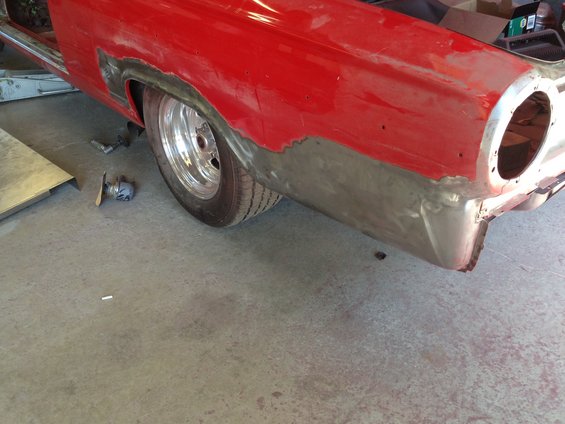

    The guys were doing a bit of bodywork on the rear quarters when they found some issues
