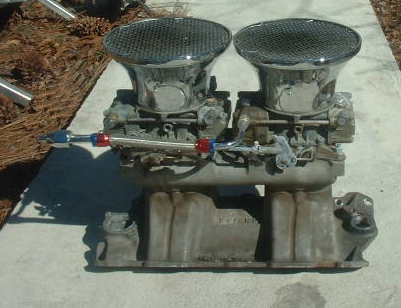

    Here is a shot of the setup in my Dart. I know it is a hotter engine that you are going to run, but thought I would share it anyway.

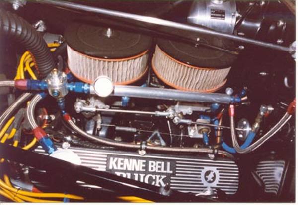

    I've run a dual carb-setup with two 625cfm Carter's with a direct linkage. Progressive linkages are for wimps :D (note the hi-tech linkage) My setup ran like a champ.
    The (new) Carter/Edelbrocks have a weighted secondary airvalve which will only open with airflow is sufficient, so overcarbing is not easliy done.
    Here are the 2 Carter's straight out of the box onto the engine. Only thing needed was an idle-settting adjustment on both carbs.
