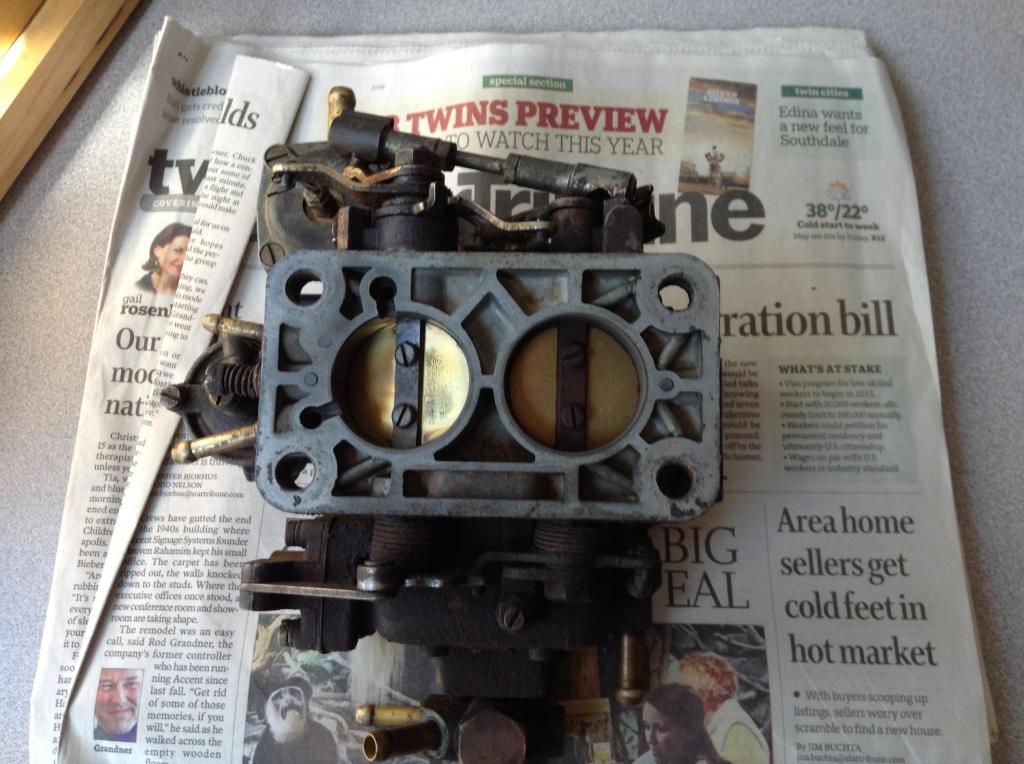

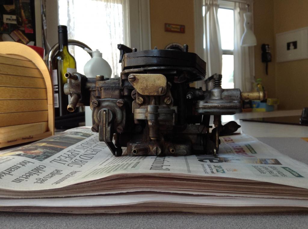

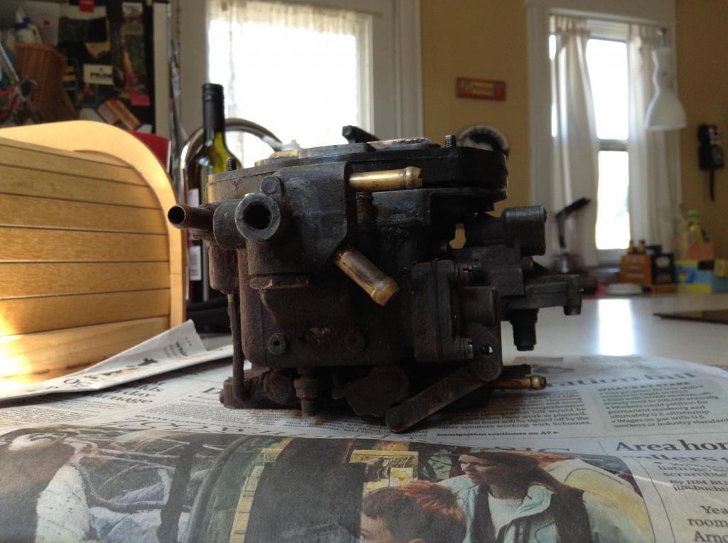

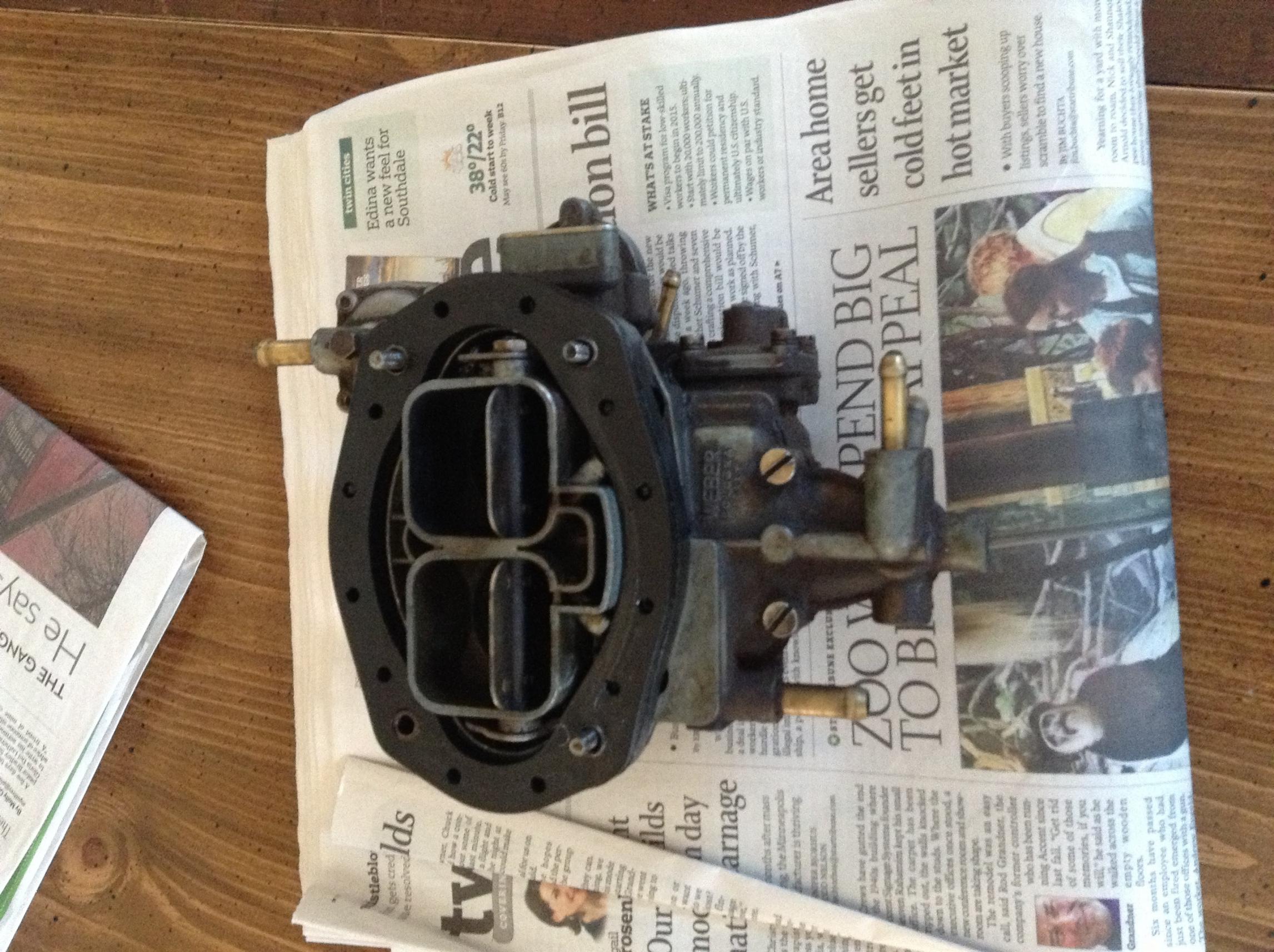

    I just happen to have a weber 34 dmsa from an old fiat in the ba*****t, is that comparable?
  28. need louvers ?
    Joined: Nov 20, 2008
    Posts: 12,901
    need louvers ?
    DMSA is one I'm not familar with, but the venturi size is just about right on. How about a picture from a couple differnt angles like the say the base plate and side so I can see how it's configured?
  29. oakmckinley
    Joined: Jan 21, 2012
    Posts: 241
    oakmckinley
    Here are some more.
    Thanks for looking at them.
  30. need louvers ?
    Posts: 12,901
    need louvers ?
    I don't see any reason why that won't work! Get the adaptor from Cl***ic Inlines, their is the best I've found. You are on your aown as far as jetting, but you might check out my post from earlier in this tread for an idea of where to go jetting.
