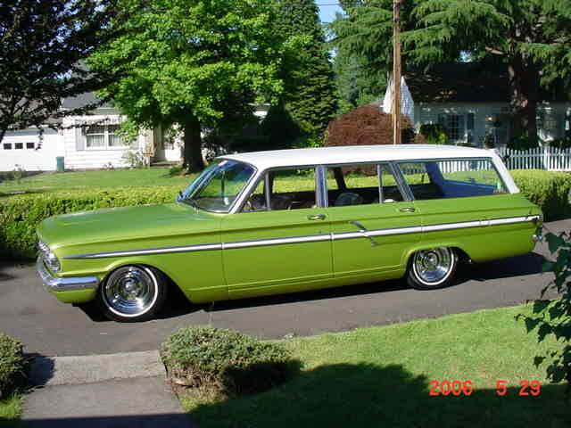

    We bagged my 64' Fairlane wagon about 11 years ago and have never had any problems with it. In the front we bolted the bag to the upper control arm, used a piece up pipe bolted to the top of the airbag, and bolted the pipe up in the shock tower to the original mounts. Pretty easy really. We relocated the shocks by using a shock with a post on each end and making brakets off of the lower contol arm and the shock tower. Hard to visualize, I am sure, but it works great. I get about 8 inches of travel. I am running stock leafs in the back with a couple removed. We built a crossmember under the rear floor and bolted the bags to the crossmember. The shocks stayed in the stock location on the back. We did have to raise the driveline tunnel a bit for clearance. In the pic, the car is not down, but will lay on the ground.
