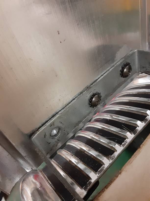

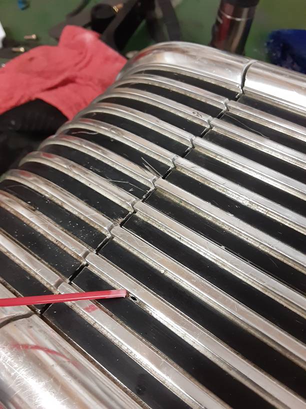

    Posts: 534
    ZZ Top Chop
    So I got this console from FeeBay today. If u don't already know, these are uber expensive in even bad condition. Even though I thought this was in better shape I think I can work with it still. The problem with these doors are they always break off from the hinge. Not a very good design. IDK how it was originally attached. But someone tried to tap the aluminum and it just is not going to hold. There are tiny holes coming thru the top. Alot of these have been repaired by just drilling holes through the door and using bolts. I would rather not go that route. Since this is aluminum I think I need to take it to a pro. welder. So I need some advice, do I get this welded and if so do they need to weld bolts (minus the head) to the door and spot weld the tiny holes on the top? Or should I just go the bolts route through the top? Due to the ribs, I would have to counter sink the top so the bolts are flush. Thinking about using hex bolts. 20200222_170519.jpeg 20200222_170338.jpeg 20200222_170355.jpeg

  2. tb33anda3rd
    Joined: Oct 8, 2010
    Posts: 17,595
    tb33anda3rd
    can you redrill the holes in the hinge and machine the threads into the fresh metal?
  3. loveoftiki
    Joined: Nov 11, 2006
    Posts: 9,197
    loveoftiki
    from Livonia,Mi
    If ya want some 3M 8115 panel bonding adhesive would stick that back together..maybe take it to a local body shop and see if ya slap em a little $$ they’ll glue it together for ya..no worries about welding...and it will hold with no issues

  4. ZZ Top Chop
    Joined: Aug 12, 2018
    Posts: 534
    ZZ Top Chop
    I think I'll end up have the same issue, there's just not enough metal there

  5. ZZ Top Chop
    Posts: 534
    ZZ Top Chop
    That sounds like a good idea. The far left threads no longer hold, so would this hold without screws? Also they would have to get it just right as I would not be able to adjust

  6. loveoftiki
    Posts: 9,197
    loveoftiki
    from Livonia,Mi
    Use the glue and what ever screws ya got to hold it in place..get it set and don’t touch it for a day

  8. BamaMav
    Joined: Jun 19, 2011
    Posts: 6,968
    BamaMav
    from Berry, AL
    If you decide to use bolts all the way through, I'd get stainless carriage head bolts. The smooth heads would look much better than hex heads.

  9. 41rodderz
    Joined: Sep 27, 2010
    Posts: 6,541
    41rodderz
    from Oregon
    I have two of those consoles on the shelf . One great at hinge and the other is not. I am planning on just epoxy it .

  11. BJR
    Joined: Mar 11, 2005
    Posts: 12,064
    BJR
    Why not just panel bond the hinge to the console without any screws. After all it holds new cars together without fasteners.

  13. BJR
    Posts: 12,064
    BJR
    That's what clamps are for.
