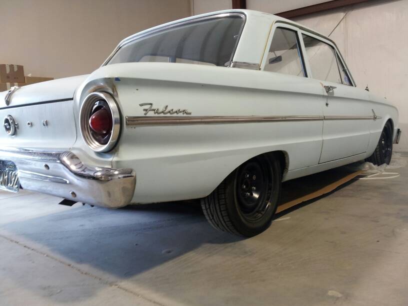

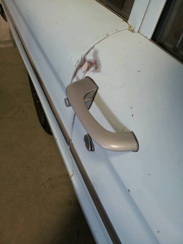

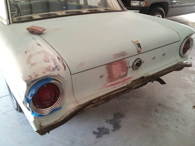

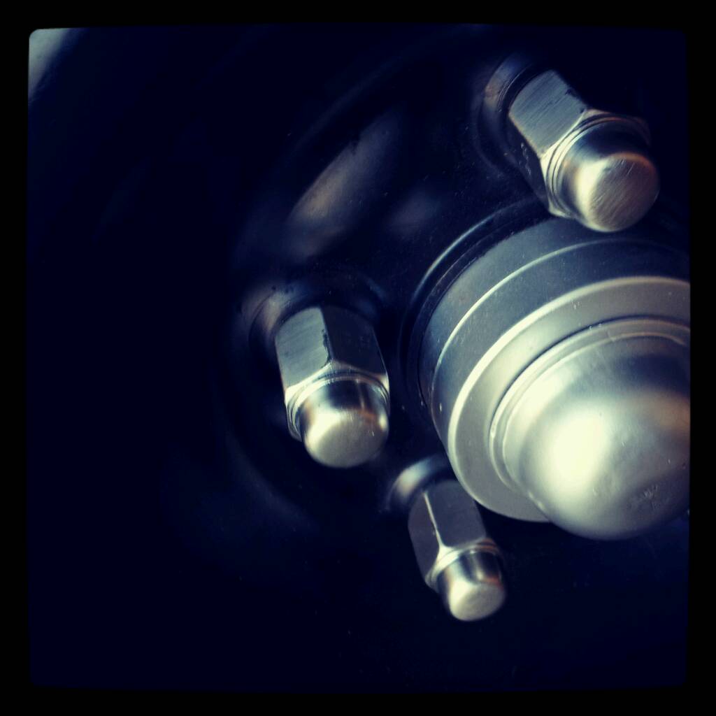

    Getting ready for paint as soon as my motor and trans arrives...playing with a few ideas for the wheels, brushed lugs and silver center. Also working a few options on the handles and trim...going for an aluminum look which will also be done on the bumpers.

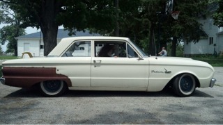

    Got to take my brothers 63 for a spin on Sunday. My wagon is still on jack stands and going to be there for awhile. ImageUploadedByH.A.M.B.1403065966.077977.jpg

    Great ride height. Looks good!

    I love the way your brothers car sits. Can I please get some specs on suspension?

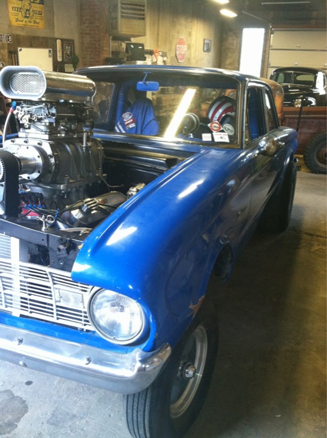

    I posted my '60 a few years back, but its been updated since oiling down mokan at the HAMB drags in '12.. It's now sporting a dart iron eagle 331" with iron trick flow high ports, solid roller, shaft rockers and a GMC 6-71.. Still has the toploader.. Put down 794 at the wheel and weighs 2330#. ImageUploadedByH.A.M.B.1404414832.493446.jpg ImageUploadedByH.A.M.B.1404414848.598948.jpg ImageUploadedByH.A.M.B.1404414863.516996.jpg ImageUploadedByH.A.M.B.1404414877.841702.jpg ImageUploadedByH.A.M.B.1404414895.480093.jpg

    that thing is a monster ! love it
  12. Inland empire hot rods
    Joined: Aug 5, 2010
    Posts: 1,072
    from so cal
    Love that blown falcon!

    Instead of cutting 50 year old coils he bought 3" drop coils from Dearborn did the Shelby drop, running 5.60-13 tires all around, and 3" blocks in rear with 3rd leaf removed in a 5 pack leaf. Cut down the bump stops and air shocks in the rear. Rockers are about 5 1/2" off the ground.

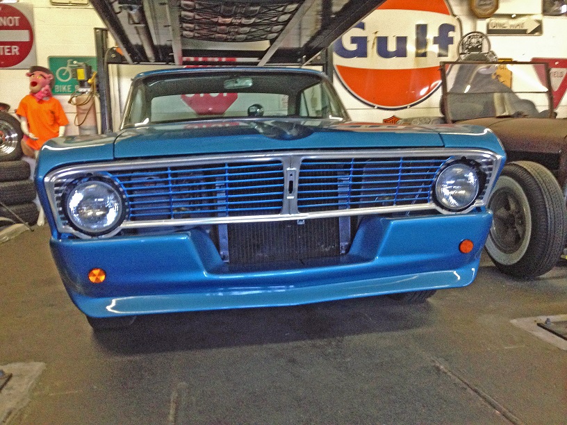

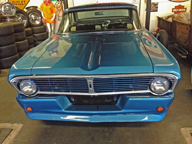

    I dig the "R" apron.
    I always have wondered why the bottom third of the radiator was covered by the bumper on Falcons...

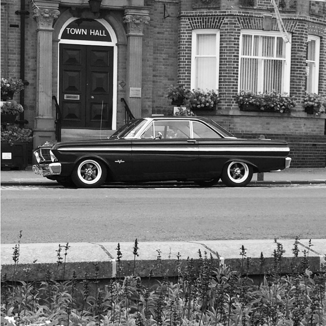

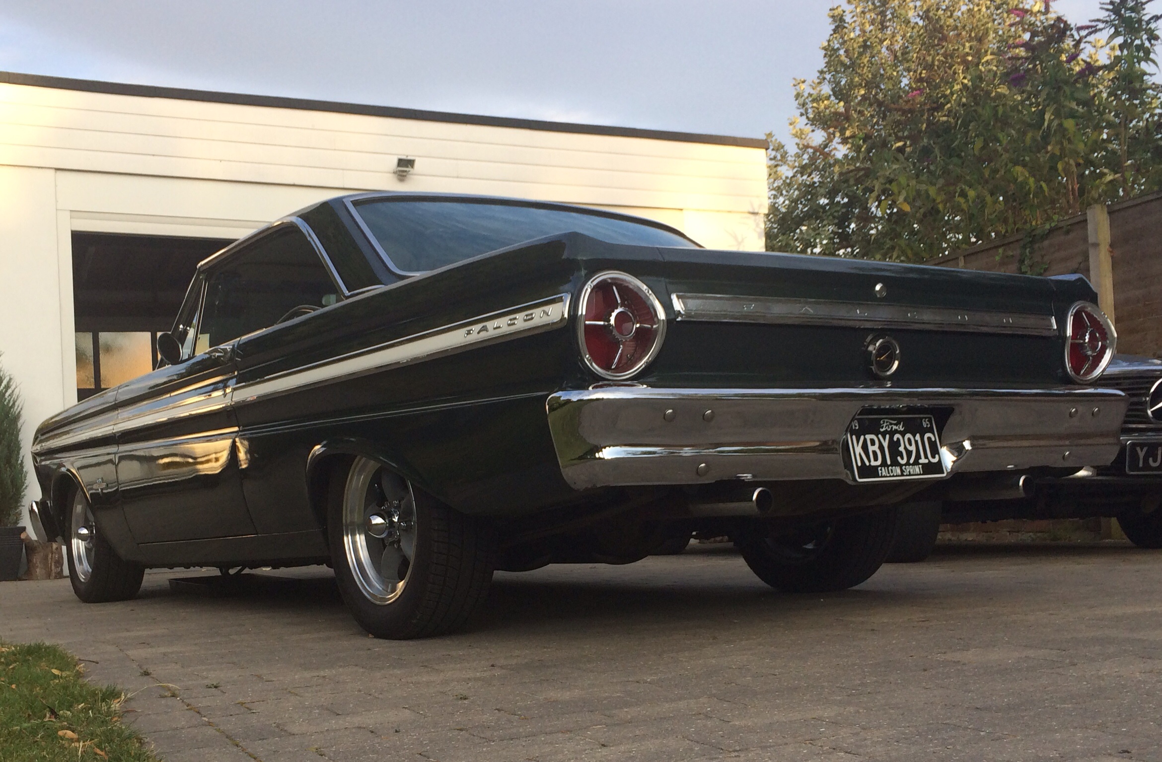

    Here's my 65 sprint

    Damn Ian, that is nice! Wheel and tire sizes please?

    They are 15x7" American racing with 205/70 tyres
    Whilst it looks great, it is a little too low at the front, power steering hoses very close to the ground and it bottoms the suspension over pot holes(we have plenty here!) I intend to get another pair of gt springs and cut a little less than last time
