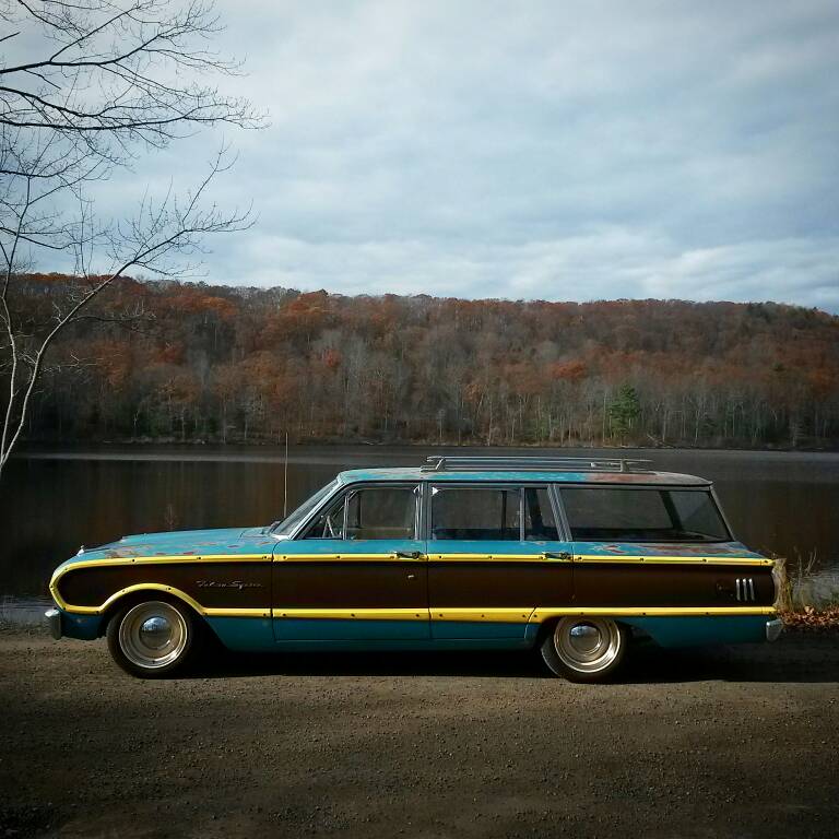

    Crusin the wagon on these last few nice fall days

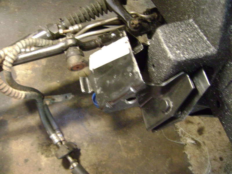

    Here's a shot the later V-8 mounts, well the R/H one anyway, that were originally in my 63.
    These will work, kinda' sorta', but please note that they only have two bolts going through the lower mount into the shock towers. The earlier cast lower mounts use three.
    I ditched this set up because I couldn't use the "under engine" brace with them.
