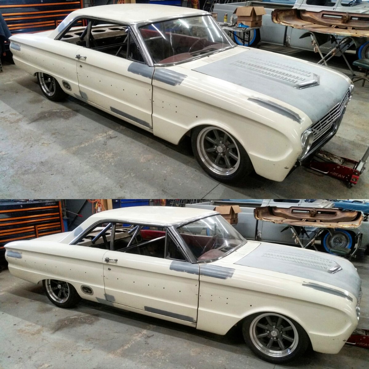

    You've made a lot of changes to the white Hardtop, Evil......I'd like to hear more about it.

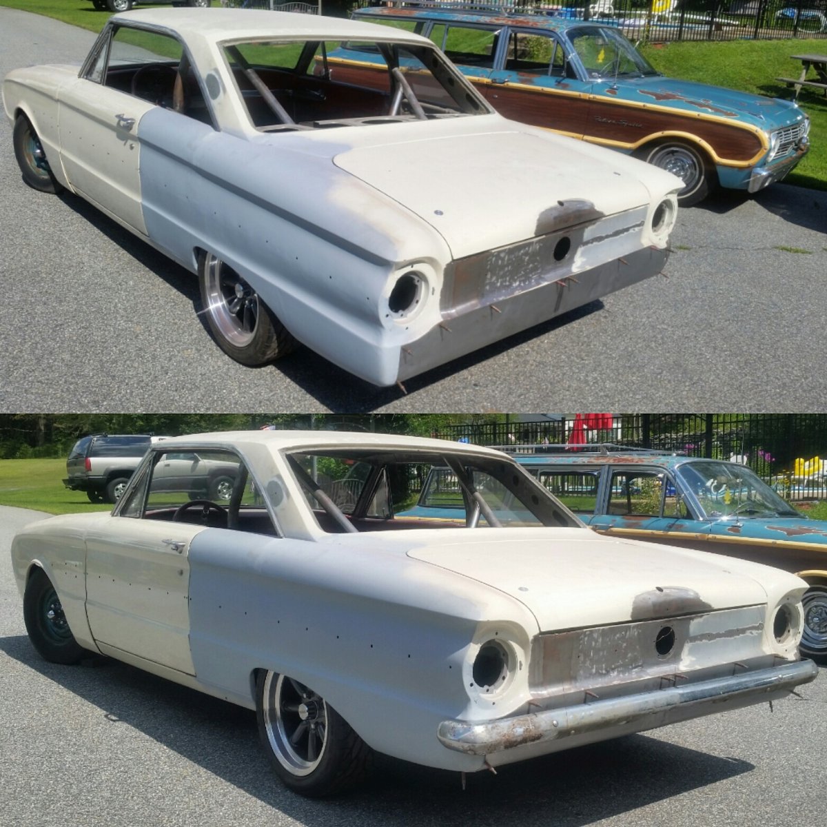

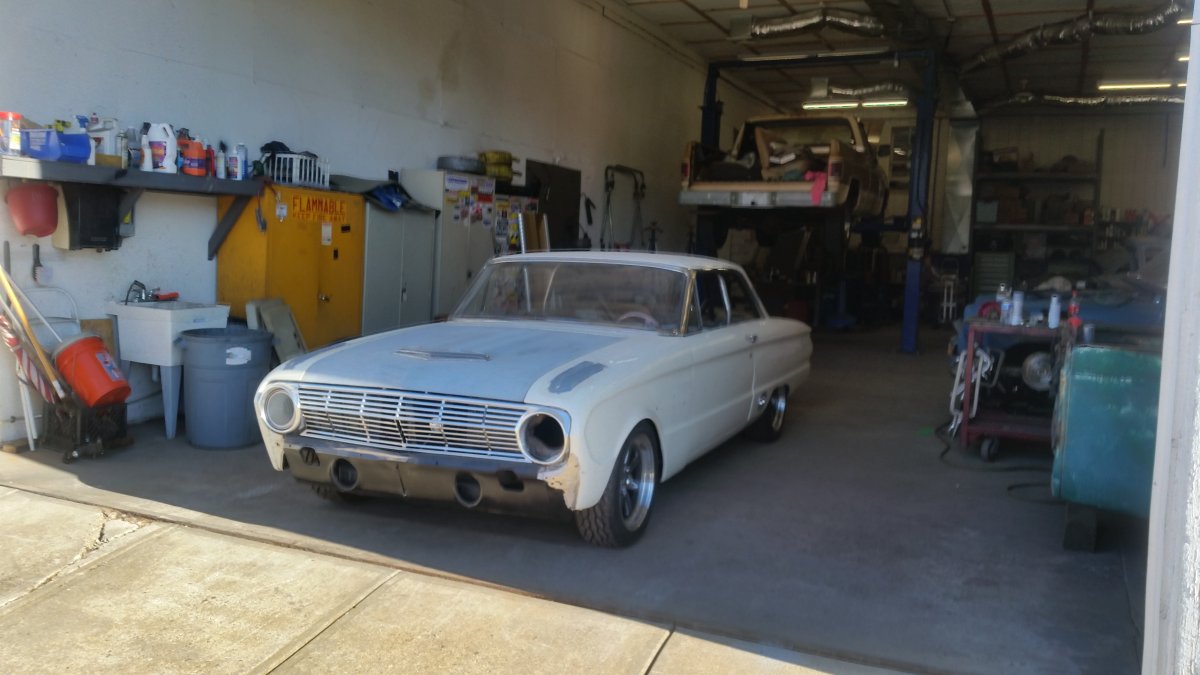

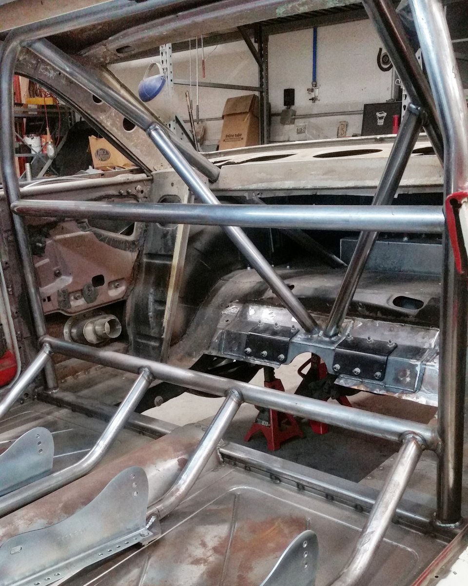

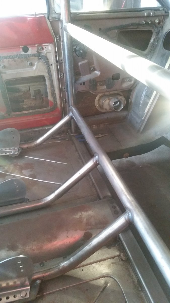

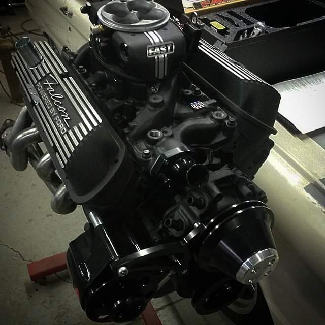

    The roll cage is from Rhodes race cars, did single hoop with down bars then had two more come off the rear downbars to the center of where the 4 link bolts in and plated the floor, so the force goes thru the cage.
    Originally a 6 cylinder car now has a 302 with efi and a 4 speed toploader, tci 4 link in the rear with a maverick 8" 4 LUG with wilwood disc brakes. Front is a cpp mini sub frame kit and control freak upper arms. Rci 17 gal fuel cell and pro werks gas cap will be grafted back into where the stock filler would have been.
    all seat brackets are tied into the cage and will be running low back racetech seats, hand made exhaust tips out the side and will be using blackwidow exhaust. All the sheet metal will be the same other then using the back trunk futura Spears instead of the arrow head chrome type that was originally on the car. Also grafted a 69 camero front valance onto the car, not complete but it's getting there along with the rest of the car!

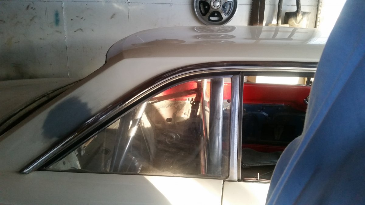

    The cage looks good. Any chance I could get you to post a picture of how close it would come to the door/roof post (b-pillar) on an earlier Falcon?
    I am trying to build up/buy a 6-point bar, closer to the sheet metal, and farther from the occupants.
  10. Evilfalcon1961
    Joined: Dec 22, 2007
    Posts: 435
    Evilfalcon1961
    from Ma
    Depending on what seat you run you could for sure move the Main hoop to be right behind the pillar of a coupe. I'll take a pic with the windows up on my hardtop

    20170109_152330.jpg 20170109_152419.jpg 20170109_152419.jpg not the best pics I have a 2 x 4 for structure on the Floor and the cage is tied into that. I'm on the taller side and I'm using lowback bucket seats but you could certainly hid the cage behind the pillar most likely

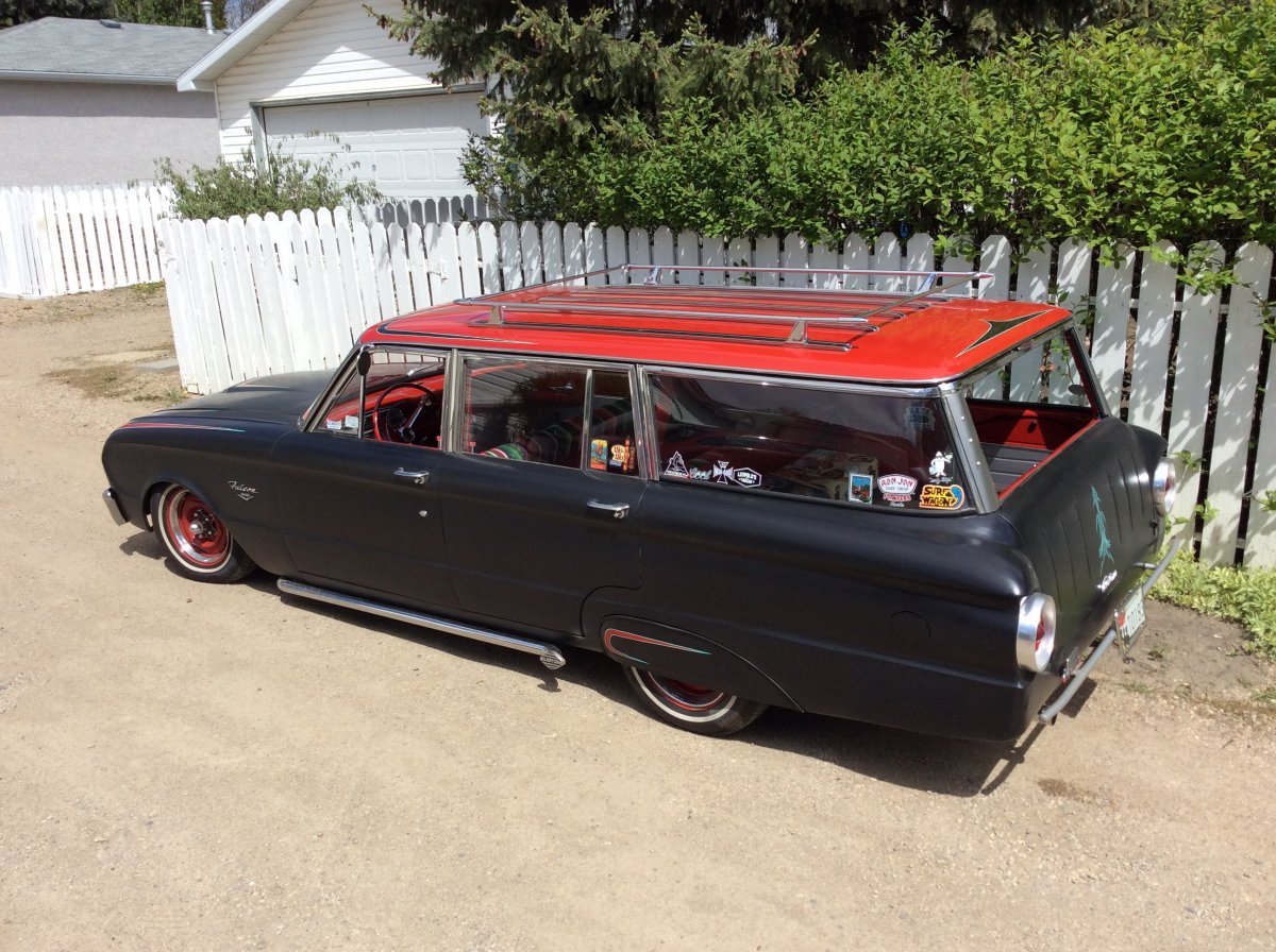

    Hey guys. New to the site but I have been lurking for awhile now. I've been on the hunt for a wagon for sometime now and I finally picked one up last week.
    60 Faclon wagon
    302
    C4, 3 speed
    Maverick rear end
    Hope to swap to 5 lug front and disk brakes sometime in the near future. I'm also not a fan of the flow masters it has and want to run gl*** packs. Anyone out there running gl*** packs with a 302? What length do you suggest?

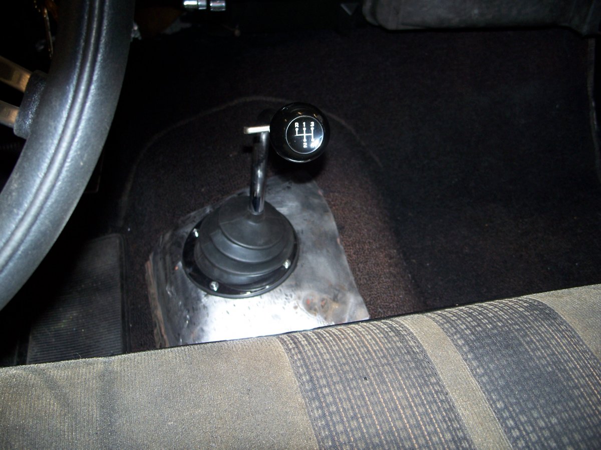

    Just finished putting a long tail shaft top loader 4 spd in my hardtop... 100_4016.JPG 100_3694.JPG

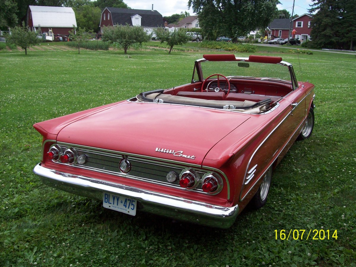

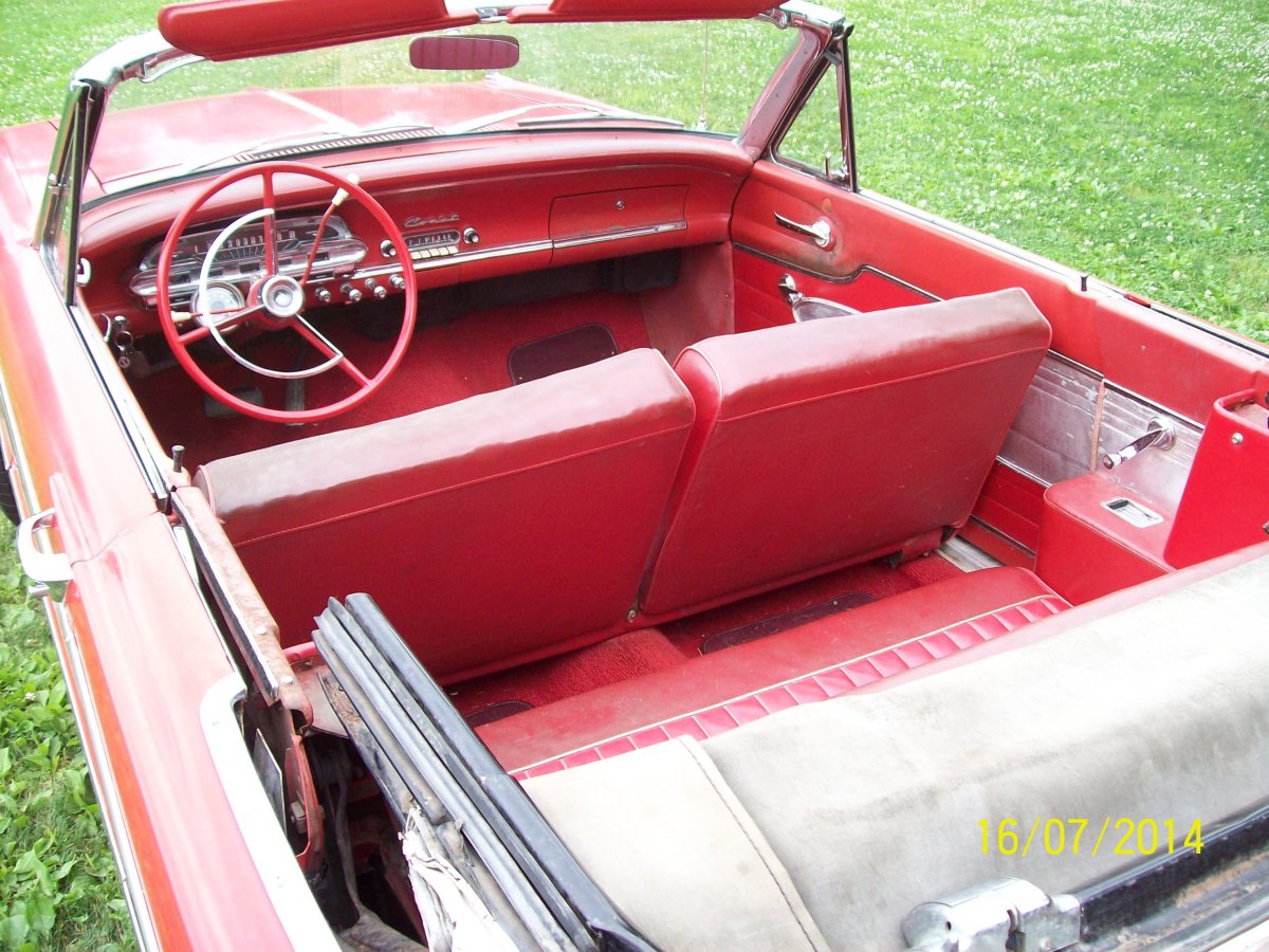

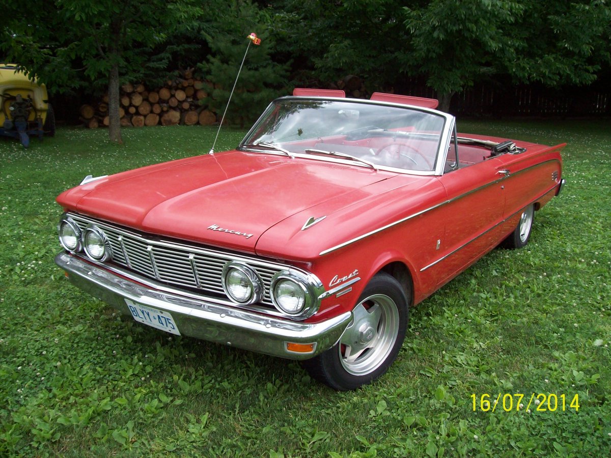

    Hi all, I posted these up on my intro but probably should have put them here. Had the Falcon 46 years, the Comet about 6. They're not show cars, just every-day drivers. All 3 of our kids(young adults) and their partners have keys. I encourage them to drive either whenever possible. My wife built the 302 in the Falcon because she'd always wanted to build a motor. Falcon and Comet 004.jpg a 006.jpg a 005.jpg a 003.jpg a 001.jpg a 002.jpg falcon.jpg
