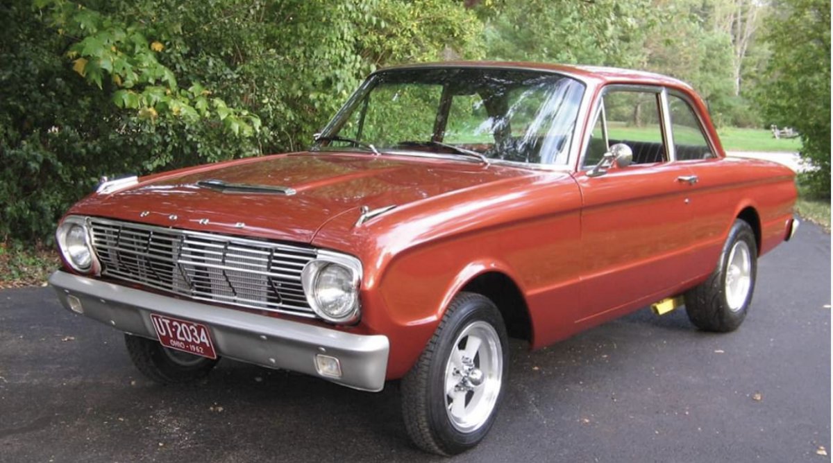

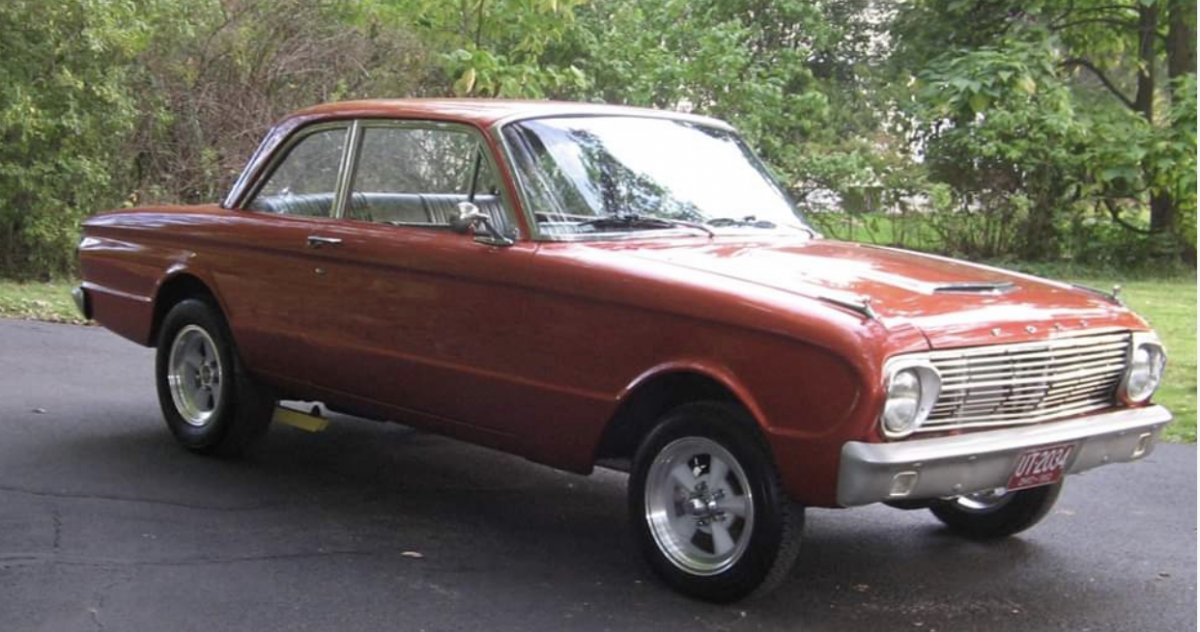

    Saw this on FB Marketplace..nicely done little street car 068CAA51-B0A4-4ACE-97B6-59C40C5E5D7A.jpeg 8119FCC6-8CE5-4341-B88A-77E2EC040B30.jpeg

    Yeah that little mod of using the stock wheel arch from a pair of front fenders for the rear wheel arch is the only way to get any rubber under a Falcon... and so subtle compared to a custom (bondo) flare

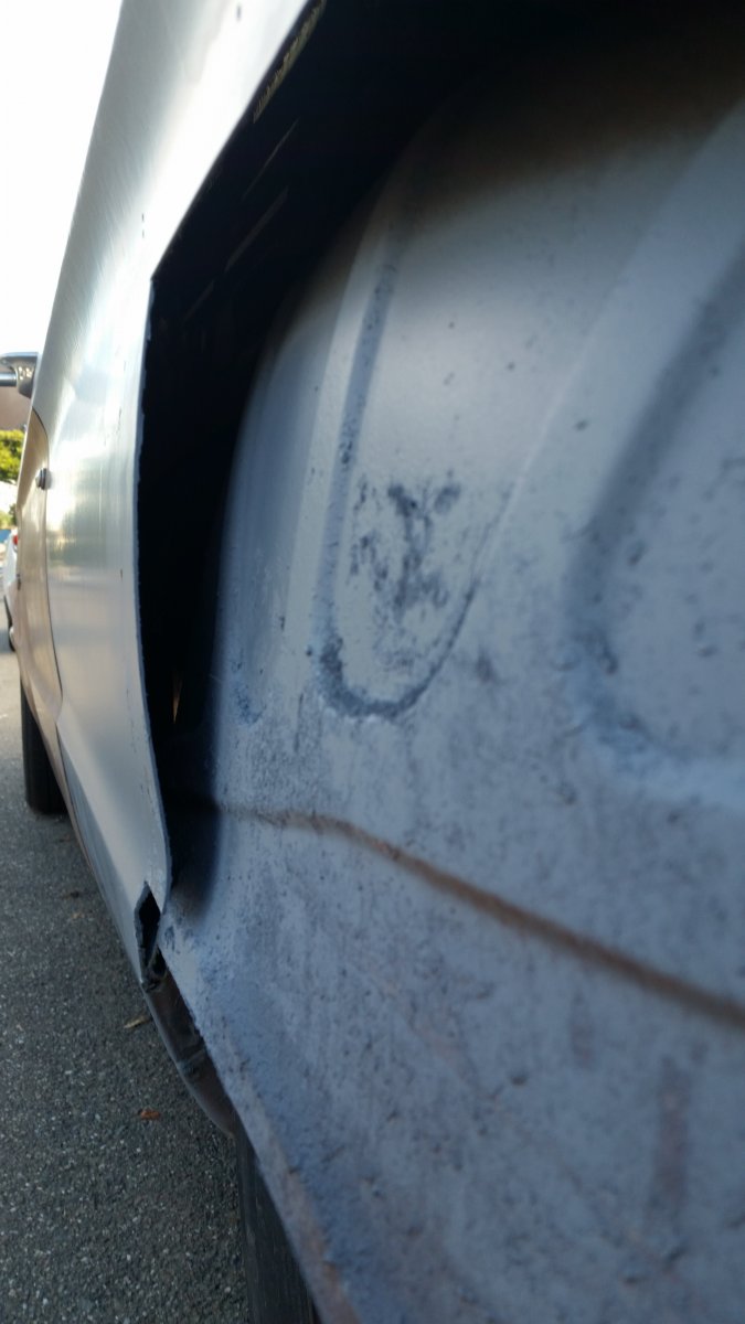

  10. gimpyshotrods
    Joined: May 20, 2009
    Posts: 24,629
    gimpyshotrods

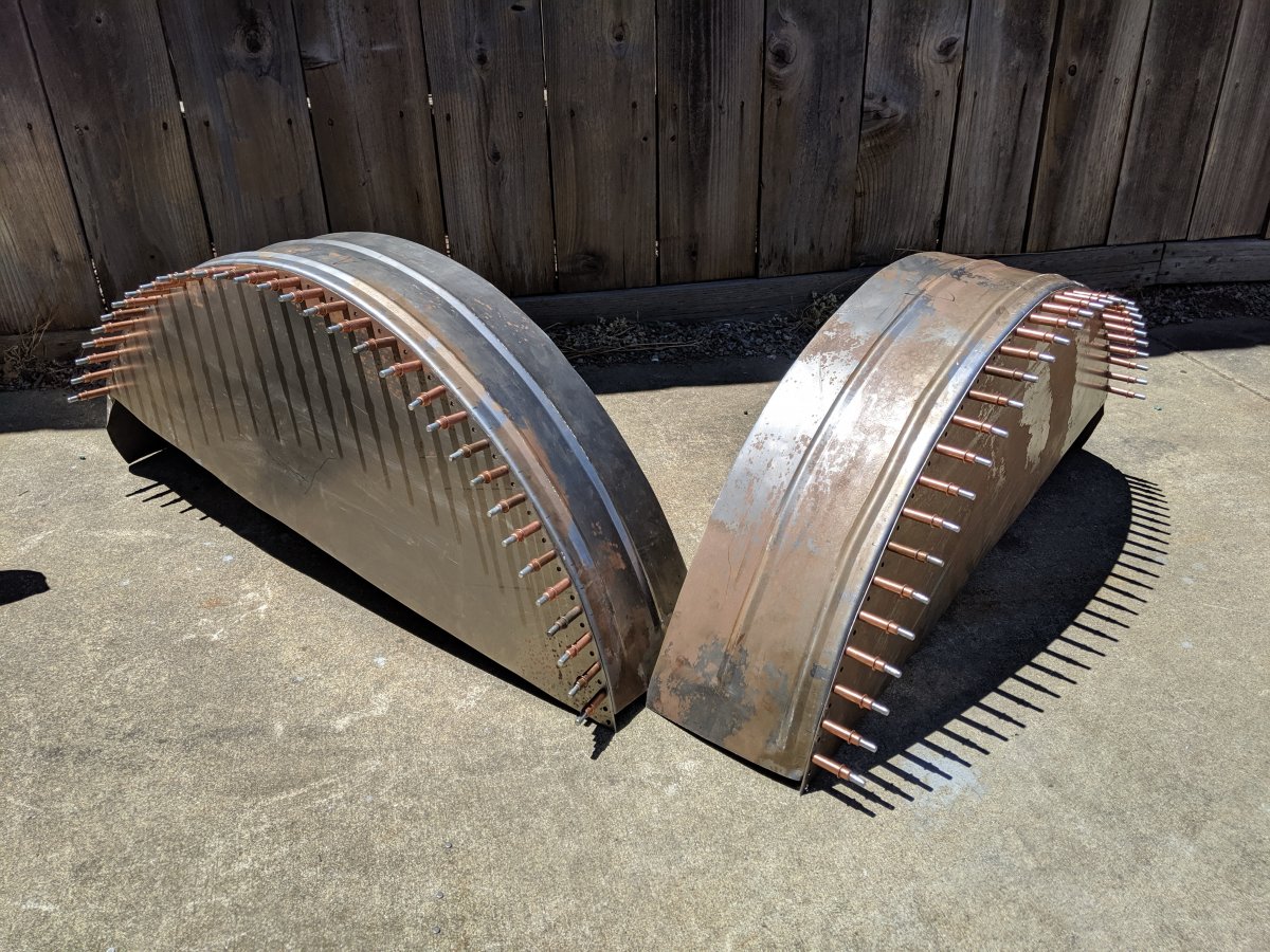

    I used Falcon front arches. I tightened the radius a bit, and mounted them lower back than the fronts.
    MUNCIE, brEad and 62rebel like this.

    Very nice. So this allows larger rear wheels?
    Digging the fuel filler cap mod too
  15. gimpyshotrods
    Posts: 24,629
    gimpyshotrods
    The fuel filler is from an XJ Jag. The cap is not featured in the picture, as that primer was wet there.
    This is one step to larger wheels.
    The wheel houses in Falcons part company with the quarter panel at the wheel arch. From there, they move inward quite quickly.
    That tends to interfere with a wider tire, especially so if lowered.
    I added these.

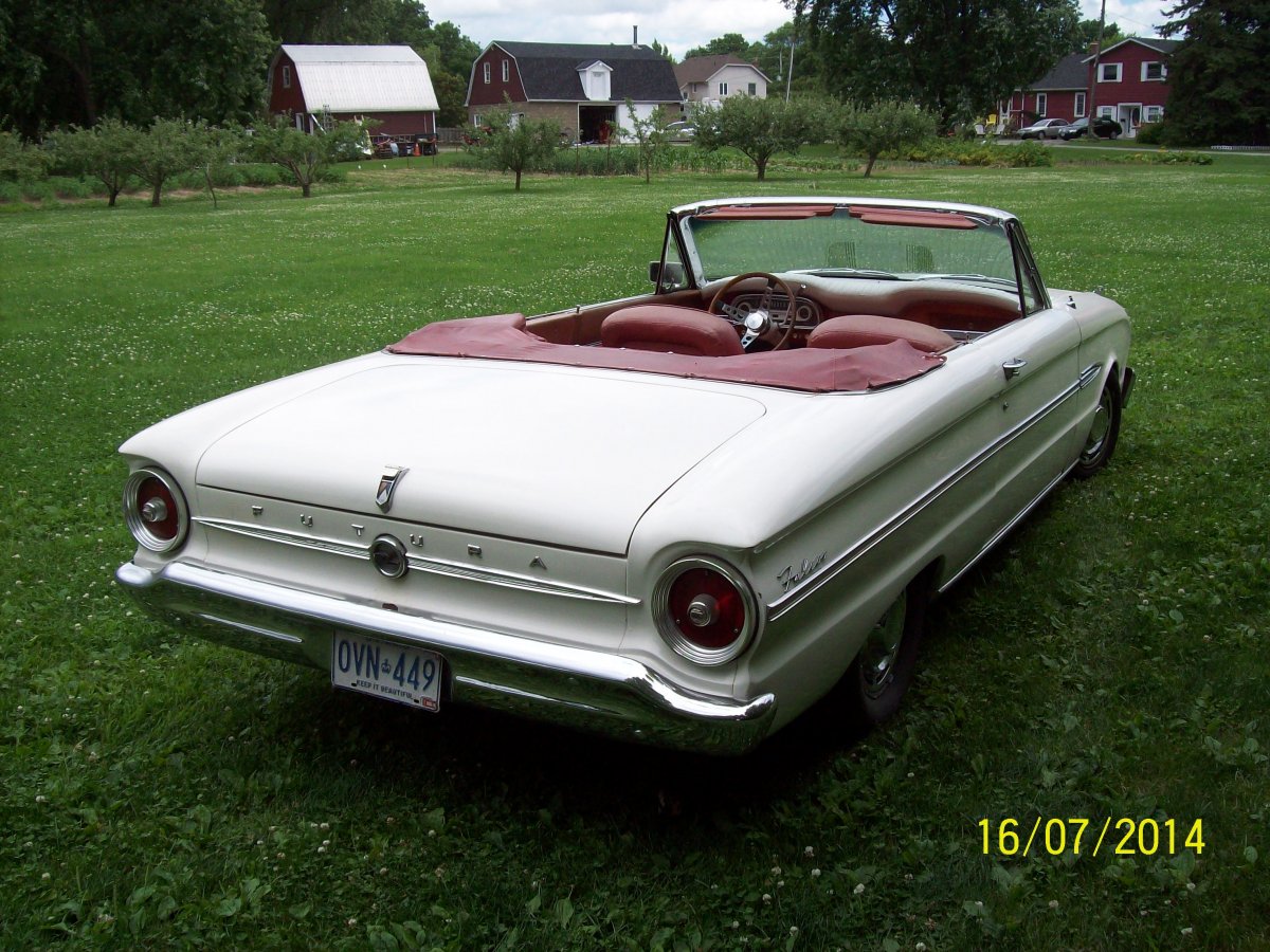

    1965 Falcon, my daughters daily driver in high school. 6 cylinder with a auto, lowered it a couple inches, smooth driving car. She’s off to college, and it’s just sits in the back yard. My son wants to make it into a g***er haha

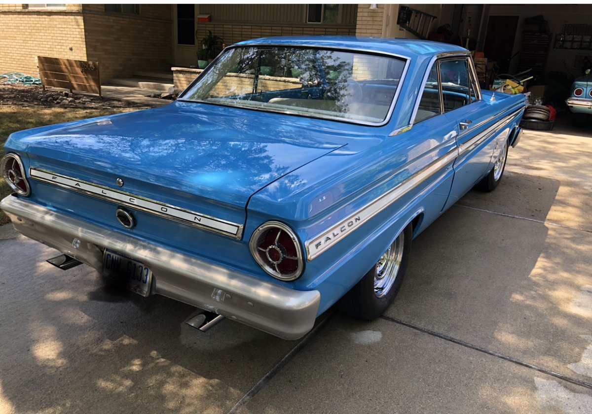

    Nice one on FB Marketplace over by me..I got way more than this into mine and it’s not done yet...checks a lot of boxes...hot 289, 4 speed, 9 inch...18K...timing is everything they say.. 4BBED6A6-A36A-4026-B517-DB88637290FC.jpeg 0B1E387F-A69C-4008-9534-08E9E7F81330.jpeg BEBDBD73-6854-441C-8726-1F3C7DFF9125.jpeg 6FDF52D6-7345-499F-94B0-11E3CF7A35F4.jpeg
