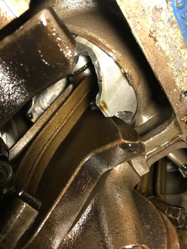

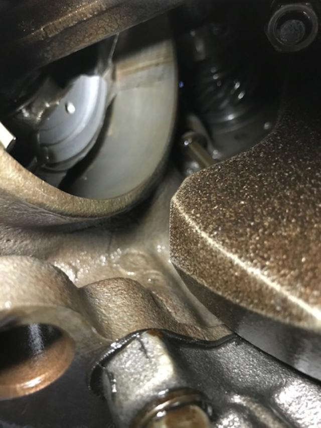

    No sir I do not think it does. My Dad rebuilt this engine for a friend of mine over 25 years ago. He had it in a 64 Fairlane and literally never put no miles on it. I'm talking less than 100 miles. He ended up just letting the car sit and got tired of moving it from place to place so he gave me the whole car about 10 years ago. I pulled the motor and put it in my Falcon.
    My Dad is older now and when I tried asking him details about the build like cam size and duration he does not remember, he just tells me that it was built to 302 specs but it's a 260. I'm thinking he means like torques specs, heads don't flow very well they have been milled and the cam did have a decent sound to it.
    I tore it down last night, pulled the pan and timing chain cover but the dots are lined up. I will get out there a little later today and take some more pics. I want to inspect everything in the daylight and not a droplight. I was a little pissed to say the least :D but I figure I can finally get the mystery solved if I pull the cam but I will wait and see. I kinda hate to tear it down that far and not need to but I will if the cam gear is chewed.

  17. MUNCIE

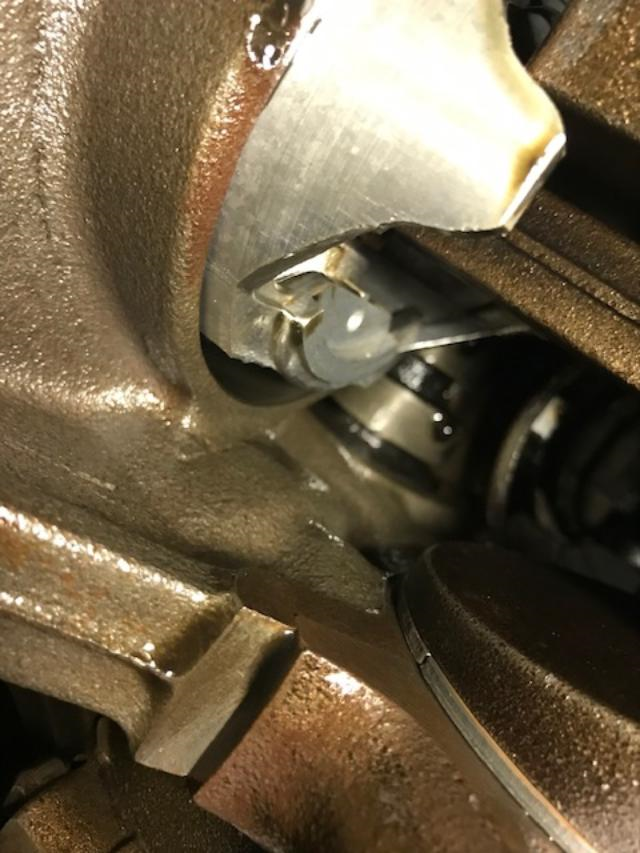

  18. gimpyshotrods
    Joined: May 20, 2009
    Posts: 24,585
    gimpyshotrods
    That does look very much like intentionally clearanced skirts.
    I wonder if the pistons were not equalized for weight.
    Deuces, Thor1, MUNCIE and 1 other person like this.
  19. MUNCIE
    Joined: Jan 24, 2006
    Posts: 2,424
    MUNCIE
    from Houston

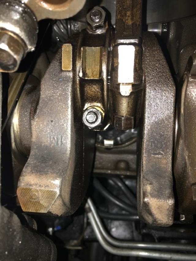

    Yes has me wondering the same. I've been asking around and there is a possibility that maybe the 260 has been stroked and fitted with 302 crank and pistons. I'm wondering if there is a way to identify the crank by stamped markings?
    -Mark
    Deuces, loudbang and Thor1 like this.
  20. gimpyshotrods
    Posts: 24,585
    gimpyshotrods
    There must be a way.
    You can always rotate the engine, and measure the stroke, via piston movement.

    I did some research and found an article with some nice information. I checked an extra crank I had in the garage that came out of a 289 and the marking matches the block. I put the pan back on the 260 with only a couple of bolts finger tight just to keep any elements or moisture from getting in there. I will pull it back off tomorrow and check the stamping on the crank. It should read either 1M to identify the crank as either 221/260/289 or 2M for the 302 crank. That should take some of the guess work out.
    -Mark

  24. MUNCIE
    Posts: 2,424
    MUNCIE
    from Houston
    Well I had a little time yesterday so I pulled the pan back off and turned the engine by hand to get a look at the first counter weight by the keyway. It's stamped 1M so it's a 260/289 crank and not the 2M for the 302 so I am really wondering how in the heck did they balance this engine if they removed material from the skirts on the pistons to clear the crank?
    -Mark
  25. gimpyshotrods
    Posts: 24,585
    gimpyshotrods
    It is possible to do this, and still equalize the weight, but it requires effort.
  26. seb fontana
    Joined: Sep 1, 2005
    Posts: 9,250
    seb fontana
    from ct
    221/260/289 use the same rod, same stroke crank and all is interchangeable except for pistons/rings. Bores are 3.50, 3.80, 4.00. If bore is 4.00 then has to be a 289. No reason to put a 50z flywheel or damper that I can think of. Best I can come up with is they used a 260 rods and crank [lighter?] and tried to get the piston weight to match the 260 pistons. Thats all I got.
  27. MUNCIE
    Posts: 2,424
    MUNCIE
    from Houston
    I noticed a small area on one of the weights that had a small area machined out. I don't know how I feel about the hack job on the skirts, personally I don't like the aesthetic look of it and it would have to be an engine combo that I would really want to use/have to do that. And if I did I would have made it look more presentable. Going to have a conversation about this with my Dad when given the chance. To me it looks like a hack job. Anyway I got plans to yank the motor out. That 351W I have is still staring at me lol.
    -Mark
