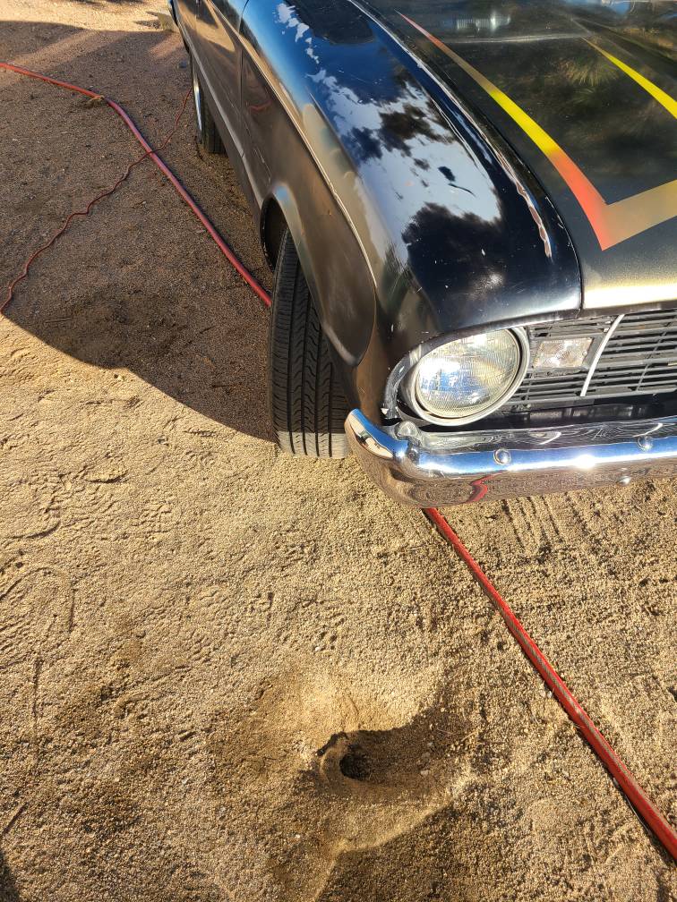

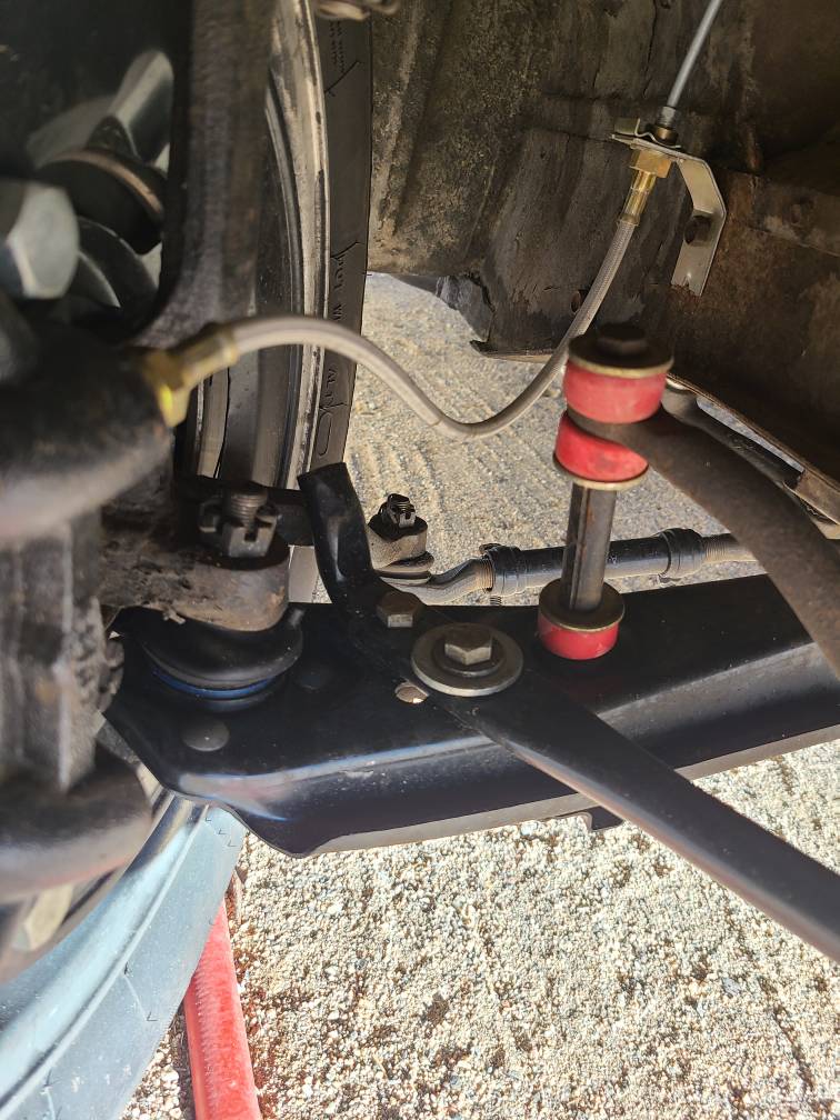

    Didn't let me attach the pictures before. I know the uppers are the 65 with larger ball joints because the spindles are V8 ones for the front disk swap. 20201230_082959.jpeg 20201230_082933.jpeg
    Sent from my SM-G981V using The H.A.M.B. mobile app
  18. gimpyshotrods
    Joined: May 20, 2009
    Posts: 24,629
    gimpyshotrods
    I can turn my '60 around on two-lane city street. You are hitting the steering stops way too soon.
    Which spindles are on the car?
    loudbang and Phoenix24 like this.

  20. gimpyshotrods
    Posts: 24,629
    gimpyshotrods
    All of your parts are good. Your problem is in the stops, and it will be easy to fix.
    V8 spindles up to 1966 work from a Falcon or a Mustang., but those are all drum brake.
    Discs were not available on a Mustang until 1967, and those spindles are different.
    Can you take a picture of the back side of the spindle, just above the bottom ball joint?
    loudbang, Thor1 and brEad like this.
  21. gimpyshotrods
    Posts: 24,629
    gimpyshotrods
    This is a Granada spindle in black, next to a full Falcon/Mustang setup on the right.
    Note the number of bolts holding the brakes on. On the Falcon/Mustang it is 4. On the Granada, it is 3.
    If you do not have Granada spindles, you will likely need to cut off the built-in stop on the current radius rods, and run the original steering stops.
    Those might require t*******, too, but that will be minor.
    brEad and loudbang like this.
  22. gimpyshotrods
    Posts: 24,629
    gimpyshotrods
    This is a 1965 V8, on the steering stop. Check out the angle of the backing plate, versus where your wheels stop:
    Note the different dimensions of the V8 versus 6-cylinder stops. The V8 ones appear to be shorter on the "business end". The V8 ones tail end is even with the bend in the stamping of the lower control arm (looks off because of the viewing angle). The 6-cylinder ones are longer, but can be cut down.

  25. gimpyshotrods
    Posts: 24,629
    gimpyshotrods
    Always easiest to have the correct stops. The stops on the current radius arms can be cut off with a regular cutoff wheel on a grinder. Just go slowly, and let the tool do the work.
