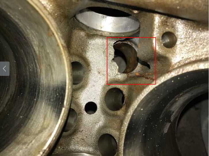

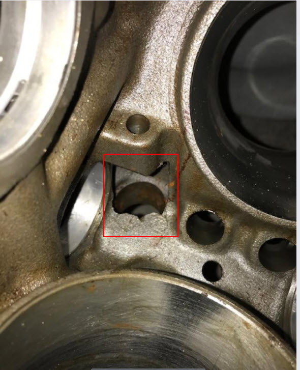

    What's going on guys? Hope everyone is doing well. I haven't been doing much lately in the garage other than working around the house as usual. Anyway I decided to remove the oil galley plugs and the engine block plugs because I am off next week to spend time with my grandkids for Spring Break and get some things done for myself. So I made an effort to go out there this afternoon to do just that because I wanted to drop the block off at the machine shop.
    So I started to inspect the block and I couldn't believe that I missed this the times I looked at it. While checking the lifter bores and such and I noticed this. Am I screwed? I think I am but would like to know what everyone thinks and what could have caused this? The distributor shaft took a dump and blew the hole? I didn't think they were strong enough to do this to the casting.
    If so another 289 for s****. At least I didn't pay a bundle for it but it is disappointing to say the least.

  13. Looks like casting flash to me, not anything broken...

    Rotary file clean that up in a jiffy

    Thanks, just wasn't sure about it.
