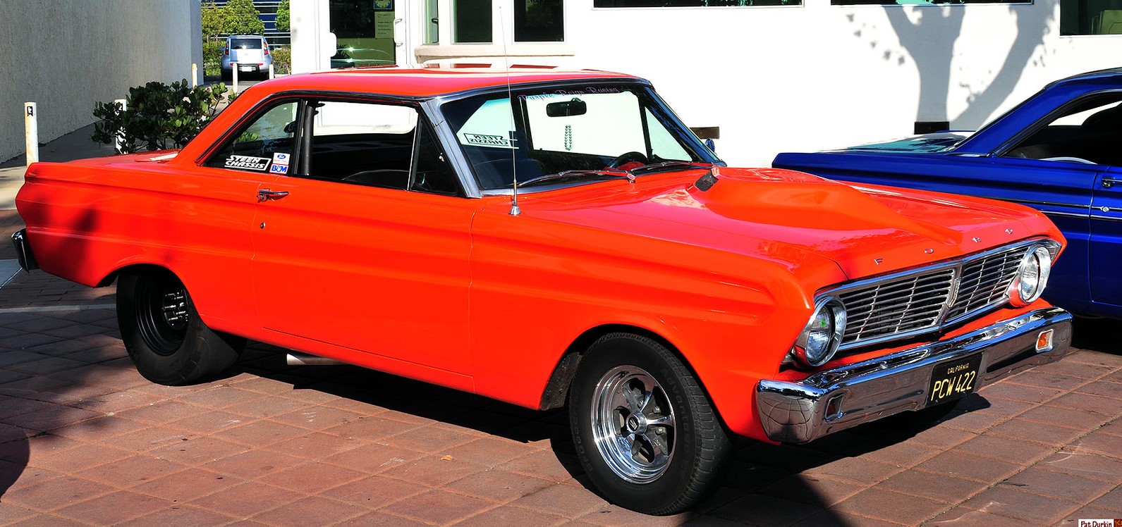

    The red one checks all the boxes, for me anyways.

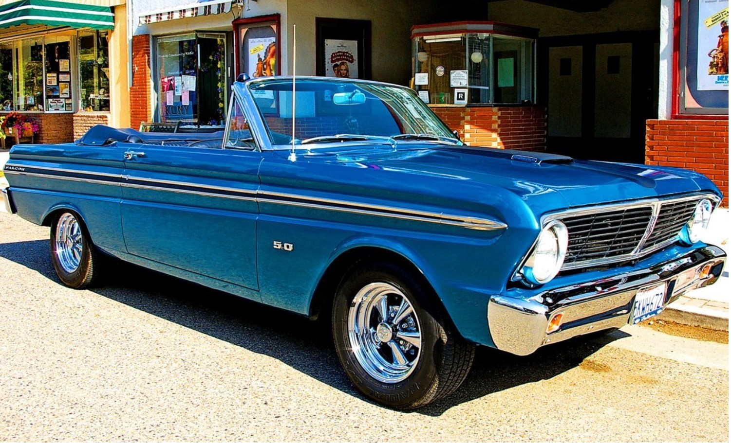

    1 of 7 Canadian 1965 Ford Falcon Hi-Pos
