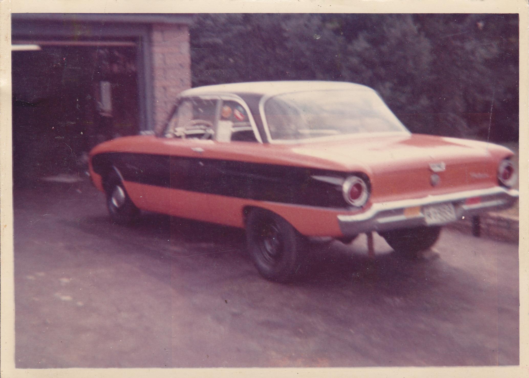

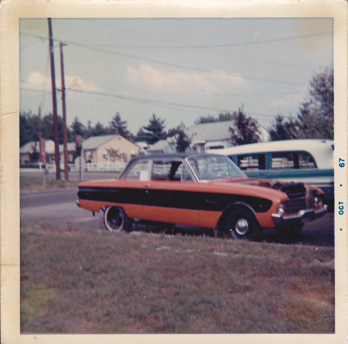

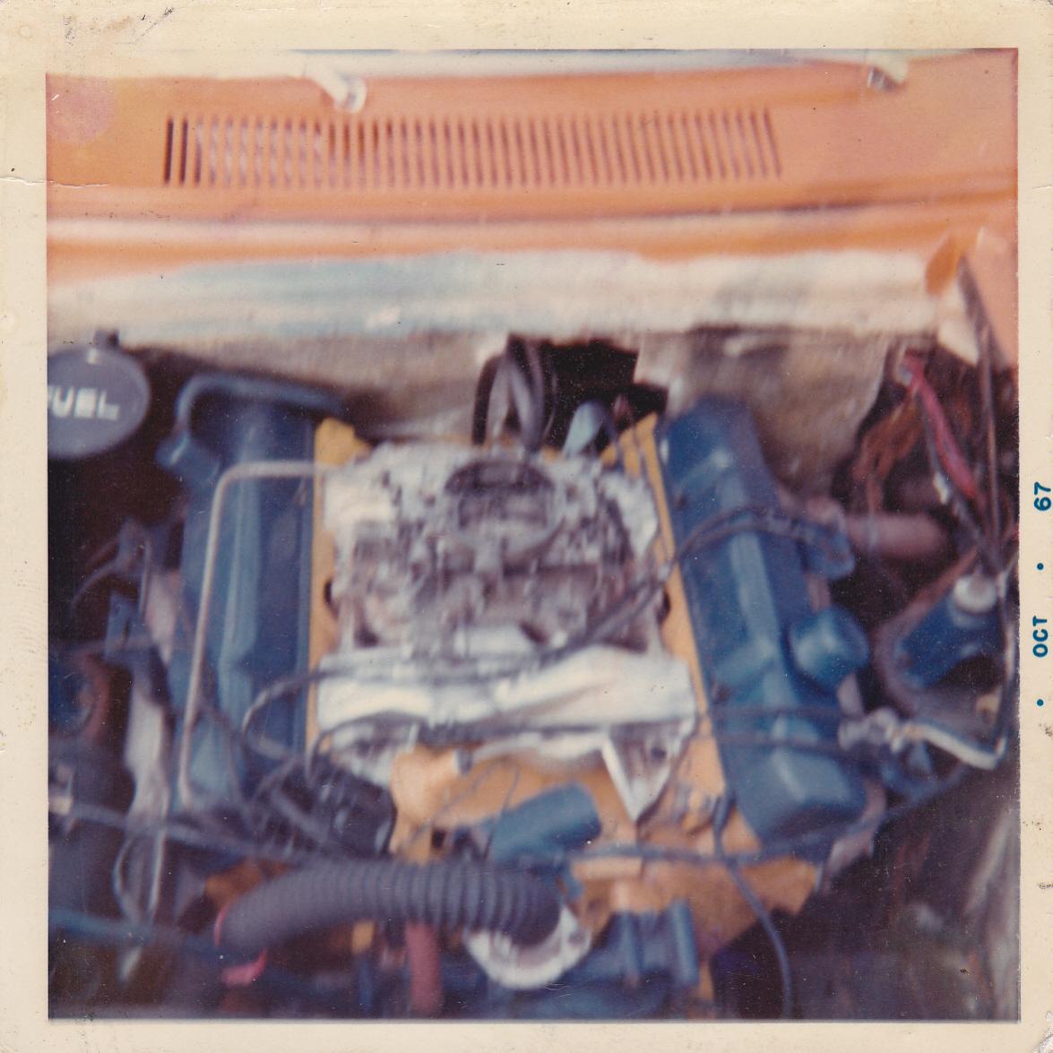

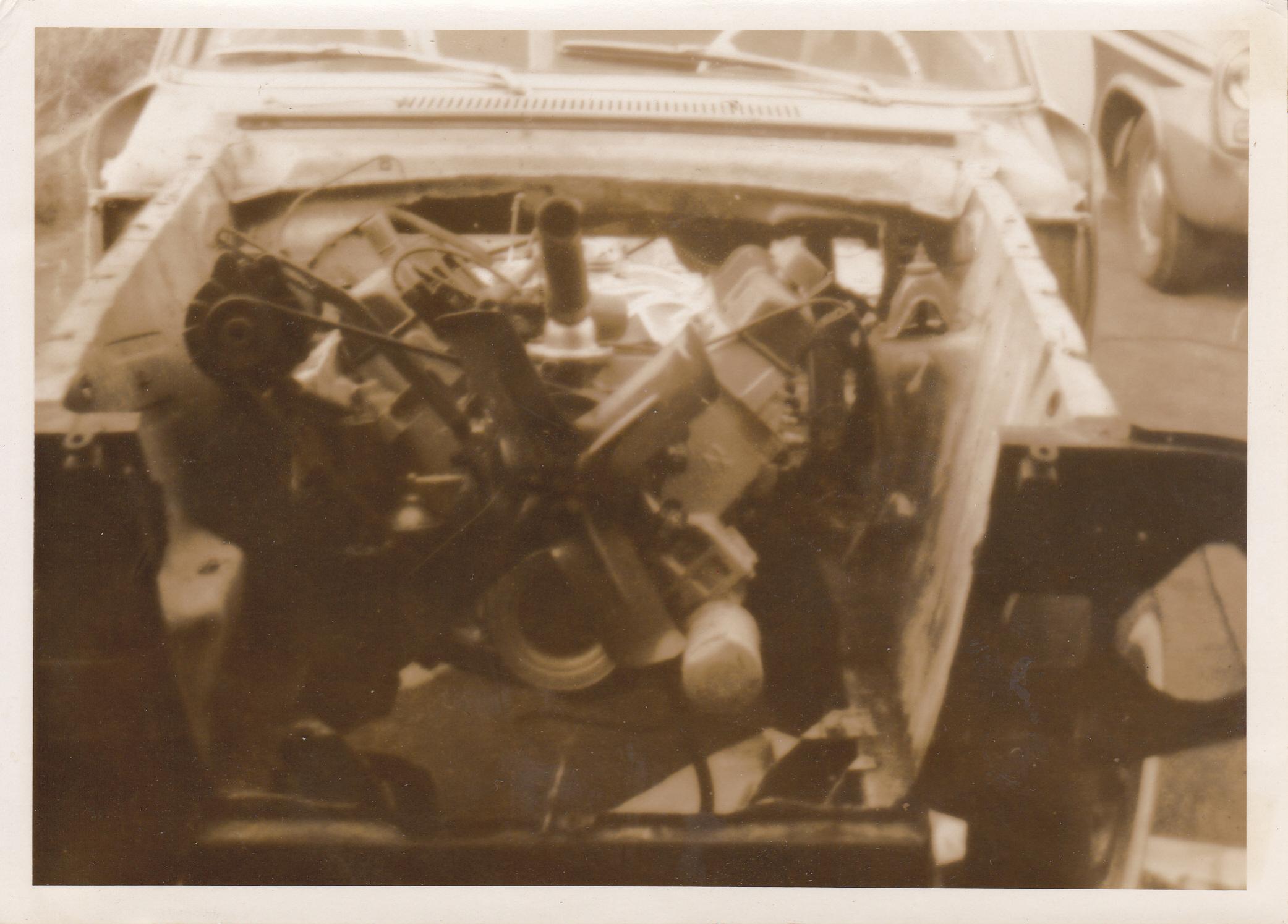

  16. I noticed the 1960 Falcon on the first post so I pulled out some pictures from 44 years ago. A short story of how we installed a 413 Chrysler engine in a 1960 Ford Falcon in 1967.
    I had just came home on leave from Vietnam and my buddies all came over to welcome me home. We talked for a while and one friend gave me his Chrysler New Yorker. It was complete, and in great shape. Another buddy new of a Falcon for sale for $30 with no engine and trany. So we talked about stuffing the 413 into the Falcon. We laughed about it and then decided " let's do it". We pulled the 413 engine and transmission along with the push ****on shifting mechanism, and cable. The Falcon arrives and we pull out all the upholstery, and insulation. I pull the front renders, bumper, grill and anything else I think will get in the way when stuffing the big 413 into the little Falcon.
    I cut out the floorboards, and part of the firewall.
    Before I installed the 413 I painted it yellow, and blue a color I used years later when I became a professional racer. I also changed the oil, and spark plugs.
    I slid the engine down into the Falcon, and it fit like a glove. On a 413 the starter is on the left side of the engine, and the solenoid hit the Falcon steering box. So I pulled the engine back out and removed only the solenoid. I fit the engine back in and shored it up where I wanted it to permanently sit. Because of the body construction I had to build a sub frame in the trany area. I designed it so that the sub frame sat on top of the inner part of the body inside of the drivers compartment. I made paper patterns for the engine mounts, and fabricated them out of flat stock welding them to whatever shape I came up with.
    Before I go any further I should put things into prospective. This was 1967, and the car, and engine where only 7 years old. No one made custom headers yet, and cheater slicks where hard to find. Gas was 25 cents a gallon, and in today's money everything is ten time as much.
    Having said that I got the engine set into the car and all the mounts where hard fixed, no rubber was used. I still had the starter problem to figure out. So I came up with the idea of using a mechanical cable to move the arm that the solenoid moved in the same way. I then took a battery cable and wired it into the starter. When I touched the other end of the cable against any place on the sub frame, it would ark and the starter would spin. The other mechanical cable was used to engage the starter gear into the flywheel. It was a simple procedure and would turn out working far easier than one would think. Once the engine was in we decided to change the rear end. At that time the strongest Ford rear end that we new of was from the 54 Ford station wagon. One of my buddies worked at his uncles junk yards and the next day he brings over a station wagon rear end with the 4:11 gears.
    I remove the Falcon rear end and cut off the spring pads, and do the same to the 4:11 rear end. I weld the Falcon pads onto the 4:11. The rear end goes up in place just like it was made for it.
    We install straight pipes and I made brackets for the radiator. I think I used the 413. I can't remember. I took the push ****on shifter, and welded an arm inside there somewhere. All I had to do is move the arm to shift gears.
    We put the fenders and trim back on the car and we painted it Omaha Orange, and black. Don't ask me why. Hay, it was 1967. The top was sprayed with that vinyl spay on **** that they had just came out with.
    The car was ready to go except for a drive shaft. Remember what time in history it was. If we took a drive shaft to a shop to have one built we wouldn't get it back for weeks. We built the car in ten day's, and I was only home on leave for 30 day's. So we took the Chrysler drive shaft and installed it in place accounting for back and forward movement. I marked it just forward about 2" from the rear end U joint. I then took a hack saw and cut the shaft in half. I then took the Ford station wagon shaft and cut it 12" forward of the back end. I placed the two shafts on the bench and measured the diameters inside and out. The Chrysler shaft was 1/8" larger than the Ford shaft when I placed the Ford inside the Chrysler. What's a guy to do! I looked around the shop and picked up a piece of 1/16" thick gasket paper. I wrapped the paper around the smaller Ford shaft and started to slip it into the Chrysler shaft. I then pulled it out and took the lager Chrysler shaft and drilled a series of 1/2" holes around the shaft where the smaller shaft would set. I then slid the smaller shaft with the paper on it into the larger shaft. I lined up the U jounts and tack welded it in place. I then removed the paper in all the 1/2" holes by s****ing it out. Then I welded the holes up. that's called a Roset Weld. The shaft fit into place and we where ready to take our little racer out for a run.
    I went an got plates for the Falcon the next day. It was in New Hampshire, and at the time you had 10 days to get an inspection sticker. The cops wouldn't give you a ticket for ten days on a safety infraction. For instance you couldn't run without a hood for one. I also didn't have the transmission covered up. Ya, I know we where looking for trouble with that old cast iron toqueflight.
    We had ten day's and we drove the cops crazy. I was in a town on the boarder between New Hampshire, and M***achusetts. If we went across into M*** on the back roads we never got bothered, but once we made it back into New Hampshire the cops where on the look out. Our friends would be hanging out at the local A&W, and they could here us three to five miles away. They said it sounded like a set of trumpets with those straight pipes. About 11:00 till about 1:00 AM we would blast form neighborhood to neighborhood never running more than 75 MPH. We would come out of the hole for all it had. Then we would pull in somewhere and hide as the cops would patrol looking for us. If we where in high gear and not in the throttle the car was quiet.
    Well we ran the **** out of it for ten day's and it was almost time for me to go back to the Army. A buddy of mine from M***achusetts bought the car. I had $300 in it and a lot of fun building it. I sold it for $300. All my buddies drove the hell out of it. All these years later I always wondered why the front end didn't come out from under neath the dam thing. The car only had around thirty thousand miles on it.
    Back then people didn't keep a car but a few years and they didn't want them.
    Well I hope you enjoyed my story about back in the day. Some of you will remember when you where out there doing it. Others will not have a clue.

    Wow, what a wild contraption. I've often joked about stuffing my 440/727 into my Falcon, but never would have guessed an RB in a '60 had been done way back then.
    Thanks for sharing that.
