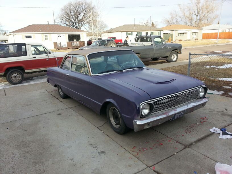

    Hey guys and gals this is my 62. I havent had it long but we just recently painted it. Its suede purple with a gold top. The picture doesnt do it justice but its a work in progress. Ill post more as they come. I have been looking at doing a set of wheel vintique 15x7s and I was wondering if anyone else has done a seven inch wide wheel on there car. uploadfromtaptalk1359650540570.jpg

    Looks good. A 7" wheel is pushing it on these cars, especially when lowered. You really have to watch the offset. To much back spacing on the front will rub the control arms during turning and too little will rub the fender. In the rear, on a lowered car you have to watch both leaf spring clearance and inner fender well.
    Bot saying it can't be done, but you have to nail it spot on.

    My '62 coupe has a 7" wheel on the rear, but it has a Maverick rear narrowed about 2" (two short side axles) with 3.5" of backspace and a 195/65-15. With it lowered about 4" total, rear tire changes are an all afternoon kinda deal...

    The wheels I was looking at have a 4 inch backspacing. I can imagine changing the back tires is going to ****.mine is sitting at about 3 inches of drop and its pushing it. Ive heard using newer dodge steel wheels work decent because they are 15x6s but im not sure. I would imagine that they would be primarily front wheel drive offset and im sure thatd pull them in to far. I got to do some measuring.

    I'd sure stick with 15x6 myself, with about 3.5-3.75 backspace. If for some reason a 4" backspace got into anything you could run a 1/2" spacer though. We have had several discussions on tires and wheels over on the "TECH" thread "Doing Falcons Right"...

    On a round bird, I'd go 6". Really, I'd go for a 14x6, but that's me. I'm running a 15x7 reverse on a narrowed rearend, and a 15x6 standard in front to maintain any sort of turning radius.
