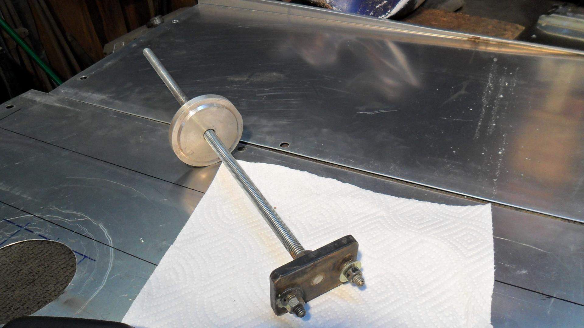

  22. need louvers ?
    Joined: Nov 20, 2008
    Posts: 12,901
    need louvers ?
    Oh, made my template for the Shelby drop deal a year or two ago out of some stray 1/2" stock around here. Made a cool spring compressor too!

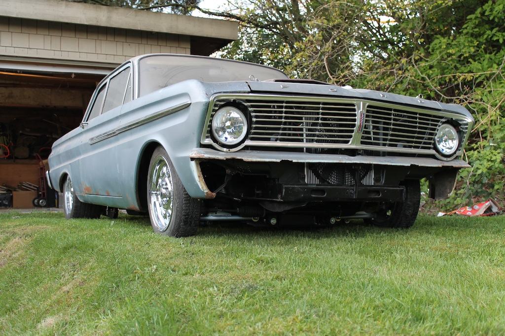

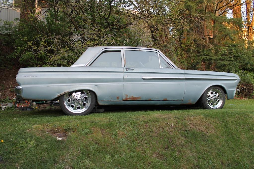

    It is stiffer than stock, by quite a bit. I like it. It handles well. I did a '64 a few years ago, with Grab-A-Track 620 springs, from Mustangsplus.com. That was too stiff for, for my liking, but the customer loved it. That is why I went with the Shelby GT-350 springs, from Mustangs Plus. They are a nice compromise. I would cut a full coil off of them, right out of the box, as they are in the nosebleed-stance category on an early Falcon, with a six, otherwise. I took out a second coil, and got this:
    [​IMG]I am sure that it will settle a little more, but I am cool with that. The rear will be coming down to level, when I have the scratch to re-do it all back there. There is a 1" bar up front, too. I cut down a set of later strut-rod poly bushings, as the early Falcon's are different. These may be too stiff. I will swap these out for rubber, possibly this week, and see if that softens the cycle up a bit. I also pumped up the little radials to the max to dial out some of the softness when the worn, soft spring were still in there, and I keep forgetting to put it back to something less silly. I will post how that changes the ride.

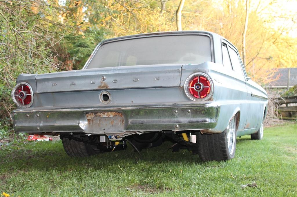

  27. 65falcon
    Joined: Nov 4, 2009
    Posts: 35
    65falcon
    First time in 4 years that it drove and stopped on its own...
    390/C6 - blocks in the back and bags in the front.
