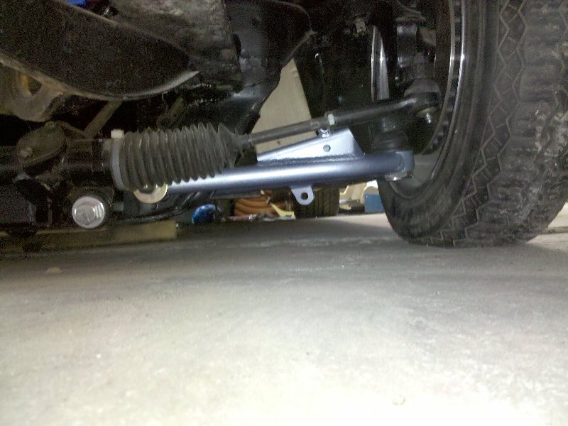

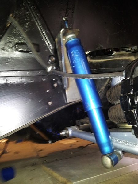

    Some pics attached. Yes shock towers are gone.

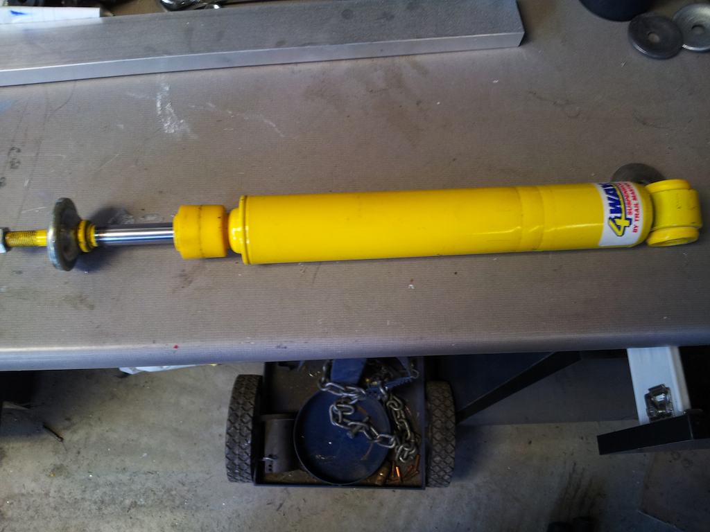

    I used a stock M2 cross member and Heights lower A-arms and their upper bag mount. I had to add an outboard upper shock mount to make it work. Standard Firestone 2500 bags. have since changed the front shocks to ones with integral bump stops - yellow.

    Cool, good to see. If I won't sound like a total ***, I'd like to make one suggestion though. I see you went over to tube "strutless" lower arms. One of the best things you can do with that situation is to make a rear mount that captures the the lower inner pivot and ties to the frame. The strutless "A"type arms on Mustang IIs have a bad habit of tearing the rear wall of the crossmember out when that rear pivot is not mounted in double shear due to braking and suspension shock loads. By adding the bracket I'm speaking of, you remove that load from the cross member's rear wall and apply it back out to the frame rails where it went in the original Mustang II design with the strut rods. Member here ElPolacko wrote the most definitive Mustang II tech post ever many years ago and it is available with a simple search here on the H.A.M.B., and addresses this deal super easily.
    I'm not meaning to criticize your work, but I have seen this deal happen time after time between doing my own shop stuff and helping ove at El Polacko's shop over the years.
