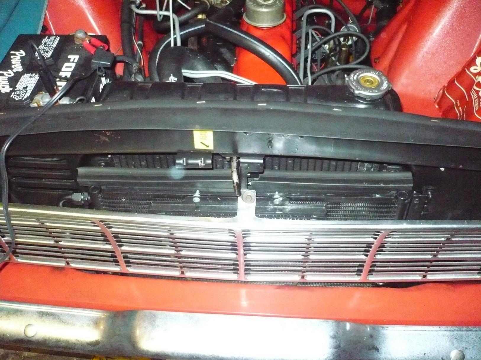

  20. Is there anyone here that could throw up some photos of the hood catch ***embly for a '60 please? I need shots of what fits to the radiator support if possible.
    This '60 that I'm building for my wife had everything stripped out of it when I bought it and I'm a little worried that the bits I have are not correct.
  21. cruzingratiot
    Joined: Oct 2, 2008
    Posts: 345
    cruzingratiot
    from Detroit MI
    how about these pics
    one is from before my ac install

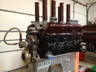

  25. Thefalconkid
    Joined: Feb 5, 2012
    Posts: 177
    Thefalconkid
    engine is almost ready to go in

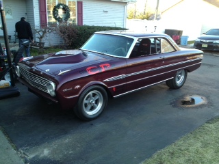

  26. Project Paladin
    Joined: Nov 10, 2012
    Posts: 229
    Project Paladin
    Friend of mine. All steel car runs 10.0's @130.
