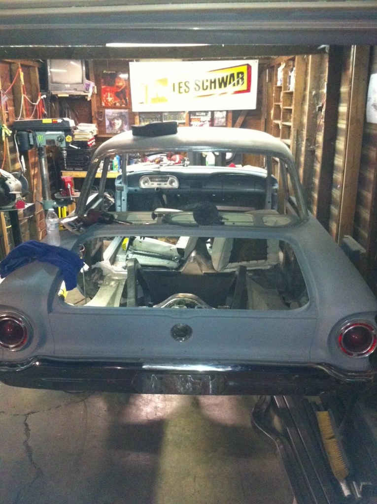

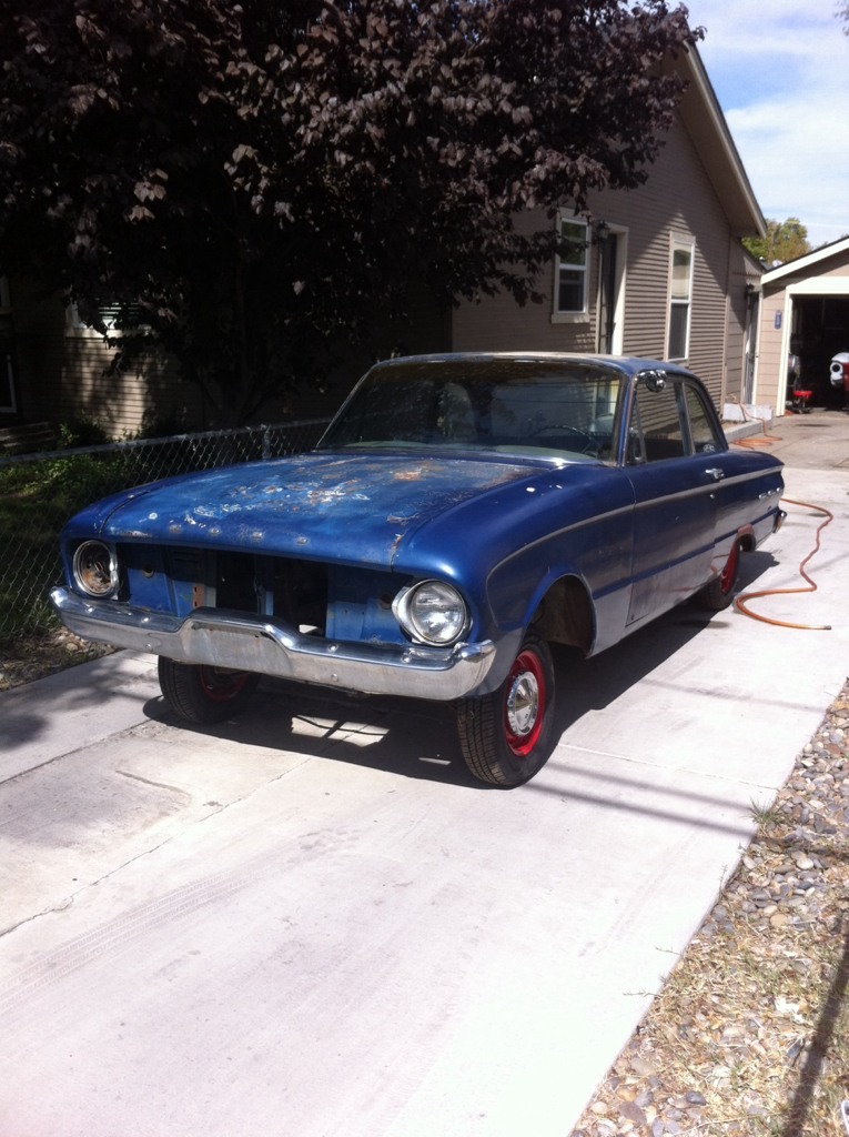

    Love seeing all these build. Had a 66 falcon in high school and am now working on a 1961 and 1960 ford falcon 2 door sedan. Both I got for 150 bucks. ImageUploadedByH.A.M.B.1382137712.063911.jpg . Here is the 61 when I got it. Guy was starting a restoration and found out e had a baby coming. And now it sits like this. ImageUploadedByH.A.M.B.1382137806.190161.jpg it's getting tubed and blown with a big block ford. Building this one like I've always wants to but couldn't. And this is my 1960. ImageUploadedByH.A.M.B.1382137869.794136.jpg getting a custom job building this one as the family cruiser and daughters car for when she gets older. Going full 60's custom with it. I'll post more pics of them later. Putting the 61 on the back burner toget the family cruiser done.

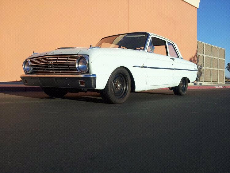

    1963 Falcon 2 door with 56k original miles on it. We are building a "Clone" road racer, so far this is the work that has been done.*
    Maverick 8" rear end, CSRP Granada disc brakes, Open Tracker-standard upper/lower control arms, roller bearing spring perches, roller idler arm, 1" sway bar, 1965 Falcon centerlink, relocated upper control arm (Shelby drop), rolling on 90's Crown Vic steel wheels, with Falken 205/50R/15s. Interior is super nice and original, front seat bottom is worn out but have complete new interior (seats). The door panels are perfect except the driver door has a small tear but not bad. NO RUST ANYWHERE...a little surface rust but super light. All trim in place and good condition....trunk still has original mat in super great condition. Trans works great, 170ci 6 cylinder runs but has a few knocks....most likely lower end crank bearings. This little Falcon handles great with all the suspension upgrades. It is begging for a nice little 302 and T-5...or a built up 6 maybe with a fat side draft Weber!

    I'll give it a poke- although I'm a SBF V-8 fan, I think the idea a built I-6 with a Weber, a header, some head work and a cam is cool, too, but that kinda' negates the late model manual trans without an adapter of some sort.

    How late is late model? A late 200 or any 250 will take a 5.0 bellhousing - and therefore a T5. Or the '67-'79 170 / 200 bellhousing will accept an SROD, "Imposter" Toploader 3+1 or regular Toploader.

    An early Econoline bell, behind a 144/170, or early dual pattern 200, and an adapter will mount-up an S10 T5, with just a little flywheel machining, that any shop can do.
