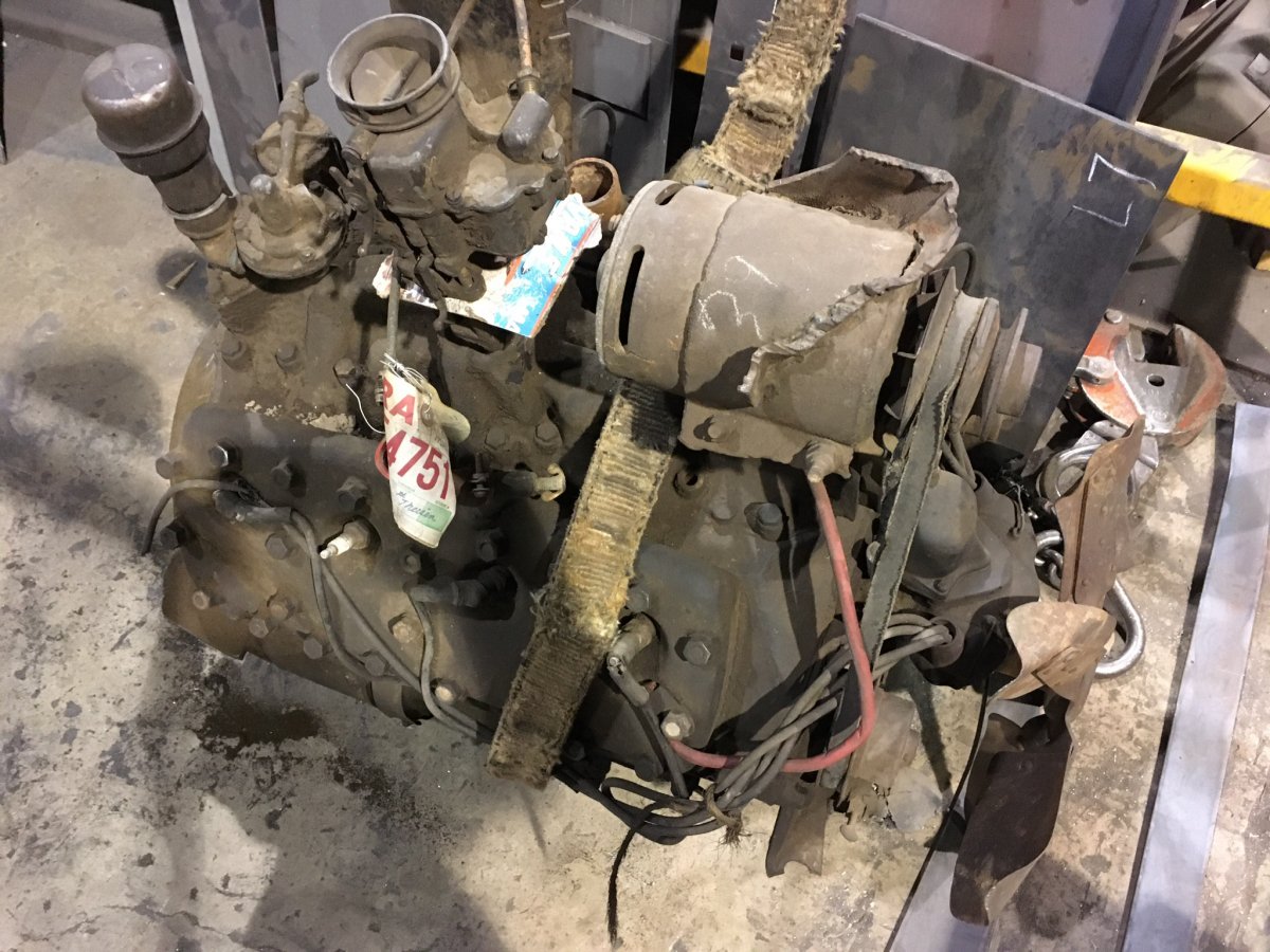

    6A04FE39-551C-48FD-9C03-7AB32834D0EC.jpeg Directly to the generator? That clears the distributor?
  4. Some combinations will give you problems. I think the '39 Standard came with the fan on the generator from the factory. The generator was the 2 brush which is probably what you want to use.

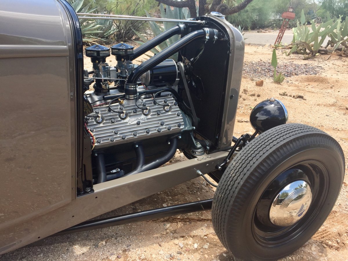

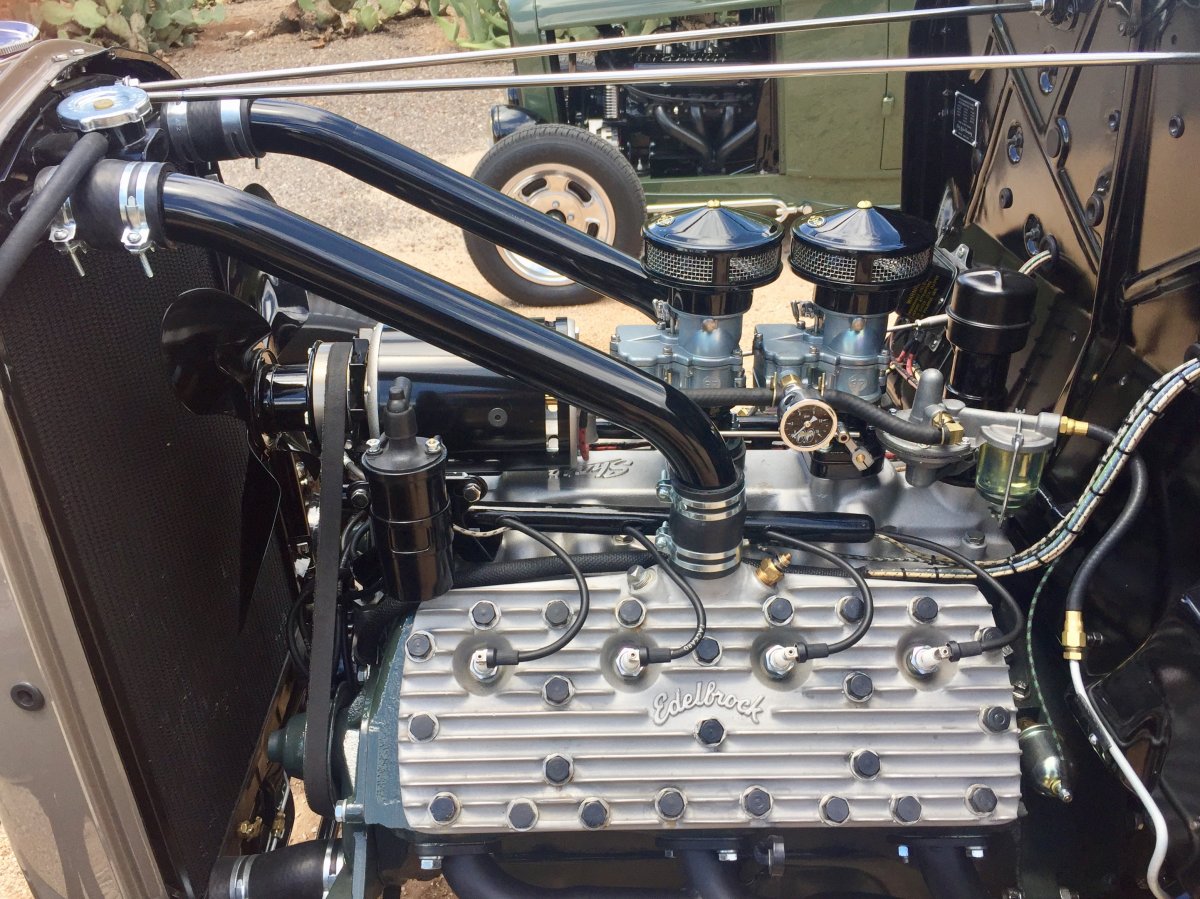

    Another option is to get this adapter, find an early fan that has the correct hub length you need, and mount off the front of the alternator/generator. Kind of difficult to see the fan since it's black, but hopefully you get the idea.
    lurker mick and akoutlaw like this.

    Thanks for the information. The generator mount makes it easy, clean, and simple.
