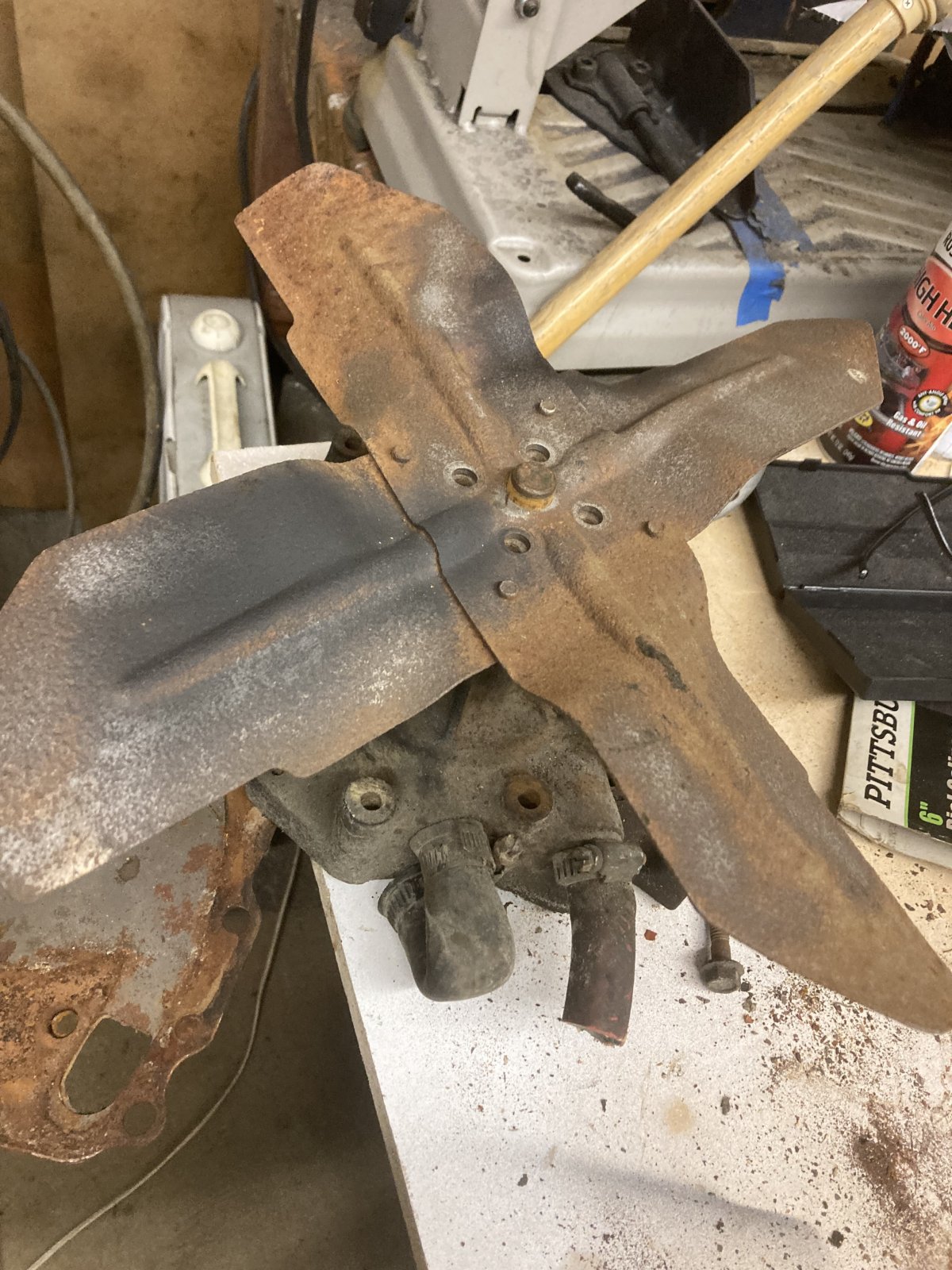

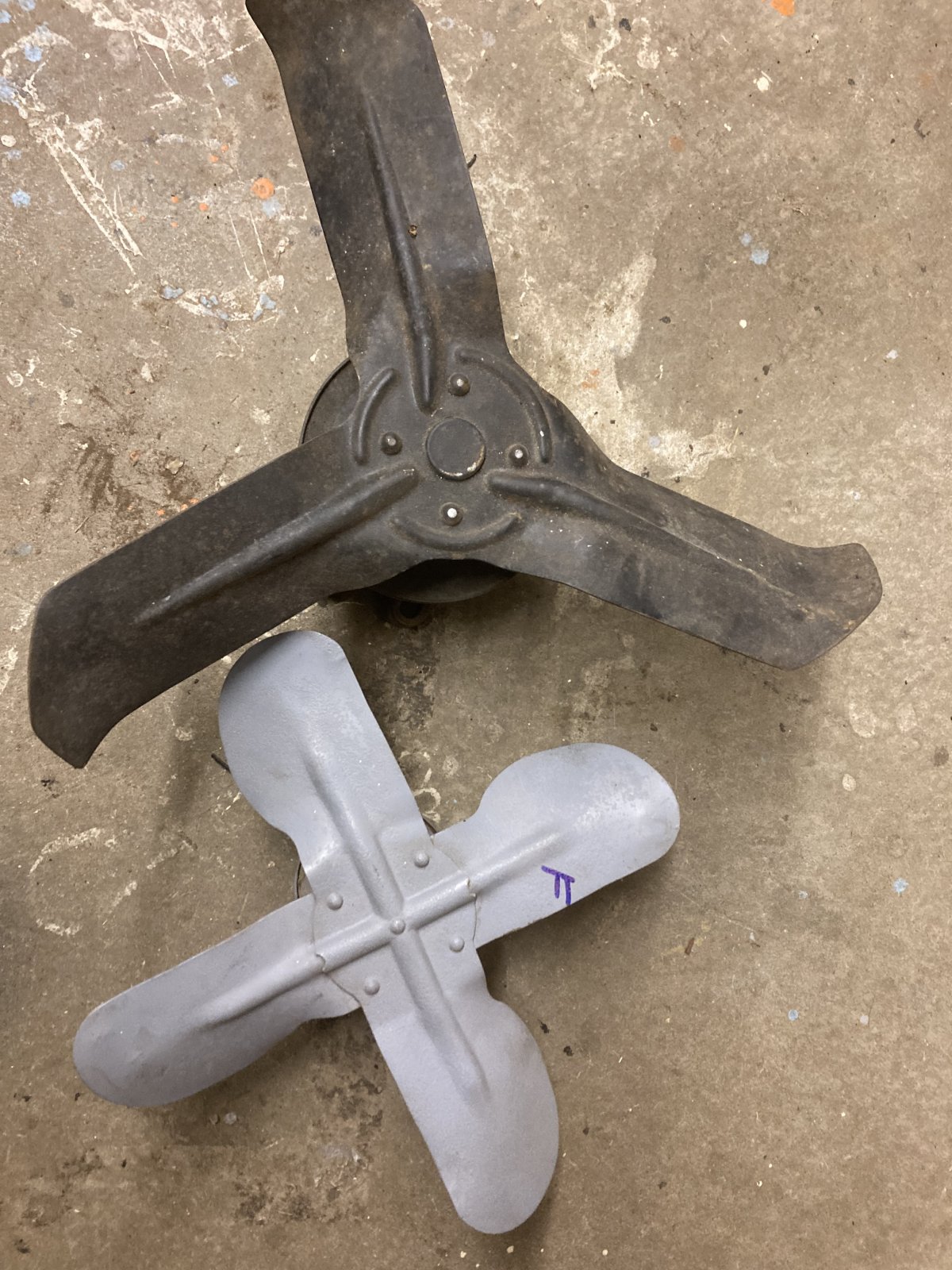

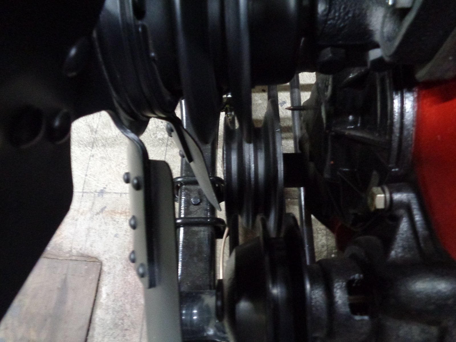

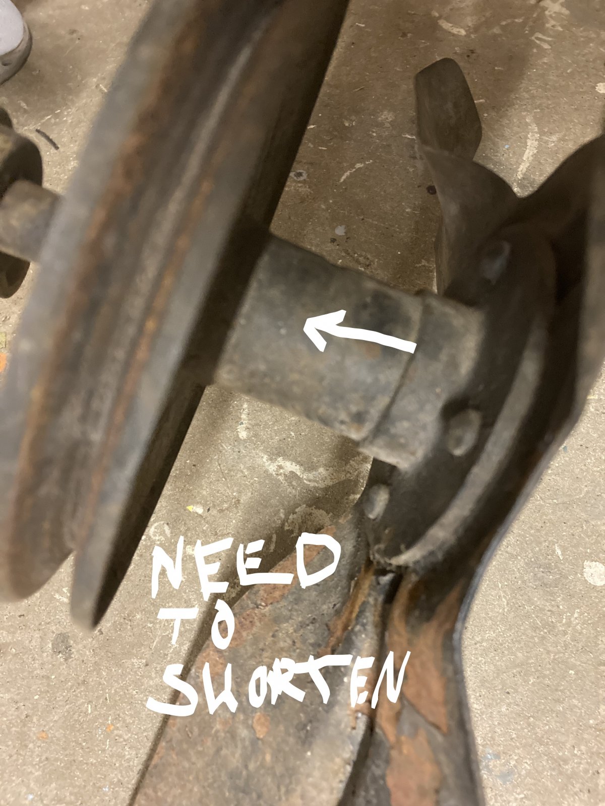

    I am working on installing an 8BA Flathead into a 31 Model A tudor. I built motor mounts so I am using the car water pumps. I’ve come to the point where I need to figure out a radiator fan.
    The original radiator fan, which is the black one in the pictures, will hit the radiator and water pumps.
    However I figured out that if I take the gray fan which I believe came out of a 36 Ford and attach that fan to the black fan base, I will be able to clear everything and make that fan work. What that means is I have to take out the four rivets on both fans. And install the gray one onto the black hub.
    There are a couple questions and maybe someone has a better idea than me.
    1. On re***embly, I would need to use bolts, weld them, or rivet them back in. I do not have anything to do the rivits. Are bolts with lock nuts and lock washers ok?
    2. When I remove the gray fan itself I need to mount it on the hub behind the black fan. I also need to shorten the black shaft. I ***ume that it is pressed on top of the shaft. I’m wondering if anyone has done this or has a better idea than me or any advice.
    thank you

    The "safety" of your fabrication skills, strength of your welding, accuracy of your fit, etc. cannot be accurately ***essed over the internet. Don't sell your ideas short. The person who balances in this area says he balances everything he can find in his house - as if it's a fun and rewarding thing to do. I think a fan could be balanced. Did Ford balance these fans originally?
    Forty, is that shaft solid or hollow?
    D

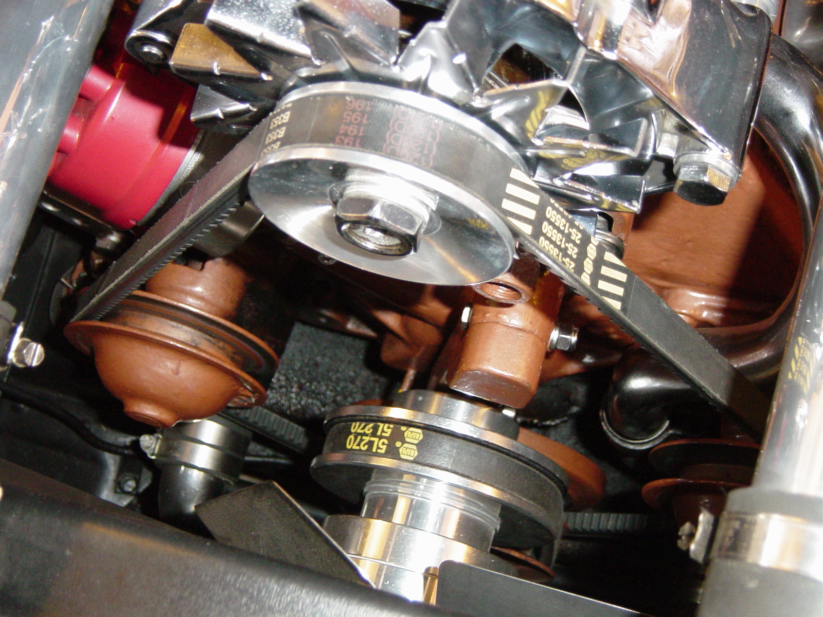

    Ben: I too prefer a mechanical fan. Just do more research and don't take the chance of modifying your black fan as you are playing with a potentially very deadly component. Check this out.
    https://www.fordbarn.com/forum/showthread.php?t=307337&highlight=corvair
    You could also change your cooling system to wide belt system which uses a different belt configuration.

    If the shaft is hollow it can be turned to true the ID and sleeved. If solid, it can be turned for a step fit and a nice chamfer added to allow for deep weld penetration. Done poorly with little knowledge or skill it would be dangerous but that Henry steel, when clean, welds like nothing else!

    The finished weld would have to be checked for internal cracks and the entire ***embly balanced even with a professional weldor. In any case, I would not that old metal fan blade. Here's more info.

    If you can get the shaft shortened and have a step to center the fan, you should have no problem with welding it as long as you don't glob mounds of weld on it. I would initially put three small tack weld in place and then mount it and see that it runs true and clears everything. You don't need to rev it up, just let it idle since its just tacked. If it runs true, then finish the weld. I would just do a series of overlapping tack welds......skipping around from side to side till you have a full circle. That helps keep from depositing a lot of weld in any one area. As long as you don't glob weld on it you should not have any problem with balance because it is rotating about such a small circle. Sometimes those continuous welds tend to look like Catapillars.:p
    Edit: Will this affect your fan belt location?

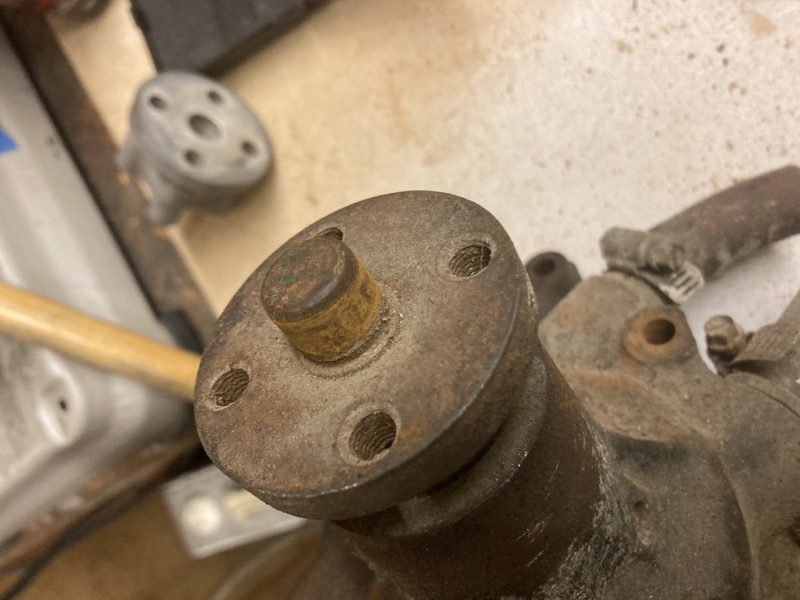

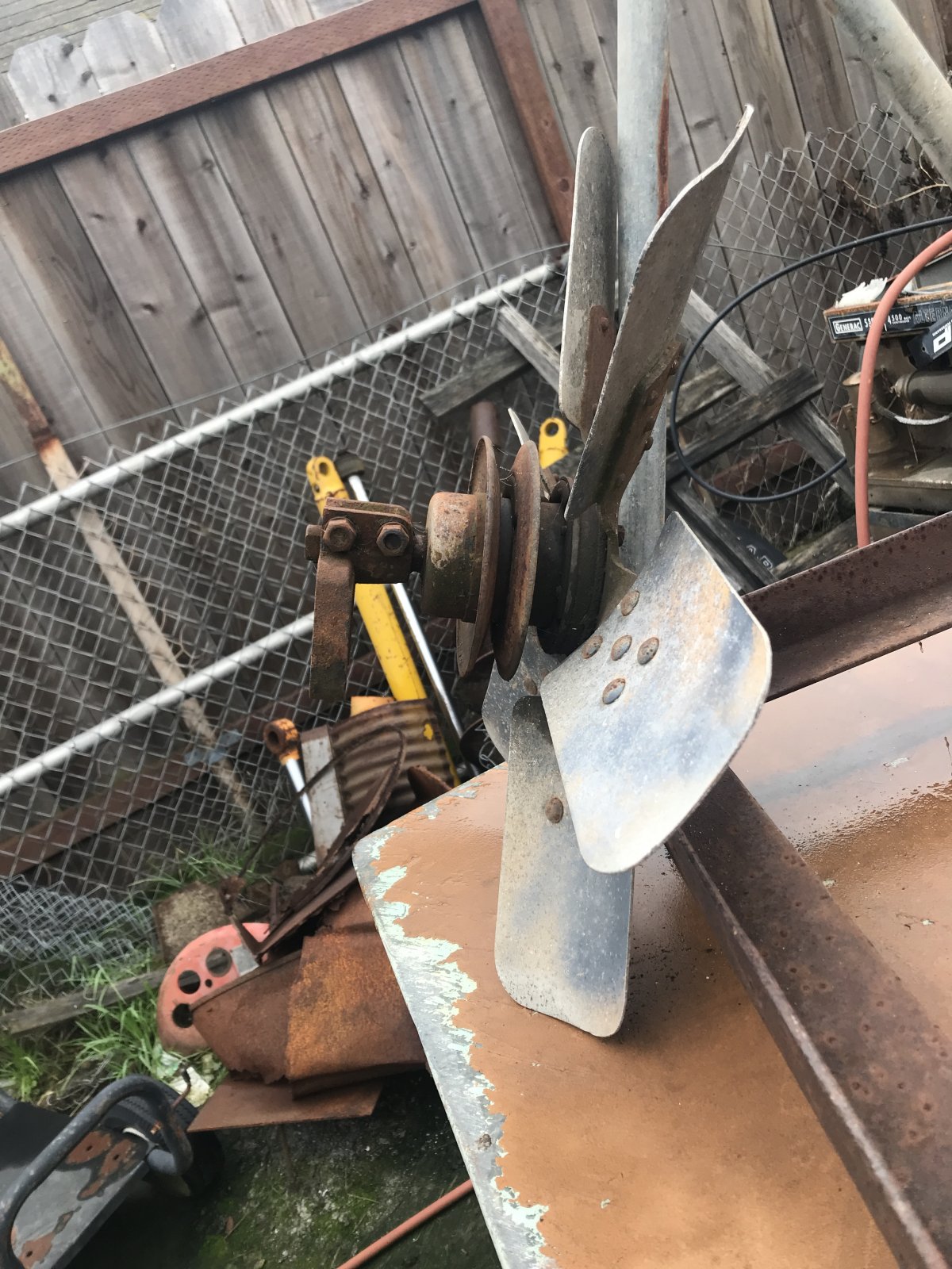

    Thanks for the replies. I cant use the stock fan or set up or even just change the fan because it sticks out too far. An electric fan is last resort. I feel there must be a way, although I am beginning to lose hope.
    My thought was to use the original bracket that holds the original fan to the engine. Have a new 5/8" shaft milled to fit into that bracket.
    Then get a 6" +/- idler pulley with a 3/8" grove, to take the place of the original fan pulley. Here shaft size does not matter as the machine shop can adjust the diameter. I have found smaller idler pulleys, but that will speed up the fan and i dont think that is good.
    This elusive idler pulley would then be the the limiting factor on how much room i have between it and the stock radiator position. This would give me 2 7/8" of space.
    The machine shop would remove the hub off a 1975 f100 water pump and press it on to the new shaft at a position where the new blade would not hit the idler pully belt or the radiator.
    The new fan is a 16" mustang fan that is 1 7/8 +/- deep.
    Because the flat mounting surface of the fan is centered "more or less" in the 1 7/8" depth, the hub could be placed in an exact position to give me 1/2" from the fan to the radiator and 1/2" from the fan to the belts or something like that.
    So a 6" pulley does not help me because it does not have a bearing.
    I found an idler pulley from TERRE, but it was for a John Deer compact tractor part, so i dismissed it.
    JOHN DEERE TCA17540 V-GROOVE IDLER PULLEY - 6'' DIA.- 3/4'' BORE - STEEL.
    This is my thinking. All work done by a machine shop. I dont think this is being unsafe. I believe it is safe an have had no indication from the machinist that it is not safe. If it cant be done then i will go electric. But i have to give it a try. I have put a lot of time and thought into this, but am not opposed to the electric if it must be that way.
    Thanks again for the help. all replies and criticism welcome

    I need a pulley, with a bearing inside, and the ability to connect a fan to the pulley. Otherwise my fan would not spin.

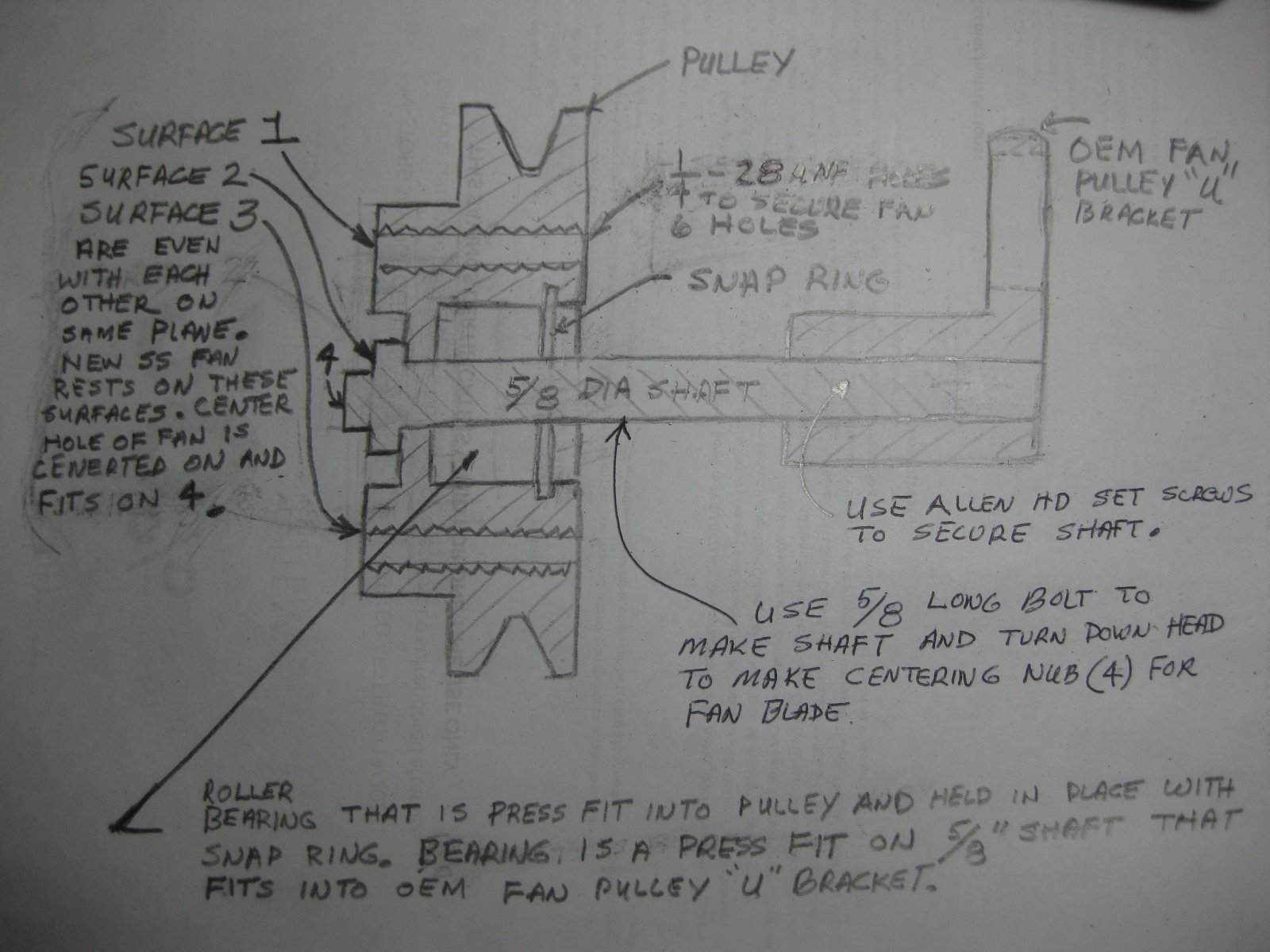

    To do what you are trying to do does require a pulley with a bearing installed so that the pulley can spin. I finally made my own fan pulley out of a chunk of 6061 aluminum. My fan is bolted to the aluminum pulley. The bearing rides on a new 5/8 in shaft I made using a long 5/8 in. dia bolt. I knurled the 5/8 dia. bolt and then pressed on the bearing for a good tight fit. Use the biggest sealed bearing possible to handle the load. I used two sealed bearings inside the pulley. You could also use a 3/4 in bolt and turn it down to 5/8 inch. The head of the bolt is turned down to make the surface numbered 4 for centering the new stainless flex fan fan. I did not want to use a 50 year old fan. I no longer have access to a lathe so those days are gone.
    However, if you know a person with a lathe or a good machinist, he could make you a new pulley
    with a roller bearing that would accept a 5/8 inch shaft. The bearing would press into the puilley and be held in place with a snap ring. A 5/8 in. dia. shaft would be a press fit thru the bearing and the pulley would spin freely on the shaft. You could make your own shaft or use 5/8 dia. machine bolt with a long shank. That's what I used 20 years ago and it still spins fine. I made wide belt pulley (including fan spacers) as shown.
    Here is a sketch I made for you this afternoon (1/15/22) of this idea. Talk it over with your machinist for more recommendations. Hope it helps. It would be better to use 1/4-28 UNC threads on the aluminum. More holding power and less chance of stripping the threads. Use BLUE Loc***e on the bolts also. In my sketch, I said to make 6 holes in the aluminum pulley to attach your fan. Better idea is to make the number of threaded holes based on the number of holes in your fan to get the correct spacing. Best of luck in you "fan" adventure. Be patient and push forward.
