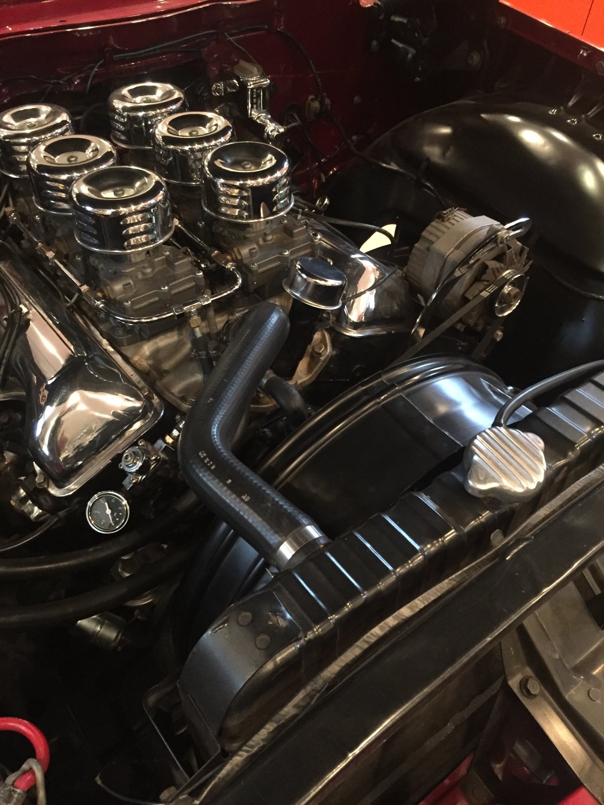

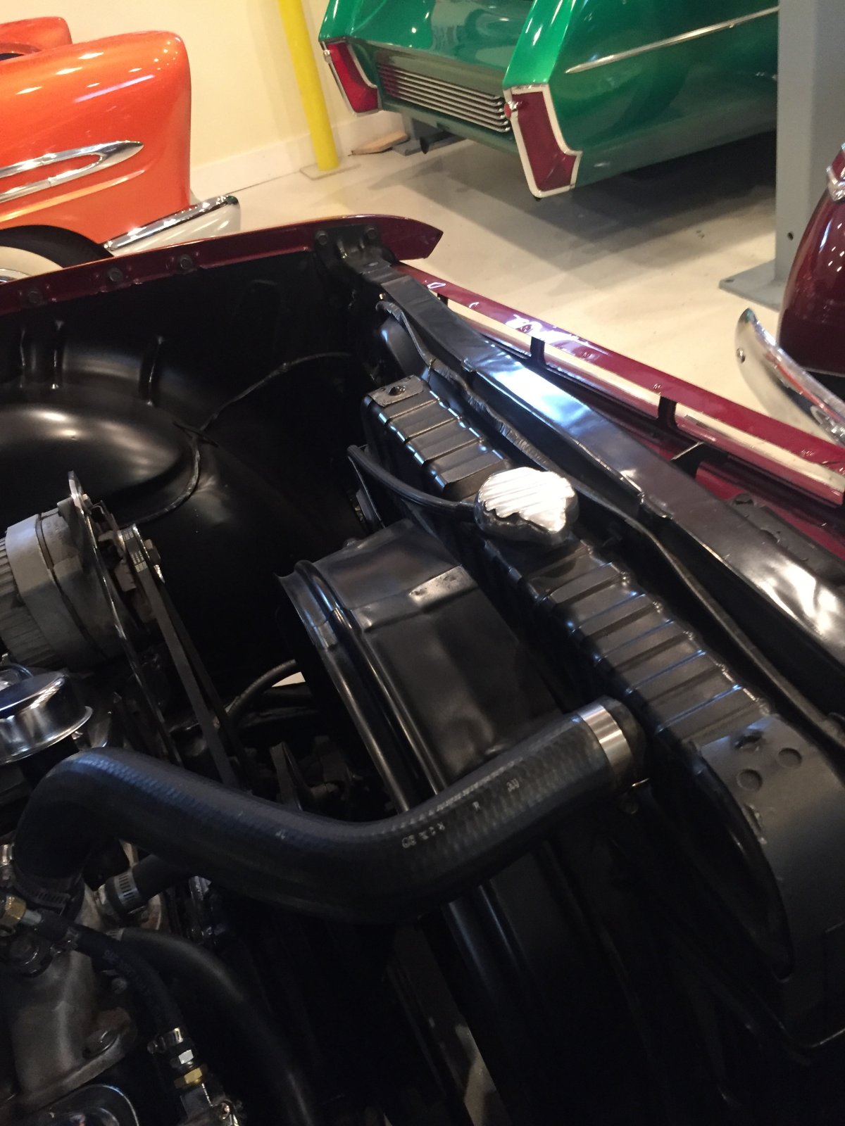

    Yeah the steel one works great. What is nasty about it?
    7244BD39-AD93-4B5C-88F0-47D968F45199.jpeg 5FDB124F-C48B-4B2B-B1D3-555534C3E684.jpeg

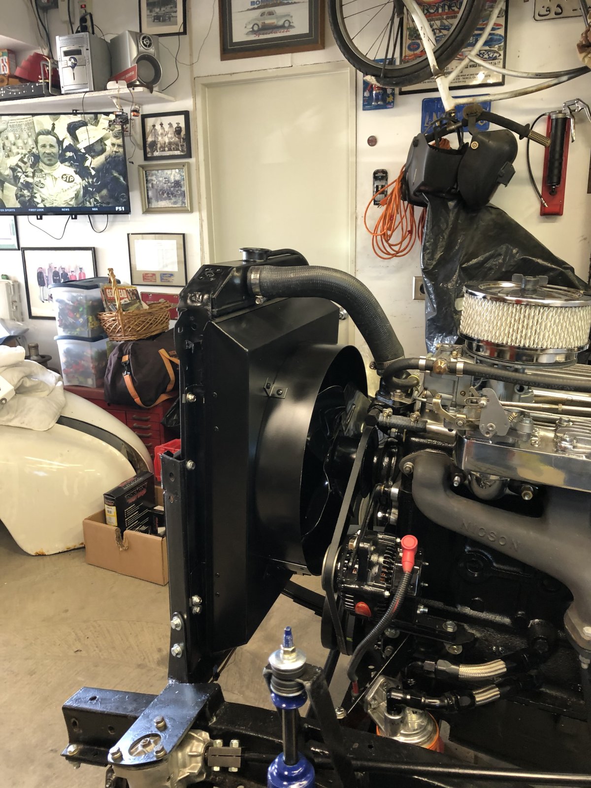

    Speedway sell a shroud kit for circle track use made of aluminum. I used 2 one mounted vertical, which I show, and one horizontal on our OT dirt track Super Stock. It works off the measurements of the radiator core and could be easily welded and polished rather than bolted if that’s what you are looking for. IMG_2895.jpeg
