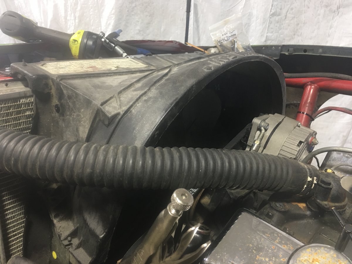

    I’m working on a project that’s got a tight budget, a deadline, and fan that’s pretty deep in the shroud. I’m Working with supplied parts and I honestly don’t know if it’s going to be a major issue or not.
    Finding or making a shorter shroud is gonna blow both the budget and deadline.
    dana barlow likes this.
  3. I'd try it as is. As long as the fan is not so deep into the shroud that air can pass around it, should work.
    Maybe not optimum, but.....
    Got any pics?

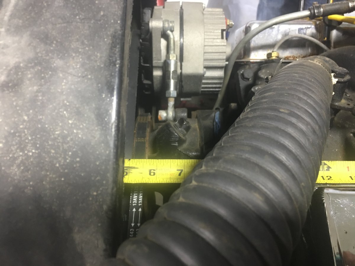

  5. There is more wrong in the second photo than blade placement. The shroud doesn't even cover the entire radiator.
    You say it's not your problem? I say it's not your worry.

    That shroud swallows up the whole fan. 5" isn't just a little bit in, it's all the way in. I'd say the shroud isn't going to be doing any good at all (but I'm no aeronautical engineer).

  11. Agreed after seeing the pics.....that shroud isn't doing much good, if any.

    Shit can that shroud. It's worthless in your application. Get one made that actually covers the entire radiator. Than, after buying the correct one for your vehicle or having one custom fabricated, you need to ask yourself if you are using a long or short mechanical water pump. Then if need be, eliminate the mechanical fan and install a puller electric fan.
    To further complicate things and make your head hurt more, take into the consideration the fan itself. How many blades does it have? What are the pitch of said blades? What is the length of each blade? You can't use a Pinto fan on a big block motor! Get my drift?
