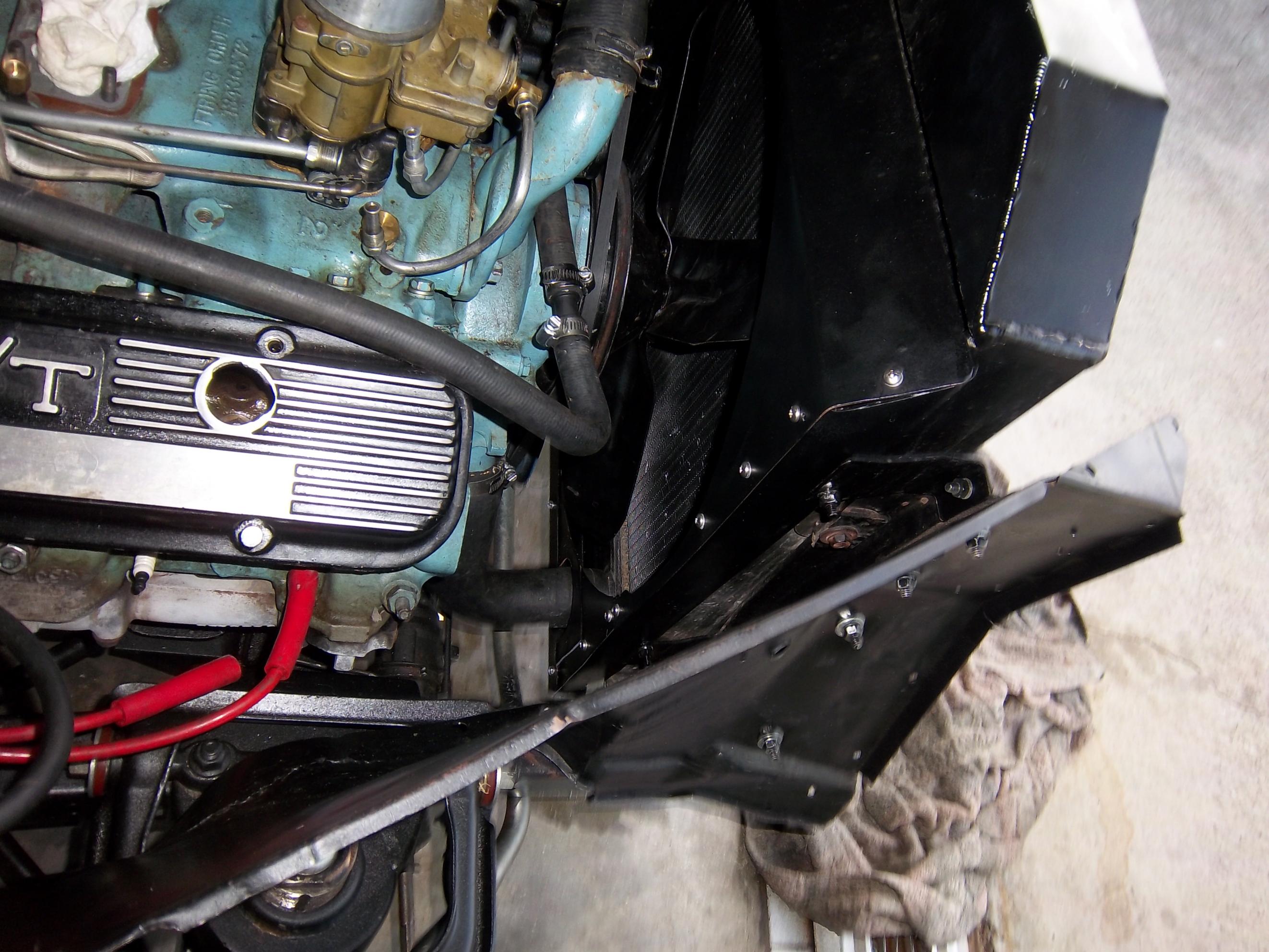

    Here is mine ,a lot like the sketch.

    Here's mine, made out of the top of a galvanized garbage can. It's open at the bottom by about 9," but it cools the sbc just fine. I recently started driving it in some pretty hot weather & it hasn't gotten over 180. I know I should have sealed off the corners, but I took a chance. Also, I've heard it said here that the fan should actually not be completely covered by the shroud (depth wise) like mine is. Apparently (in theory) the shroud should only cover about two thirds of the fan depth. I only found this out after I covered the whole thing. But again, I guess I got lucky. The nice part about having an open bottom is that the shroud can be removed if necessary.
