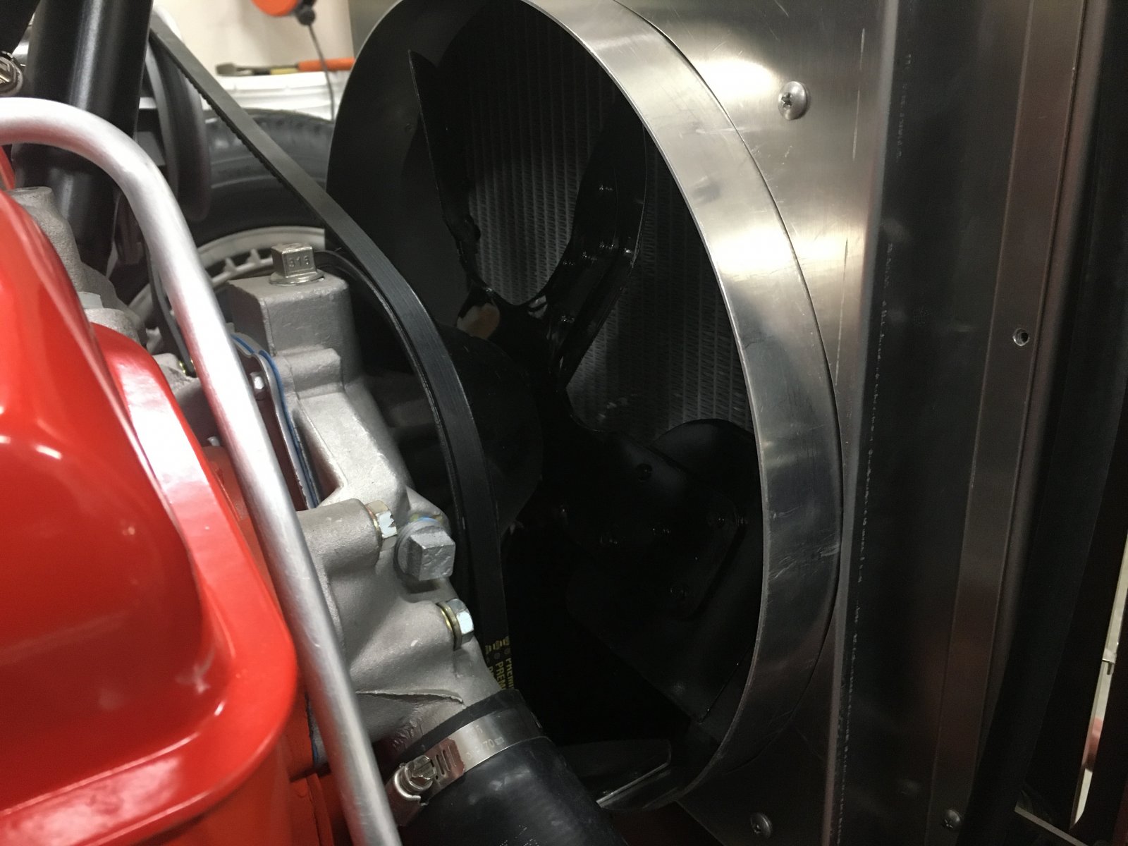

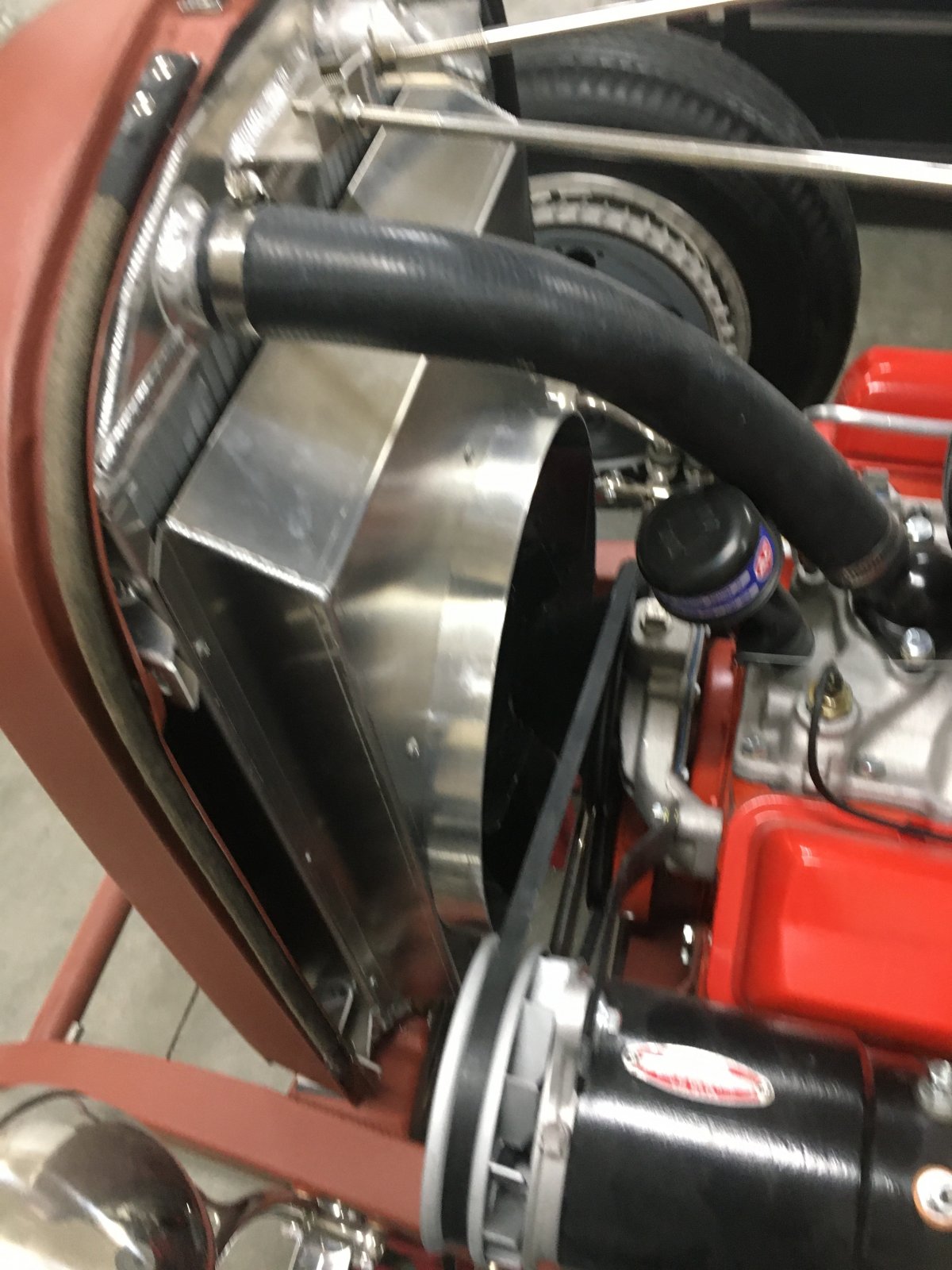

    2F80E880-1B06-44A6-A0C6-2BCE08DC1619.jpeg C1E065E8-5EE0-497E-A9EB-465B751C3B11.jpeg Put a shroud kit on my coupe. Needed a 13” fan. Took my 15” Chevy six blade and cut an inch off each blade. Cleaned it up and used my bubble balancer to balance it up! Works great!
