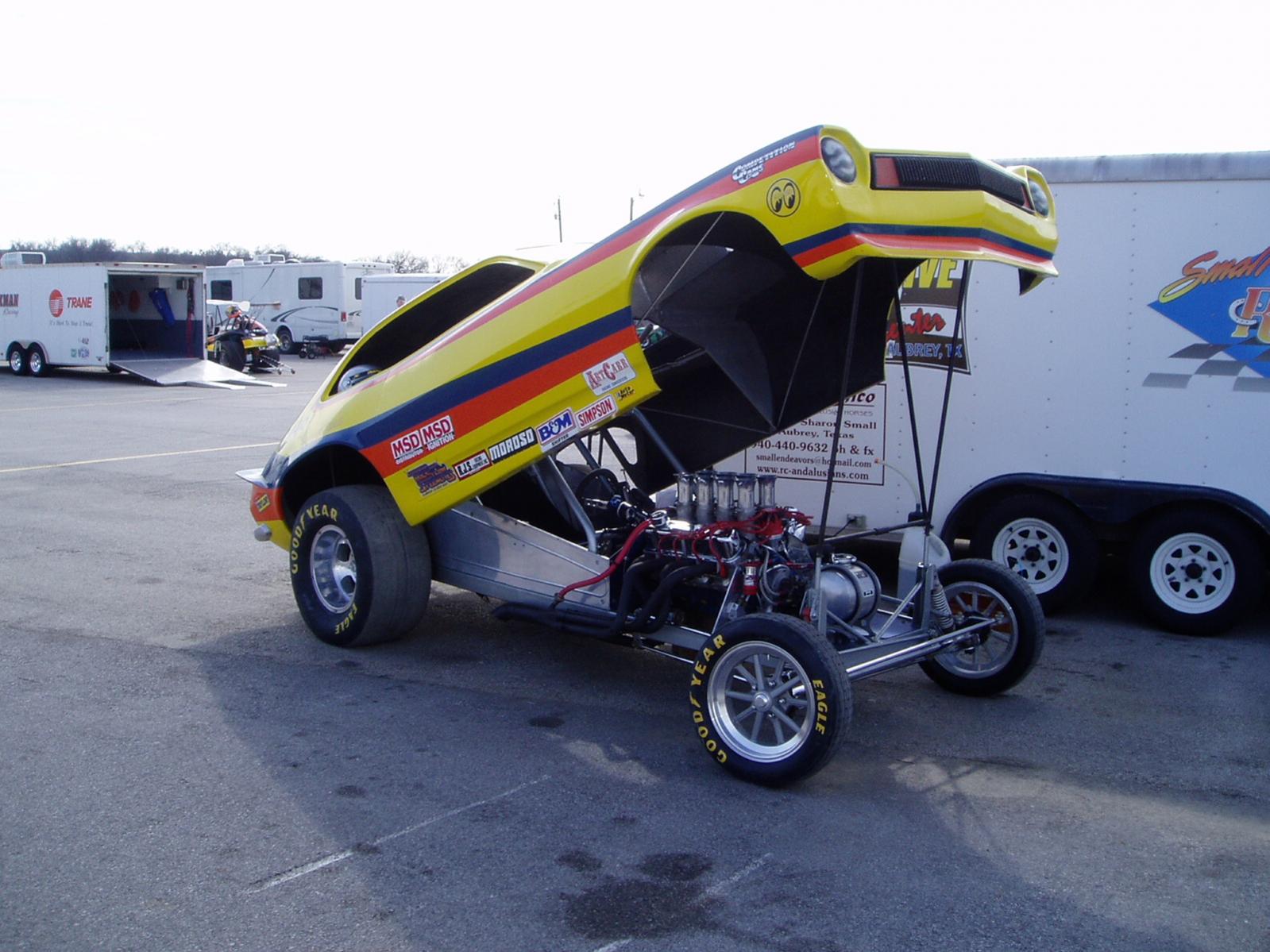

    There was an Econo F/C circuit on the west coast that ran cars like this as well.
    This Pinto was at Denton a few years ago and that's where it came from.

    HEY, I owned that Pinto a couple years ago!

  19. Junior Stock
    Joined: Aug 24, 2004
    Posts: 1,949
    Junior Stock
    Cool.
    Took that picture in '05. Guy told me it came out of California.
    Did you own it before or after this?

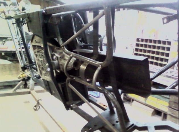

    now that is is all apart I am working on the chassis for saftey updates. new bars under the seat area today where it was jus wide open?? and built all 4 new bars for the rear 4 link, it had all solid ends now has new heim ends like it should and I will have to rebuild the attachment points in double shear instead of a single plate mt. but it is going quite well, here it is on the rotisserie ..:cool:
