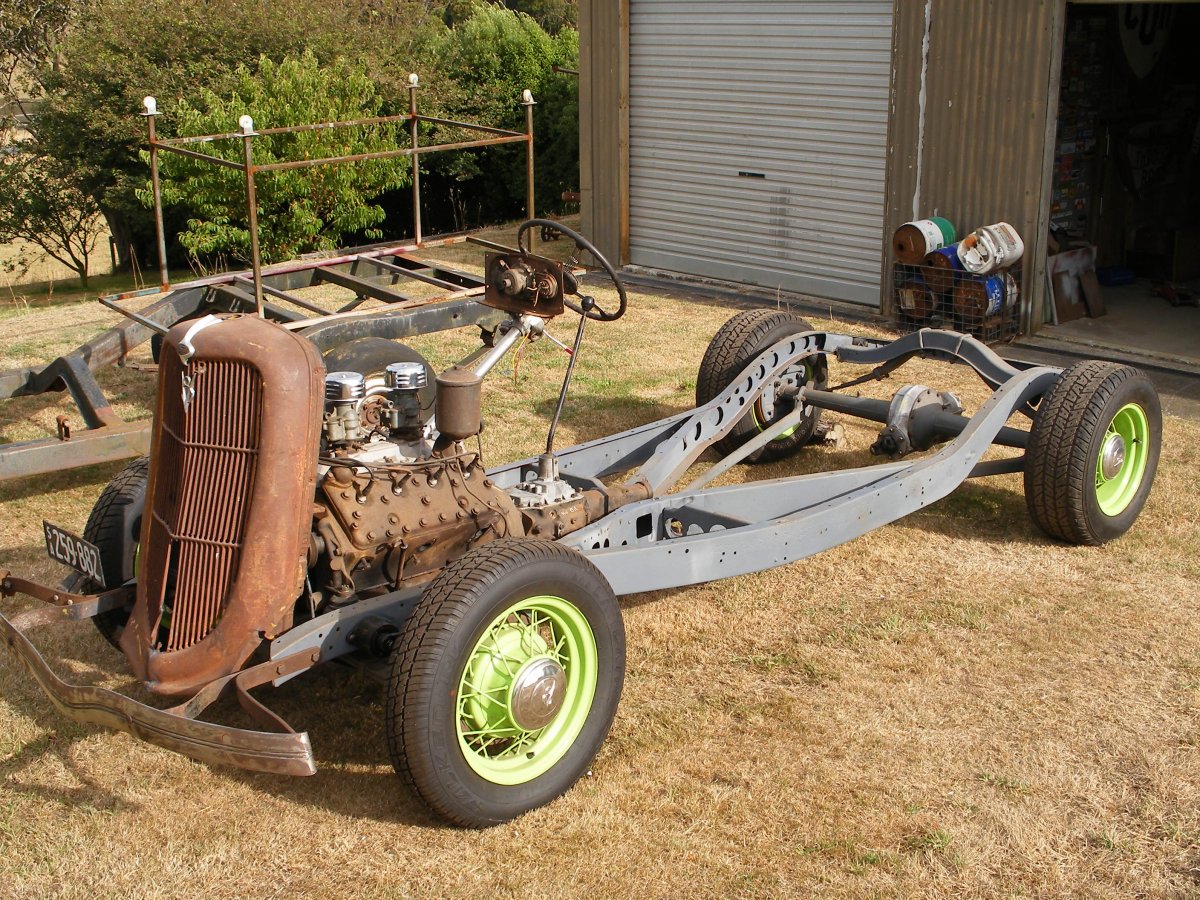

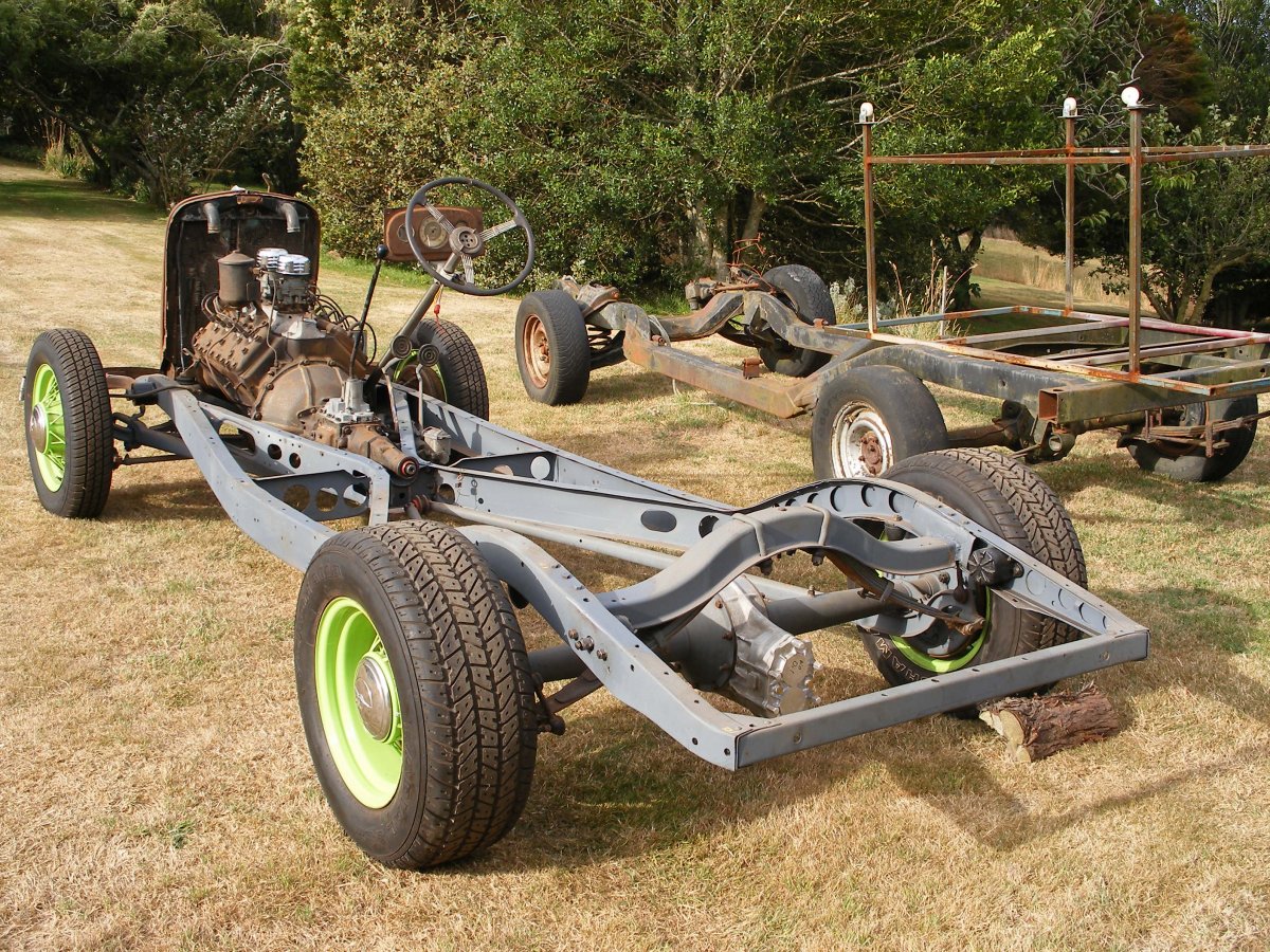

    This is how I did it...........

    Nice job 28rp.

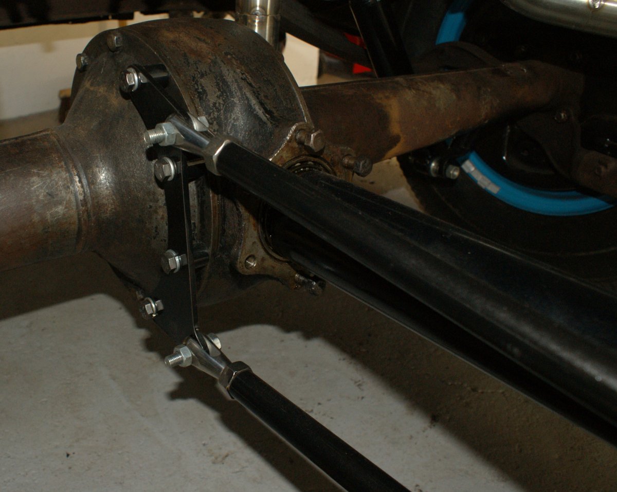

    This how we did it on my 36, A little more then stock 20170226_131006.jpg 20170226_131111.jpg

    Pretty cool torsion bar set up Zorro

    Sure do JB-Bruce lives about five hours drive from me,he has been retired for some time and not doing too much hot rodding now.

    Thanks for the comments No Respect-I have added an adjustable top link from the Q/C almost to the front pivot point to stop "winding up" the 35 radius rods since these photos were taken some time ago.The ch***is is going under my 35 Pickup using a stakebed tray,so no floor clearance problems.The fueltank is to be mounted forward of the rear end behind the cab.

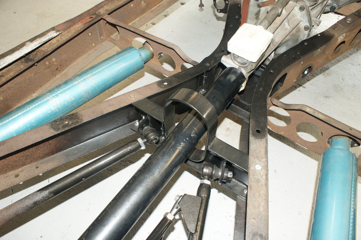

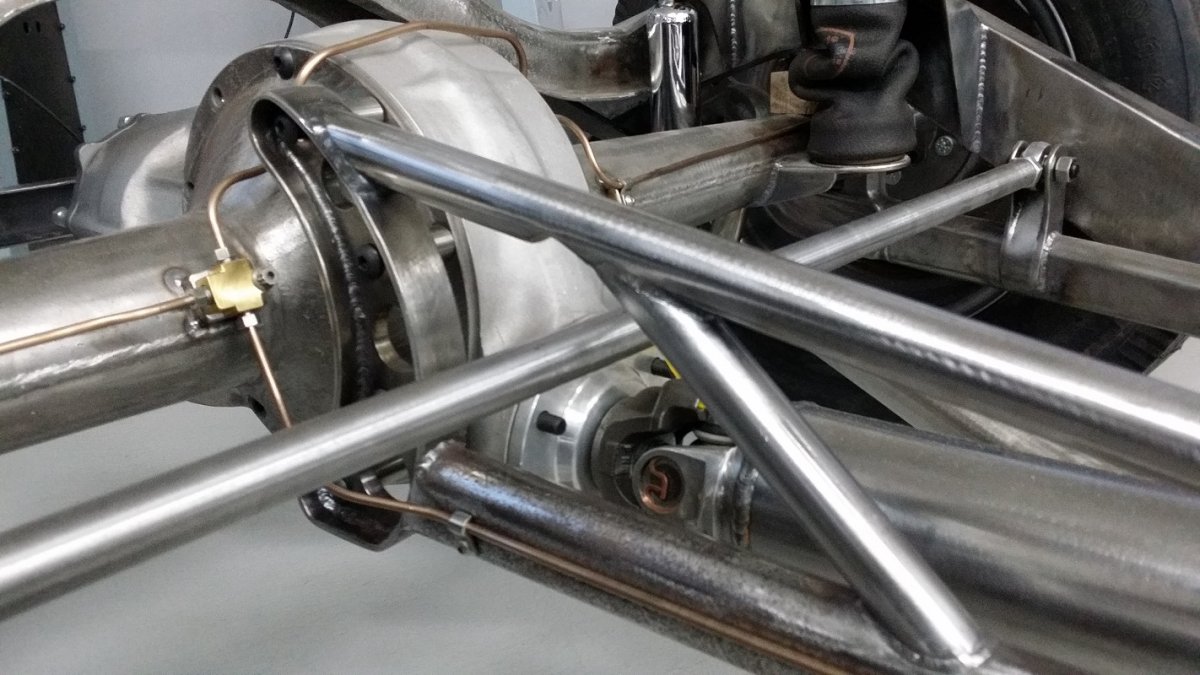

    Probably a lot lower than you need to go, but this is the setup going under my '36 3-window. The bags are only there for adjustability - the weight is taken by an 'A' spring minus a few leaves. Should give you an idea of the relative positioning of things tho'.
    Bear:)

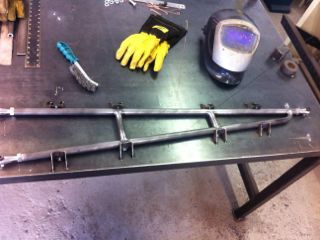

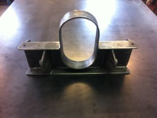

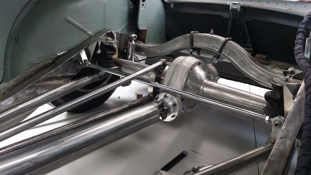

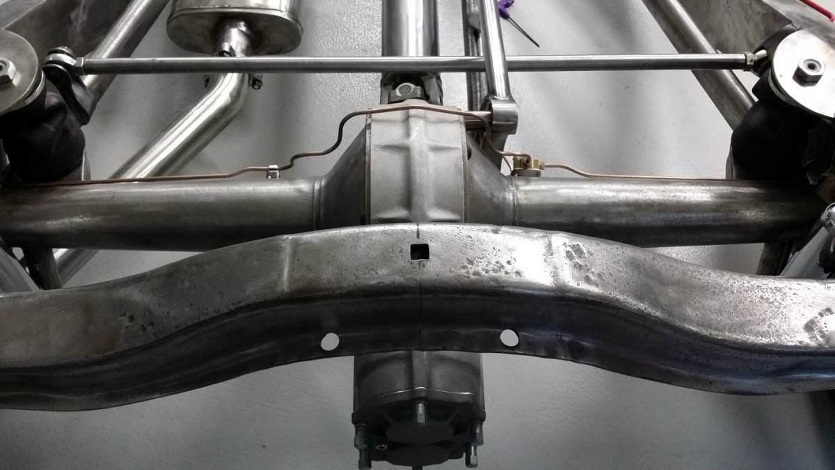

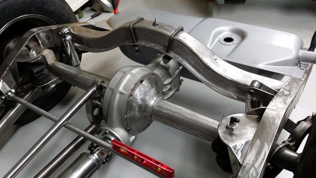

    This is how Marco at Jaurez Fabrication modified my rear end setup in my 40 in preparation for a V8 quickie. Model A/40 rear crossmember compilation, A spring, split wishbone and 'torque bar'.
