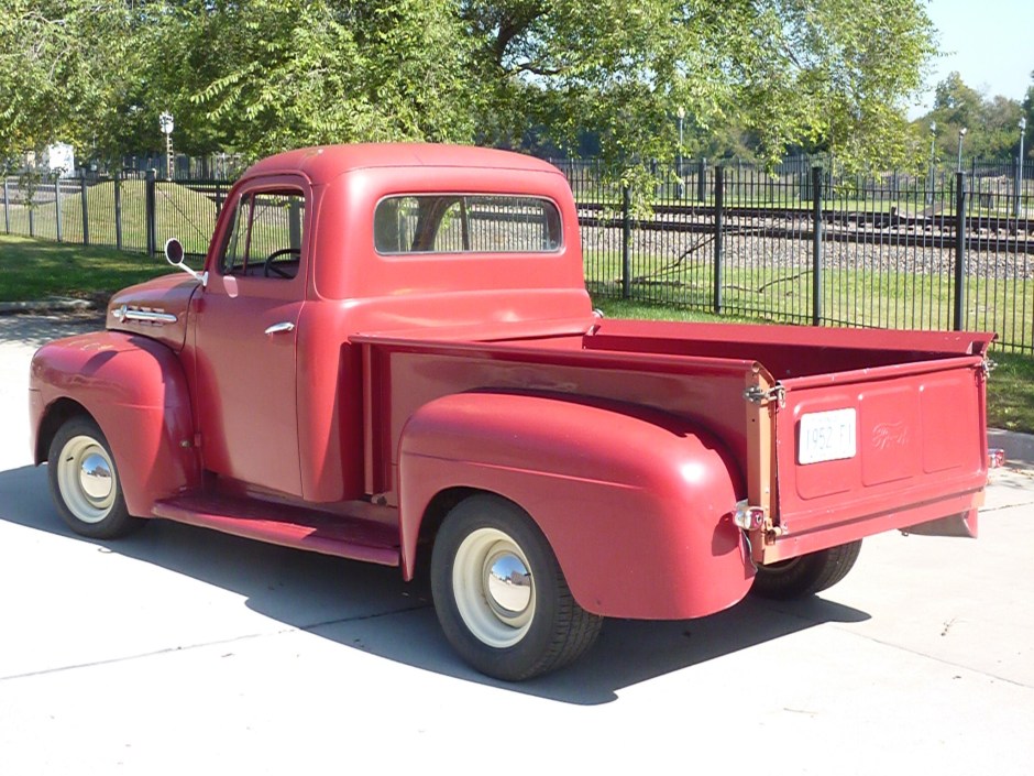

    Here it is as I bought it with 15" x 6" wheels all around. Great truck but the "too wide" Mopar 12 bolt rear end in it bothered me. I wanted a wider/fatter rear tire/wheel combo but the sidewall of the tires had no more room to the fender. Ok, I could go with deeper back-spacing but I like the look of a deeper wheel as viewed from the curb side.
    So out came the 65" wide Mopar rear and in went a 61" wide 9 inch Ford from a '72 F100. Much more appropriate rear end anyway, right? Now I'm ready to order wheels and I'm thinking 8" wide but do I want 15" or 16"? Not sure yet. 51 psf.jpg

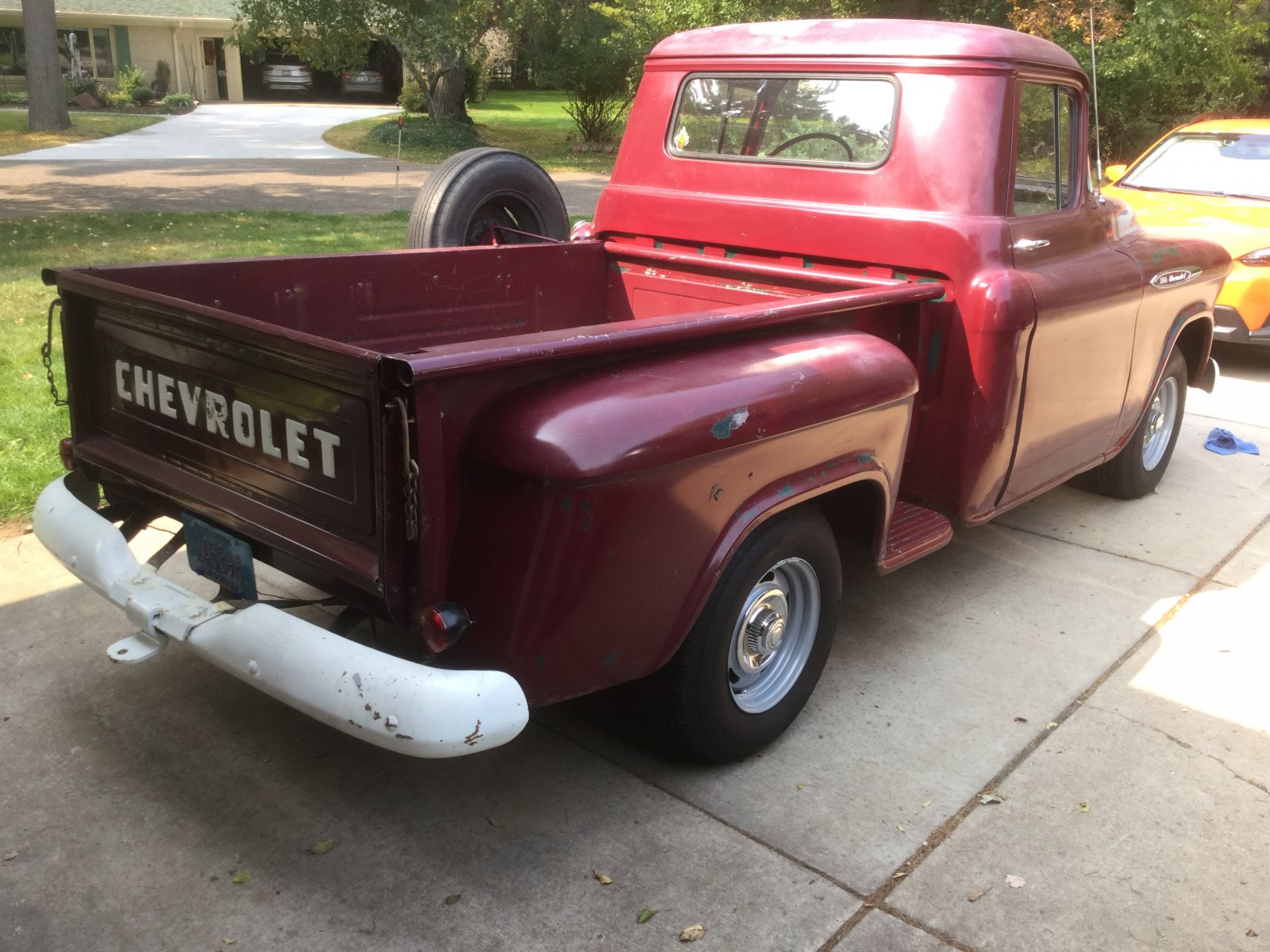

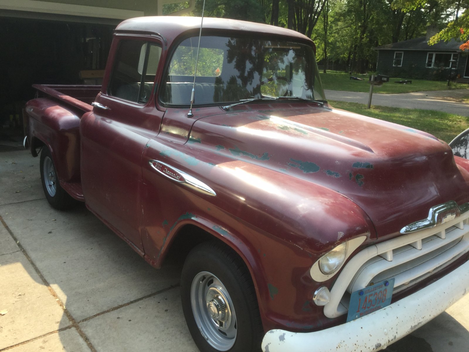

    those tires and wheels don't fill the fenders. ick

    Love the Advance Design Chevys @ratrod0

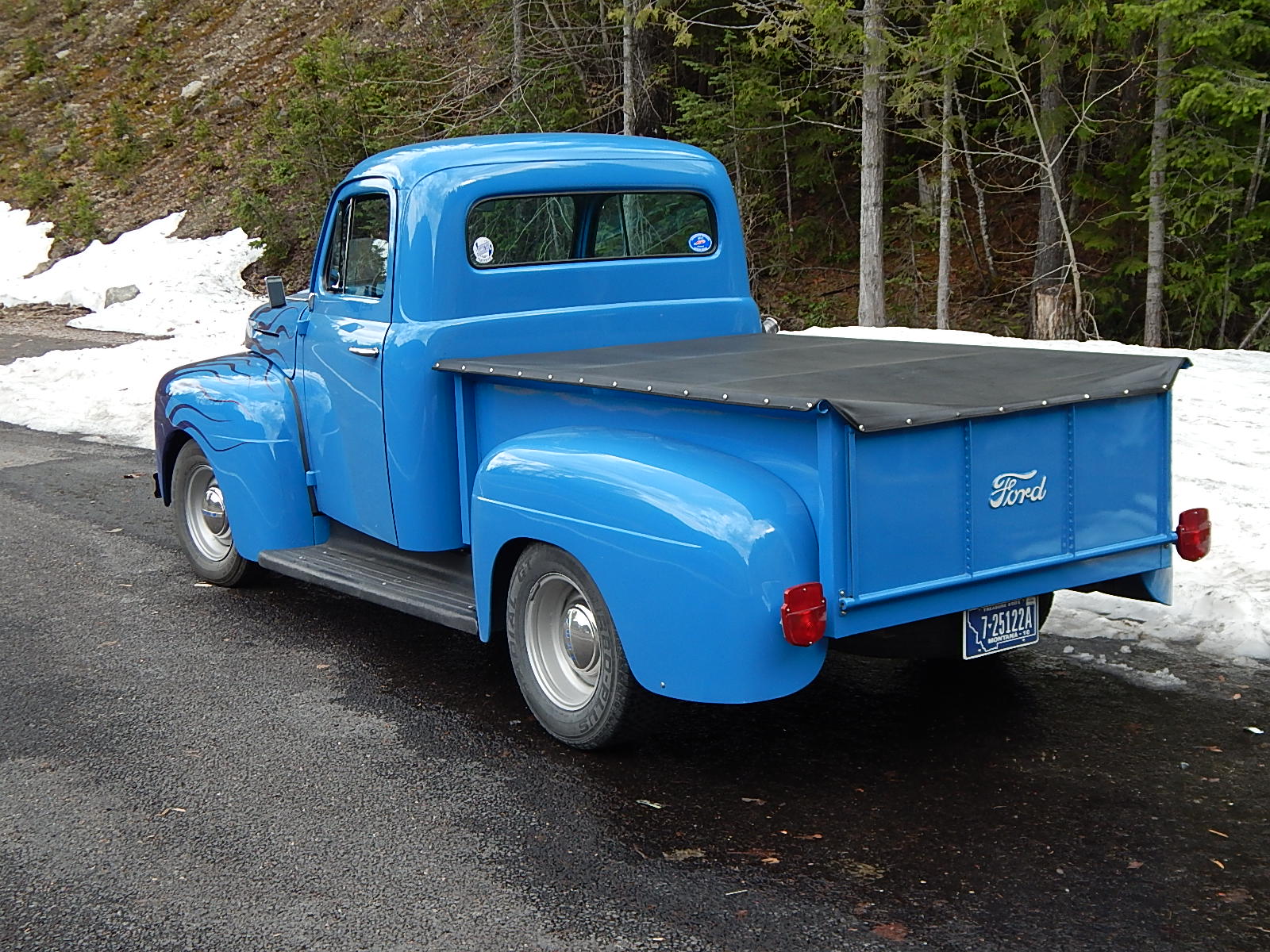

    15x5 front and 15x8 rear

    Perfect!!
