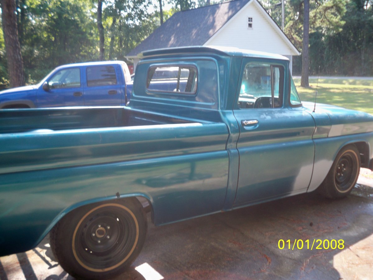

  3. I have built a couple of the early C10's over the years, my first was a '62 short bed stepside that my Dad and I did. We swapped out the drive train (350/4 spd) from a wrecked Nova SS. That was back in the mid 70's. Second was a '63 short wide bed that I did a few years ago. I also did the crossmember swap with 2" drop spindles and 2" drop springs, I used 90 something Jeep Wrangler springs in back. I put a 250 inline with a S10 T5 transmission in it. It was a fun little truck!
    Have fun with the Father/Son project. I'll be looking for it at the SK500!

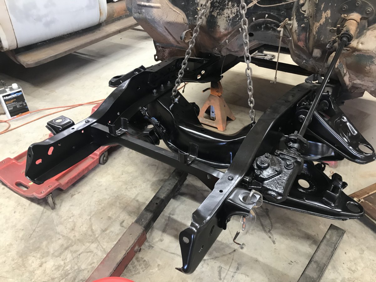

    Got a little done tonight, but never as much as planned.

    Got the crossmember back in and cleaned up the springs and spindles getting them ready for paint. Just like I have read, we had to drill one hole in each side through the frame and also had to oversize one hole for the later crossmember to bolt in. Hopefully, we can get the balljoints in and install the springs and spindles tomorrow. The clock is ticking to have this thing far enough along to show what has been done at Nostalgia Sid’s open house in less than 2 weeks now. He also wants to have the motor together, painted and sitting in the frame if possible. I guess we better order some tires to put on those fancy chrome wheels or it won’t roll very easy. He has decided on skinny whitewalls for that 60’s vibe.

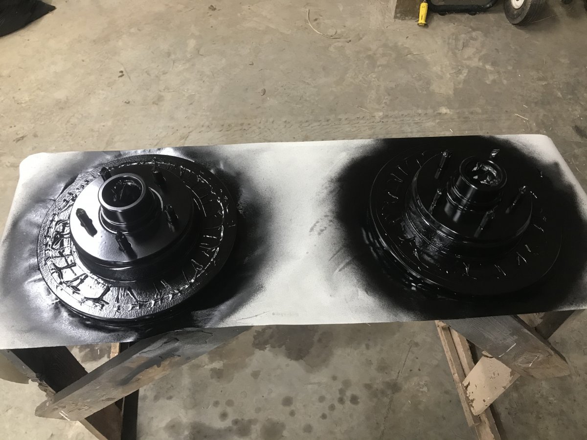

    Trying to get something done every day now. Got the spindles and springs cleaned up and painted this evening. No more blue spindles. :) Taking the intake for this motor and my other sons motor to work tomorrow to get them cleaned up some with the blast cabinet.

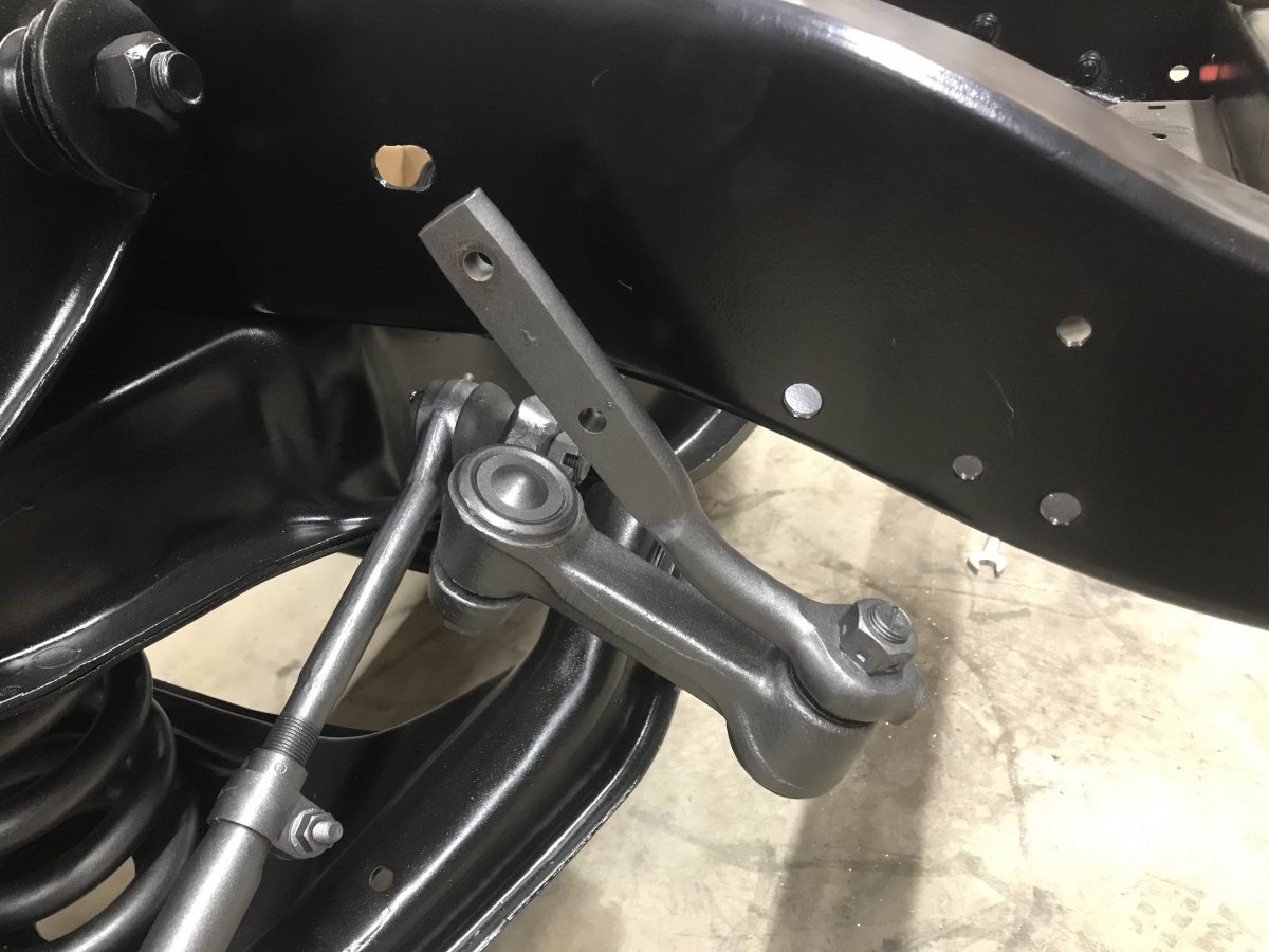

    Questioning whether all this detail work is worth it for a vehicle for a 16 year old?!?? But, almost done painting and installing parts on the front now. Tires came in today and hoping wheels show up tomorrow.
    68865054-F755-4812-AB80-6D330BB5ECE8.jpeg CFF33069-A257-4CD5-9726-1AA0F98C9C4A.jpeg
    Appears we need to locate the idler arm and drill some holes. None in the place where it needs to mount on this frame.

    Looks like you have a 67-72 idler arm. Your years should be straight up and down almost and bolt to the two wholes about 1 oclock Screenshot_20200305-202845.jpeg
