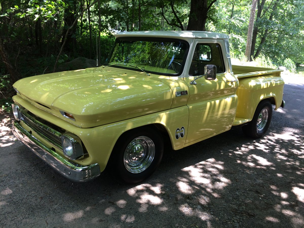

  4. edcodesign
    Joined: Mar 30, 2007
    Posts: 4,890
    edcodesign
    image.jpeg Great to see the nice job a young gun is doing. Chevy trucks rock !
