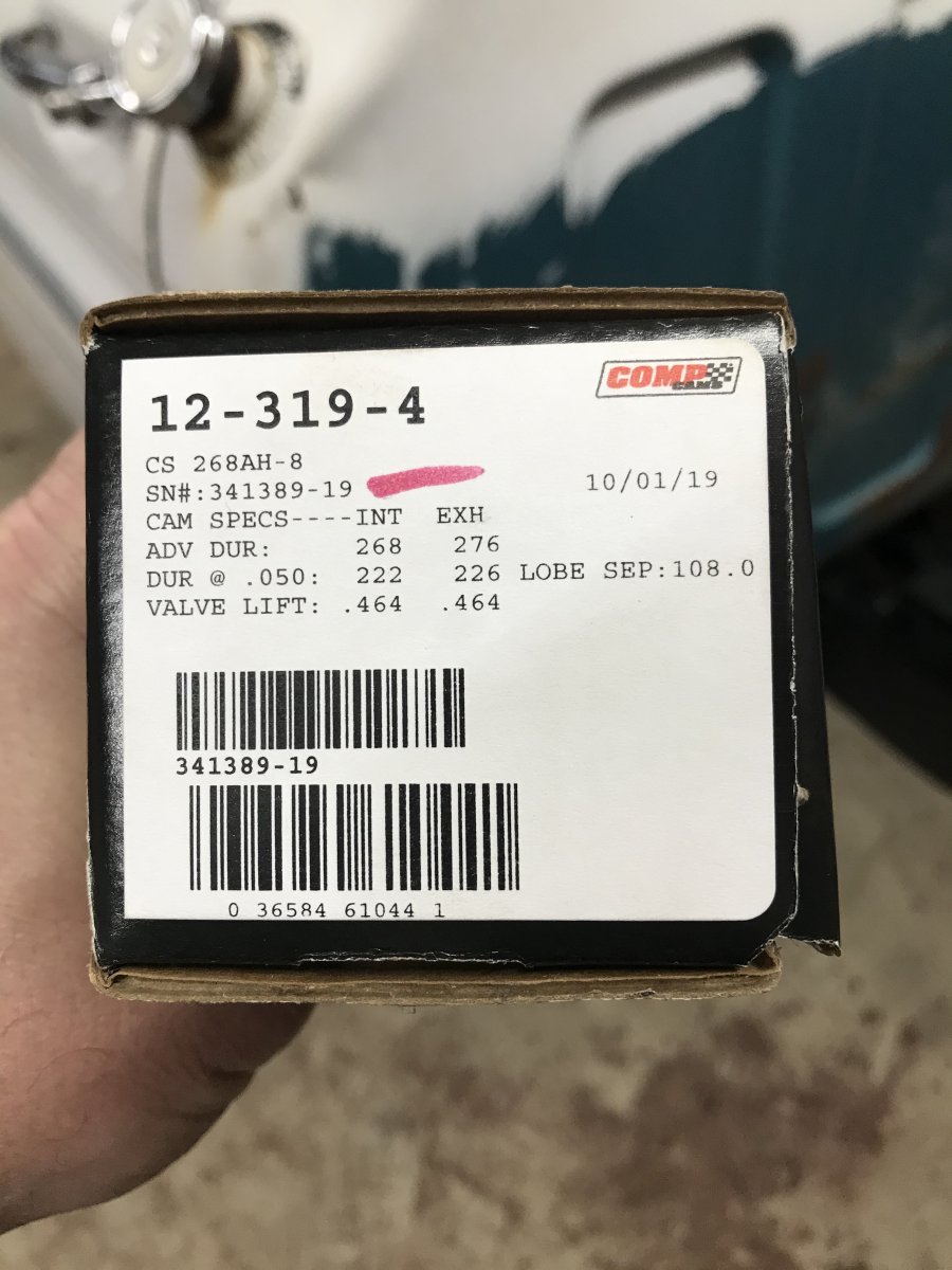

    108* lobe separation... that’ll have some chop!

    Yea, this cam was actually recommended by a mutual friend that works at Comp Cams. I know a lot of what my son is looking for is a mean sound and good power, but he also has to drive it every day. This was a specialty cam that I think should work well for what he needs and sound plenty rowdy.

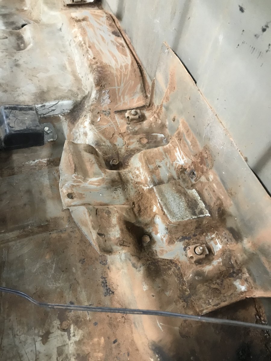

    Oh, and one pic, since we know posts with pics are way better than ones without. :) Trying to decide how much of these tank mounts/floor support to cut off since we are moving the fuel tank out. I think we will just cut off the part that bends back up and toward the front and try to make it look factory.

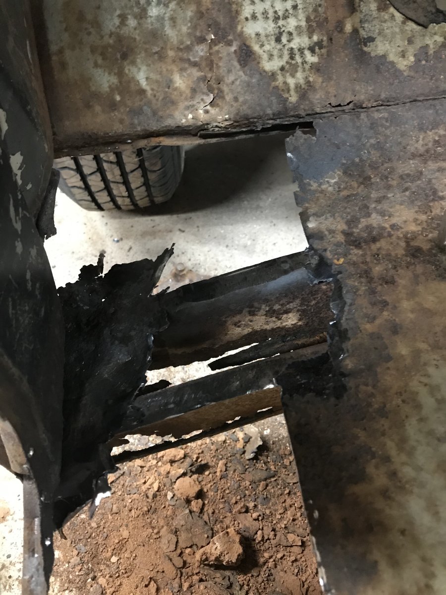

    Oh, and that one brace that looked a little rusty that I mentioned previously was a lot worse than it looked. It pretty much fell apart as I was using the air hammer to knock out some of the floor we had cut. Trying to decide whether to order that brace or just make as much of it as needs to be replaced. It is no wonder those braces rust out. They pretty much just fill up with dirt. Also, as you can see in this pic, we will have to make some other small patches to fix areas that still have rust beyond what the patch panel will take care of.

    I'm late to the party, but enjoying what you guys are doing. I've had more than a few C10s and other trucks along the way. The last I had was a 1965 C30 panel truck. I'm interested in finding one for myself, looked at a 1969 C10 panel truck locally for a home for a 427 build, it was pricey at $6500, but someone bought it. The good thing is that almost anything you need is available.

    The fun begins.
    Looks like pretty standard Missouri rust there for one of those trucks. I always ***umed GM packed the cab supports full of mud and leaves at the factory!:p You guys will get it tackled... one bite at a time.

    yeah there is just enough gap to get dirt in there and rot them out and its amazing how quickly a little bad spot ballons on these trucks. I'm doing a 68 C10 and the kick panels had tiny pin holes that turned into a decent patch. Oddly its the only rotten spots on the truck.
