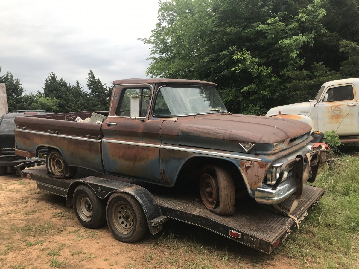

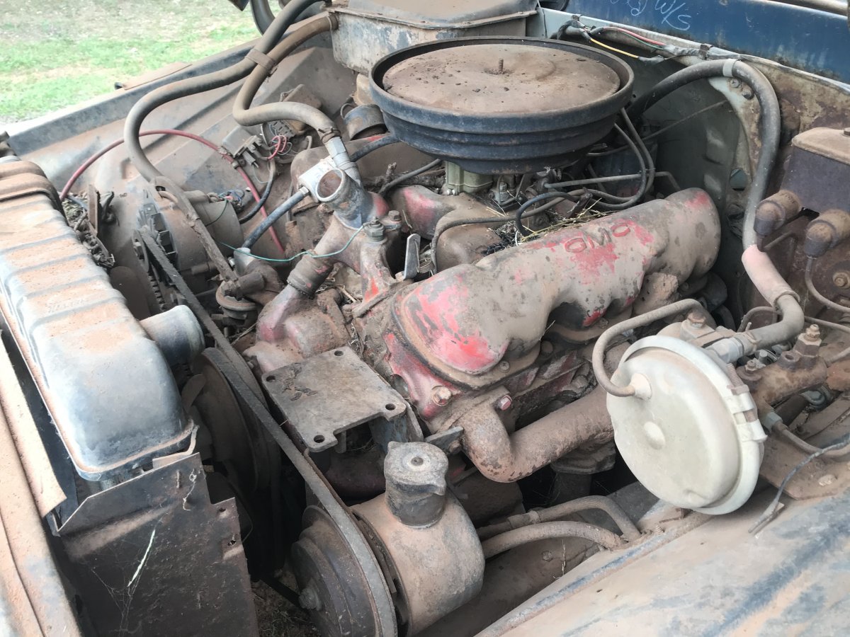

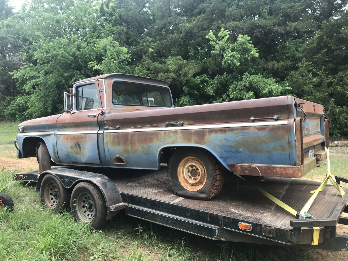

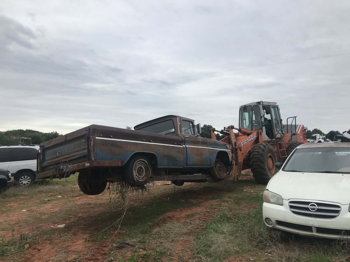

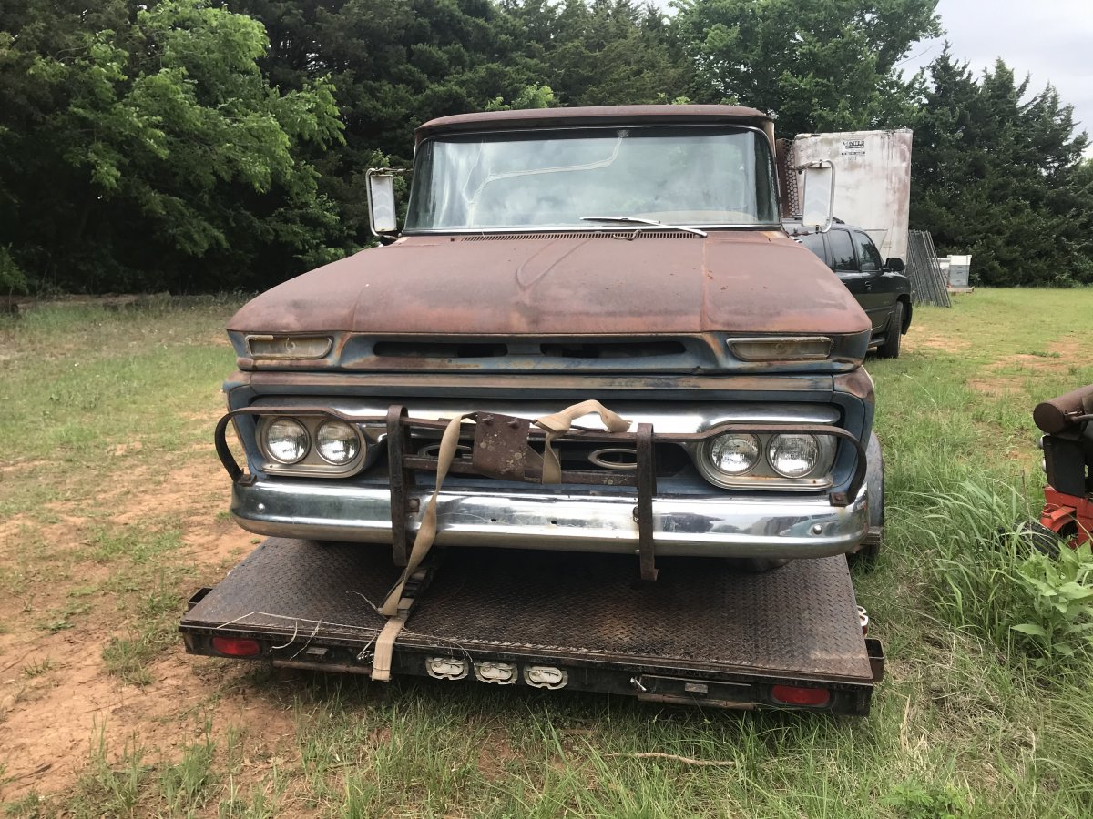

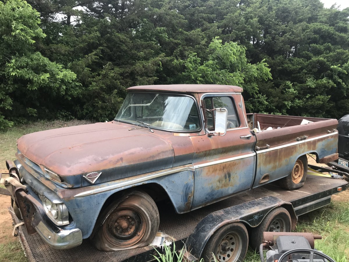

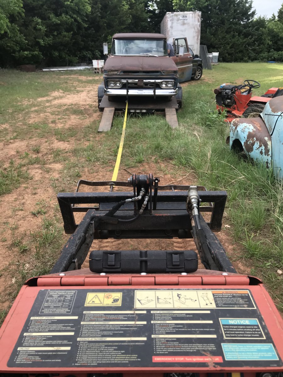

    Decided to go pick up the parts truck this afternoon. Talk about an easy way to load a vehicle with four flat tires! Anyway, not a bad old pickup overall actually. The V6 even turns over. Lots of stuff we can use and maybe we can sell a few things to recoup what we paid for it. I’m wondering about using the windshield stainless for a little different look on his. Silas says he wants to hang the grill on his bedroom wall. We will see about that...

  14. Nostrebor
    Joined: Jun 25, 2014
    Posts: 1,329
    Nostrebor
    That grill guard is nifty in an ugly sort of way. I've never seen one like it.

  15. guthriesmith
    Joined: Aug 17, 2006
    Posts: 11,907
    guthriesmith
    Heck, this thing even has power steering and looks like it did have under dash A/C. This was one fancy pu when it was new! I always hate making a vehicle into parts, but I suppose they all can’t be saved either. :(
    Oh, and my borrowed machine from work isn’t quite as strong as the one at the salvage, but also beats pushing.

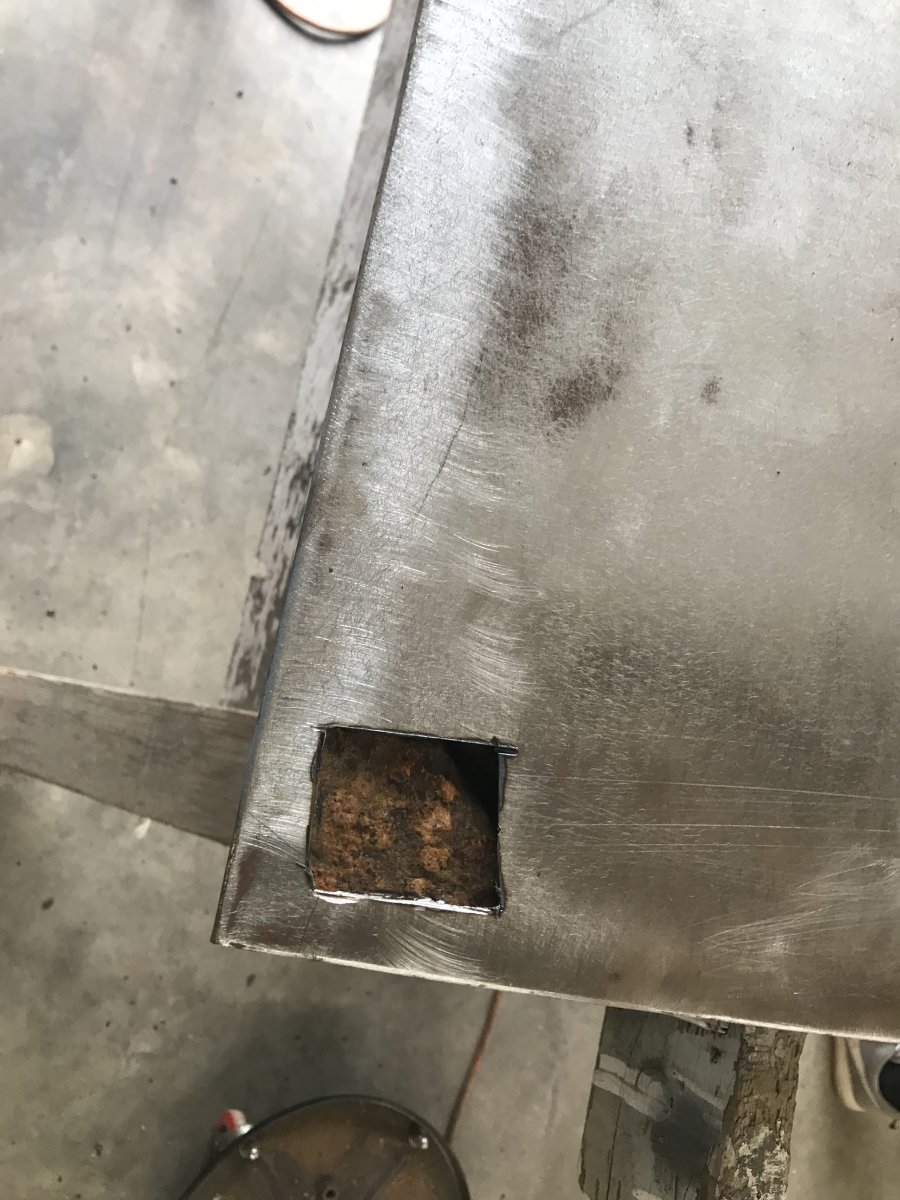

    Back to work today...finished stripping all the paint on the drivers door this evening and cut out two small areas down in the front and rear lower corners where some rust was just starting to show up. Silas was not excited about more “backing up”, but I promised him we are closer now than when it bubbles up through the nice paint in just a few years... We also started covering up my lack of metal working skills. Should be able to get this door knocked out tomorrow as well as the other one since it is in much better shape and needs no more welding. It will be motivating to both of us to get these in primer.

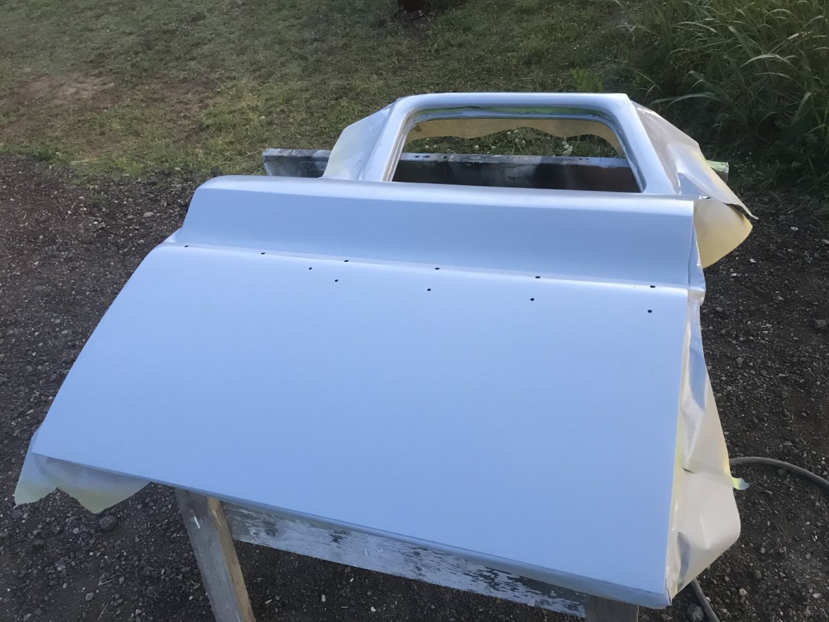

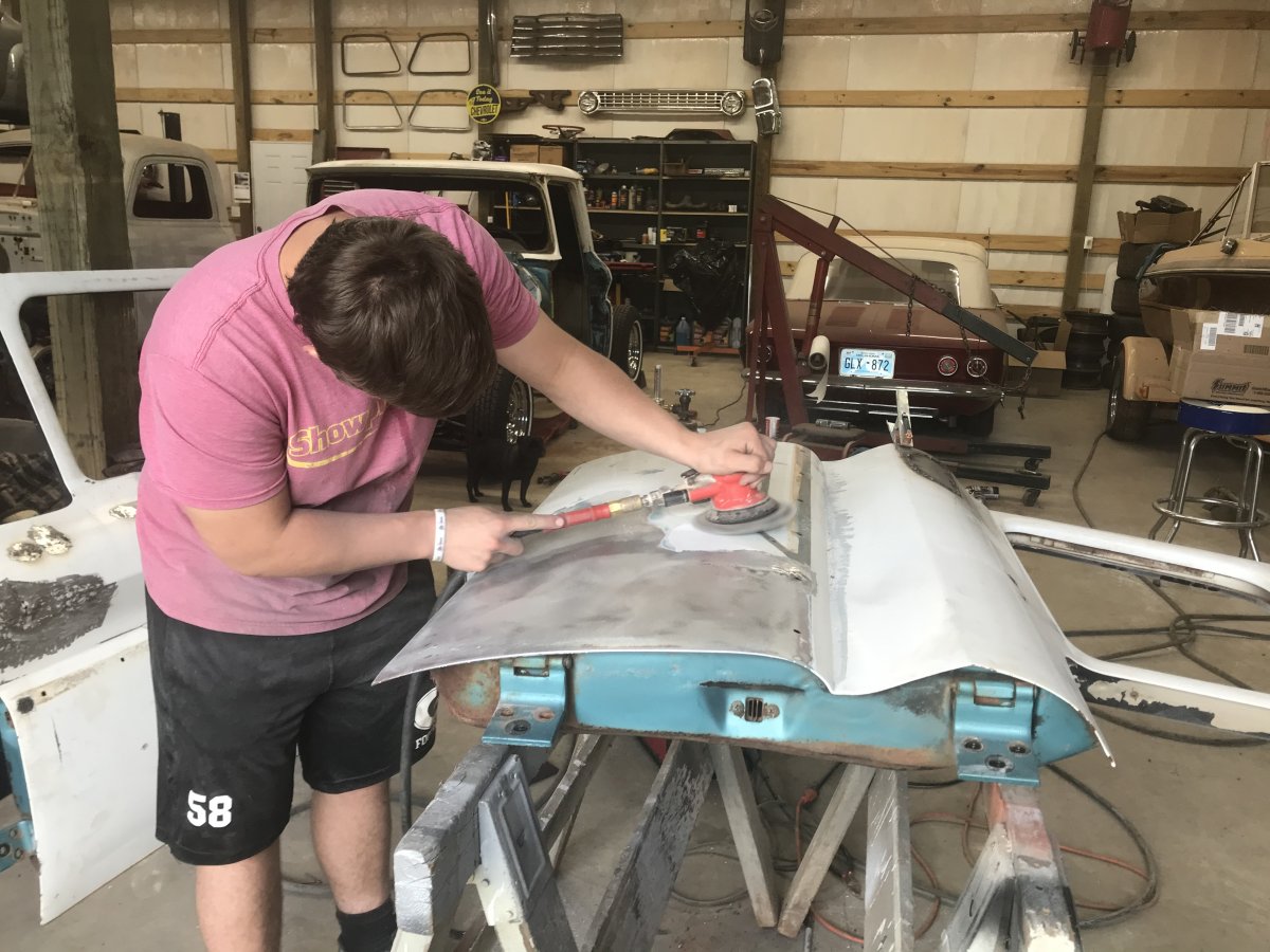

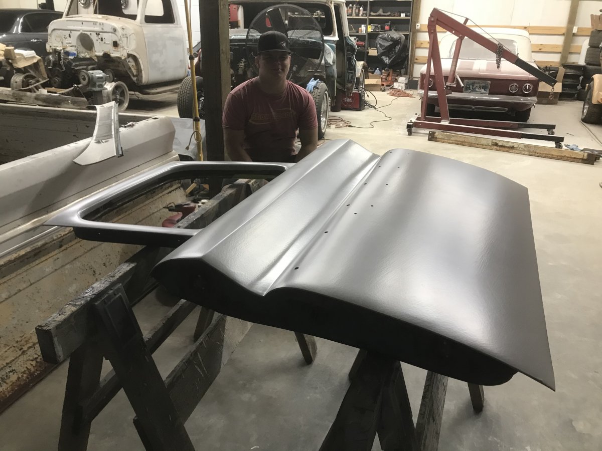

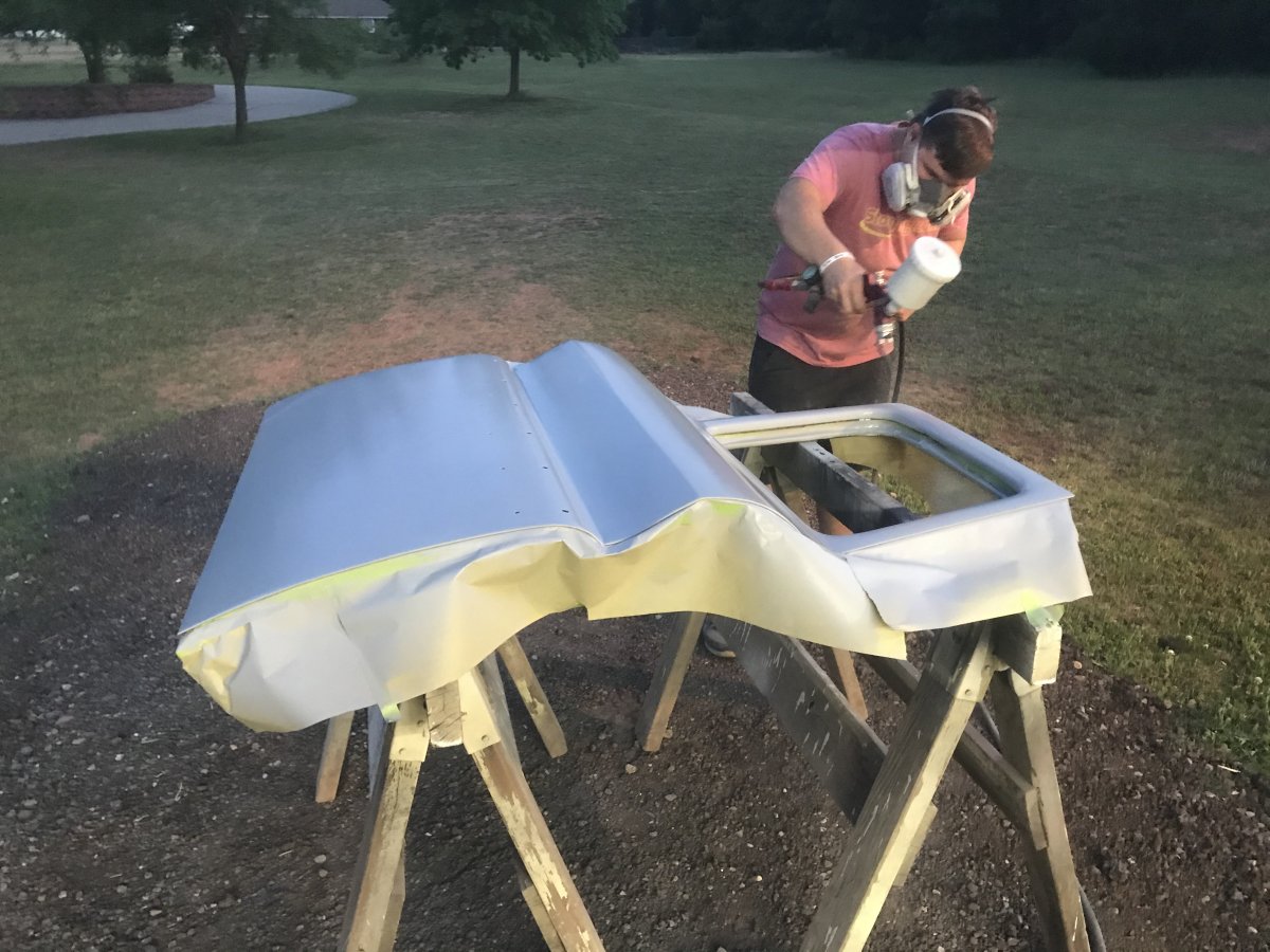

    I always have expectations of finishing more than we do. But, we did get the drivers door smoothed out and in primer. Started on bodywork on the p***enger door, but didn’t make it very far yet. It was fun teaching Silas to use the paint gun. He is willing to try anything which is good...most of the time. I also learned that after 20 years of not doing this kind of work, I am WAY out of shape when it comes to blocking. I am happy with how nice the door turned out considering how bad this one was.
    Silas is done with school now for the year, so has a list of things to do to continue progress while I am at work.

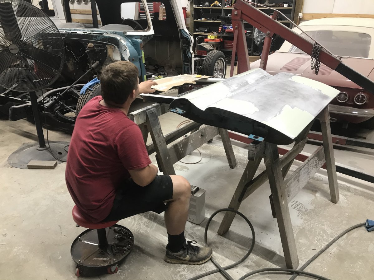

    And, a reminder of just how bad this door started out. It had the typical dent in the upper body line from the door stop failing at some point. It had a previous repair that involved drilling lots of holes in that area which later caused it to crack when the door stop apparently failed again at some point. I know this fails in comparison to some of what gets saved by some guys here, but no more than I like bodywork anymore, I think it turned out ok. Between the messed up body line, multiple mirror holes to weld up, rust, and a few other dents, it was questionable considering it isn’t that hard to find a decent door. We were at the point of almost bailing on this door at one point when I kept trying to weld up the holes and they kept blowing through since it seemed someone must have ground the area pretty thin or something.
    Now, we just need to block the filler primer and get a smoother coat of primer on it. Last night, he mentioned that he thinks he wants to run it in red oxide primer until we can get around to painting it. Not sure I am completely on board with that idea yet. but we will see if that is where we end up or if it just ends up gray or something else. Oh, also seems he decided on the original gold color for the interior sheetmetal with some pinstriping. So, now we need to get back to work on the cab too. And, he wants the firewall white which will be the color of the roof and stripe down the side.
