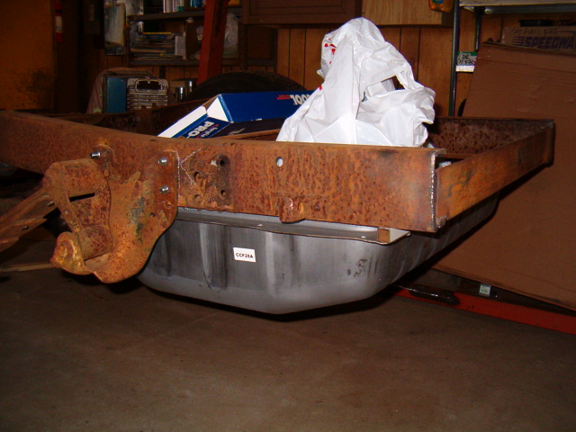

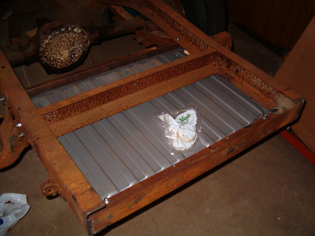

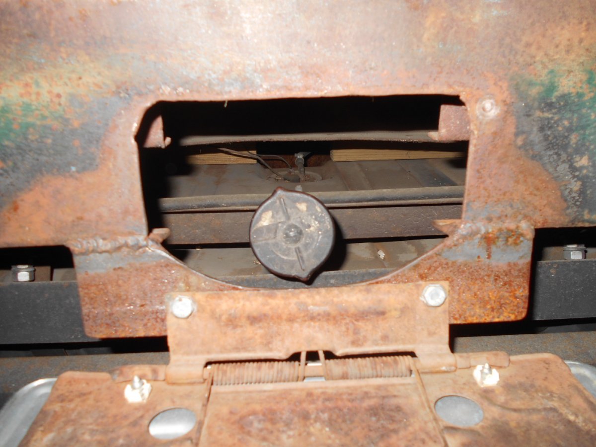

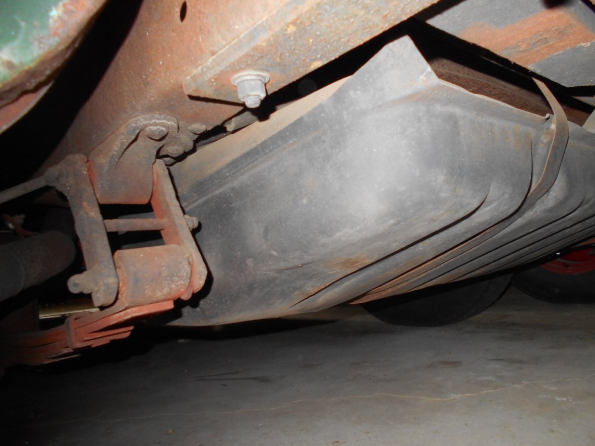

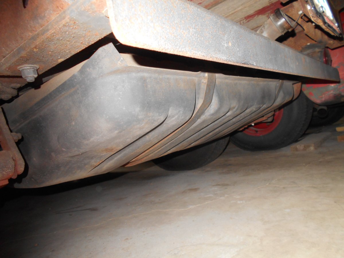

    ....don't know if this would work in your p.u., but 67-9 Camaro/Firebird,...or 68-72 Nova or (clones) work real well in advanced design trucks, filler is hid by flip-down license plate...not the best pics,...nothing hangs lower than the rear leaf springs...

    Thanks! I will keep that in mind for our AD project. From what I think I saw, it may be too wide for this frame.

    yeah they are a little wide, from pics on a C10 forums, I know they usually go to the outer edge of the frame on a 67-72 C10 and they usually hang low, but its what alot of guys use when going to that fancy motor chevy has that the current flavor of the month.

    ...Mustang tank mite fit, but it's hard to route the filler to anywhere but thru the bed floor, at least if you do go with this tank, the filler does end up near the tailgate, not one foot or more ahead of the gate.
    ...here's pics of a 'stang tank in my 48 Ford F-1,...that frame is fairly narrow compared to Advanced Design GM's, but the tank fits well, is 16 gallons, reasonable price aftermarket, and fills close to the tailgate.

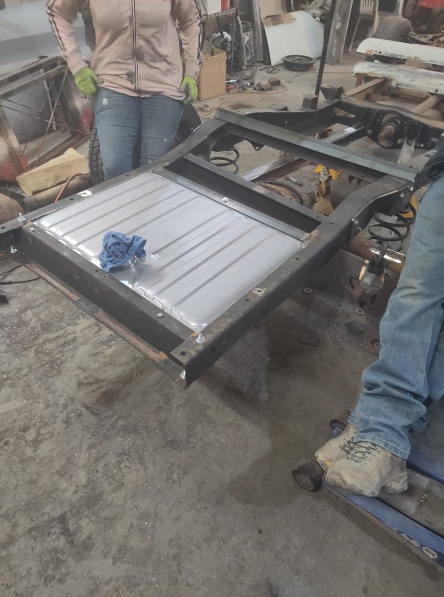

    So, got side tracked again on other projects as well as the fact that it was WAY too hard to keep the shop warm during Snowmeggedon 2021. Anyway, now that it is about 90 degrees warmer this week than it was last week, we are getting back in the mode of making progress. A good friend @Fif-t-3 sent me the attached pics of what I consider a pretty clean fill door installation which is heading me toward a gas tank that fills toward the drivers side. I do think we would make whatever door we choose swing toward the bedside when open to not be in the way of the gas nozzle filling and also use an older style cap. Then, another good friend gave us an old 55 Chevy car tank today to see how it might mock up in the frame. So far, it seems promising toward a pretty clean install. More to come on that soon.

    That is a nice looking set up. I guess there is plenty of extra room in the wheel well for the filler neck without worrying about it being hit by the tire?

    Well, not sure yet, but will report back soon. :D As close as we have gotten so far is to put the tank down on the floor under the truck to eyeball if it might fit. And, we need to put that tire back on to see what kind of clearances we might have.

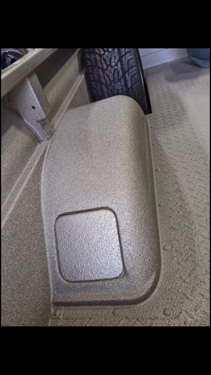

    That’s a super clean installation. The downsides would be what if you had the bed full of stuff, were running a tonneau, or a canopy.
    You probably already thought of this, but what about saddle tanks that have the filler in the wheel well?
    Another idea would be the GM 64-67 A-body tanks. The fuel neck is right in the rear center.
