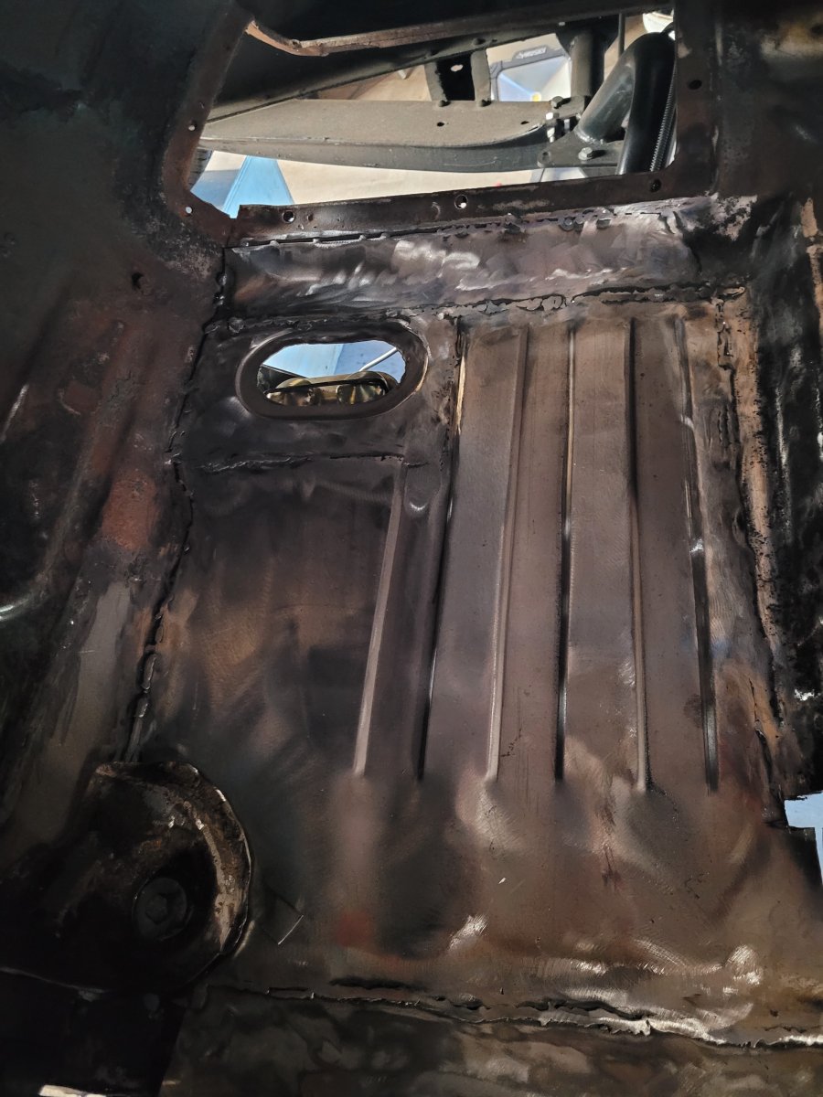

    Been putting in a new driver's side floorboard in my Sedan Delivery. It's been fun! The beadroller I built really helped! 20210223_173949.jpg

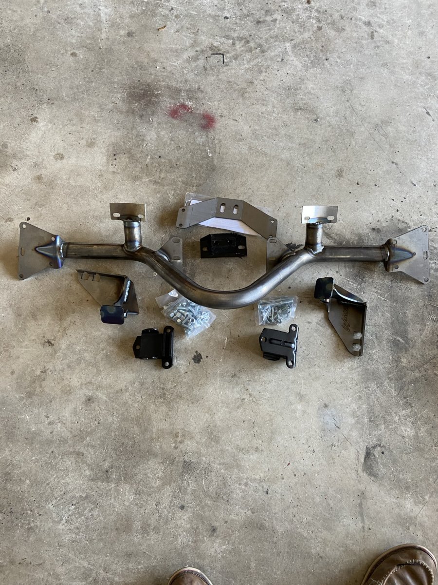

    The floor looks really good. What trans crossmember are you using? What brake pedal? We got the Walton fab crossmember. It just came in this week. We are leaning towards their fire wall mounted power master pedal ***embly. We are going to get the 307/TH350 in first, then evaluate if we still want the fire wall mounted master.

    Here are a couple of pics.
    I used the original master cylinder, and cut the pedal mount off of it, and made my own bracket. I used a master cylinder off of a 1972 Chevy pickup, I think. It seems to have worked well. I still need to finish up the pushrod ***embly into the M/C.
    The crossmember is a Waltons Fab, just like yours. Those guys are great to work with!

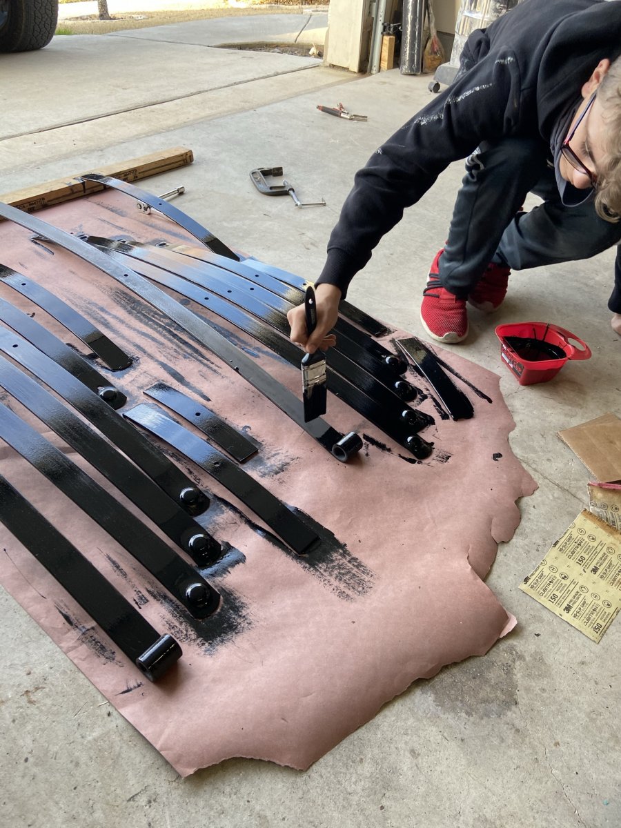

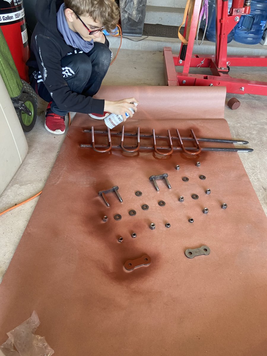

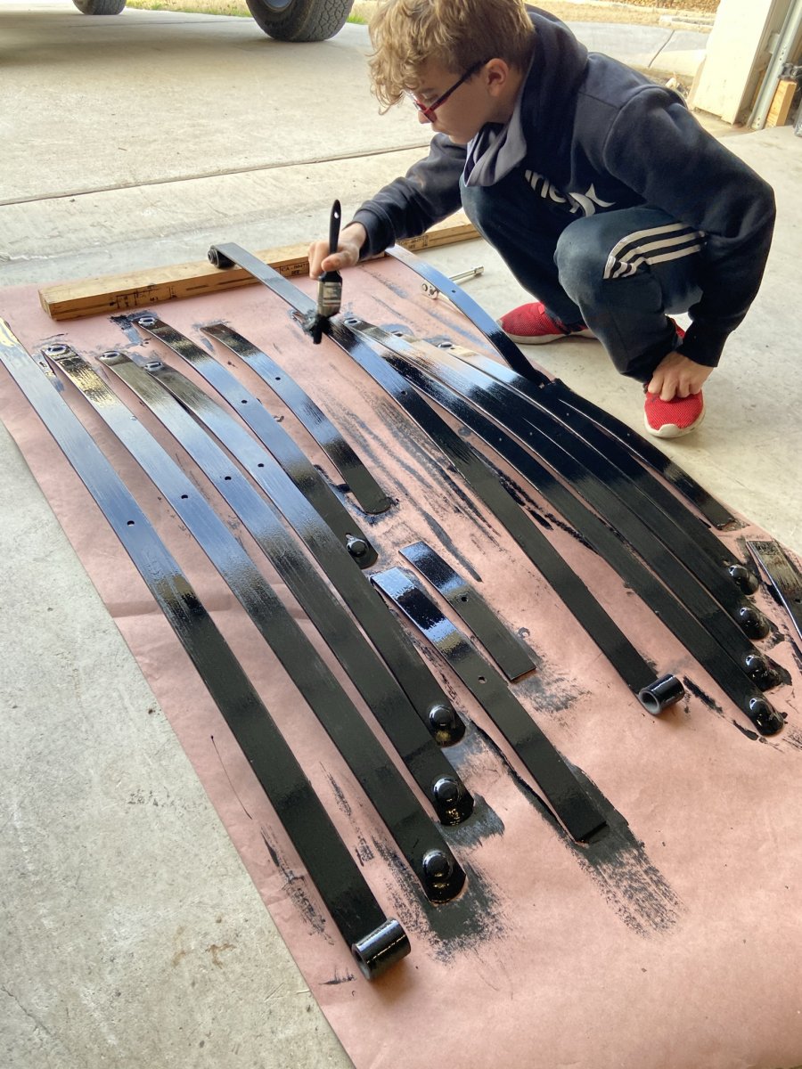

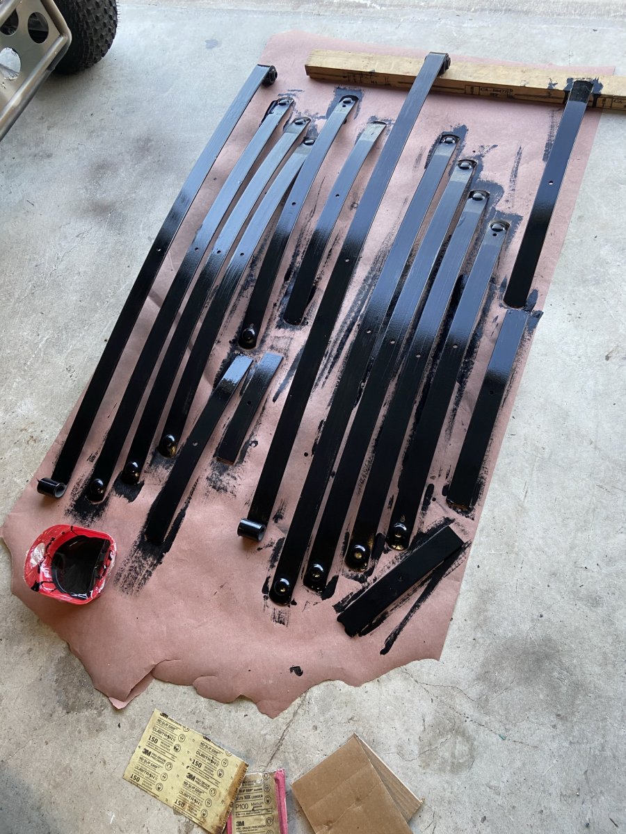

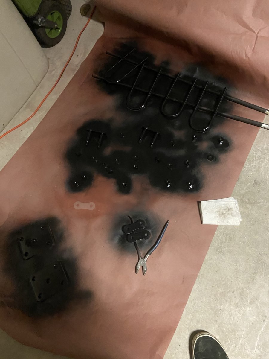

    Got some updates. We painted the rear suspension parts and rear end. We rattle canned the small parts, the pulled the springs apart and brushed Restoleum enamel, re***embled and put the rear end in the car.

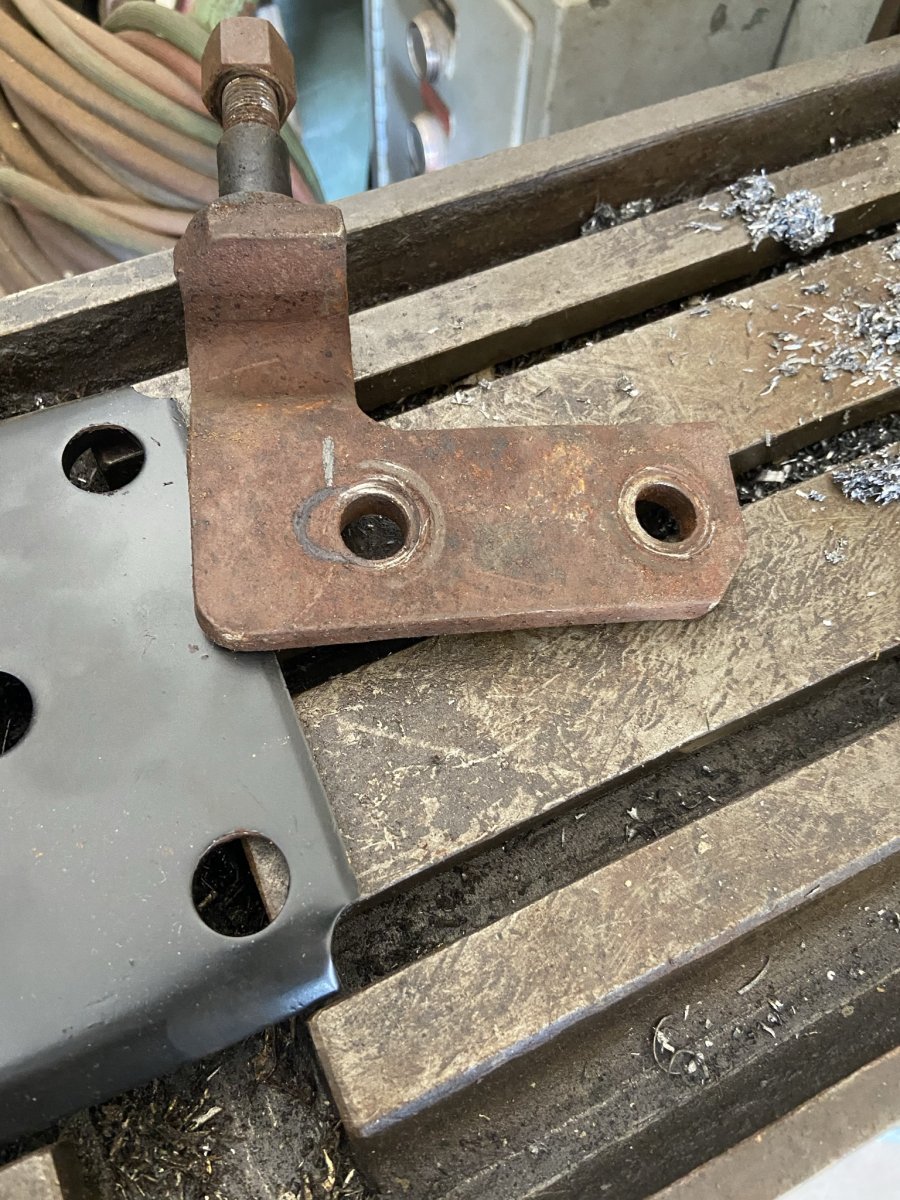

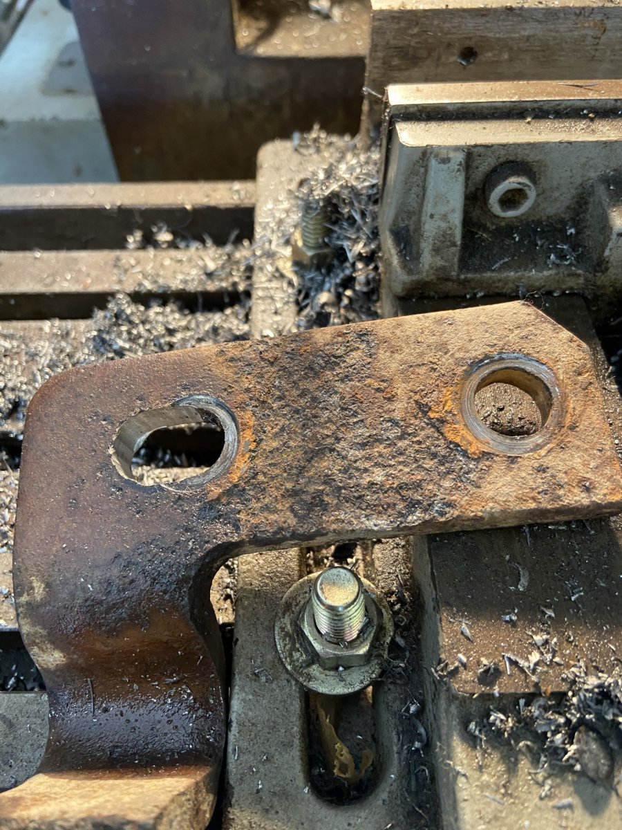

    Used the stock rear shock mounts but had to widen one of the holes to match the different u bolt pattern for the 55 Chevy rear.
  27. mlagusis
    Joined: Oct 11, 2009
    Posts: 1,259
    mlagusis

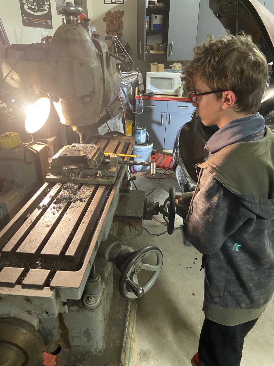

    Then Eli milled the bottom plate for the u bolts flat on one side for the shock mount to sit flush.

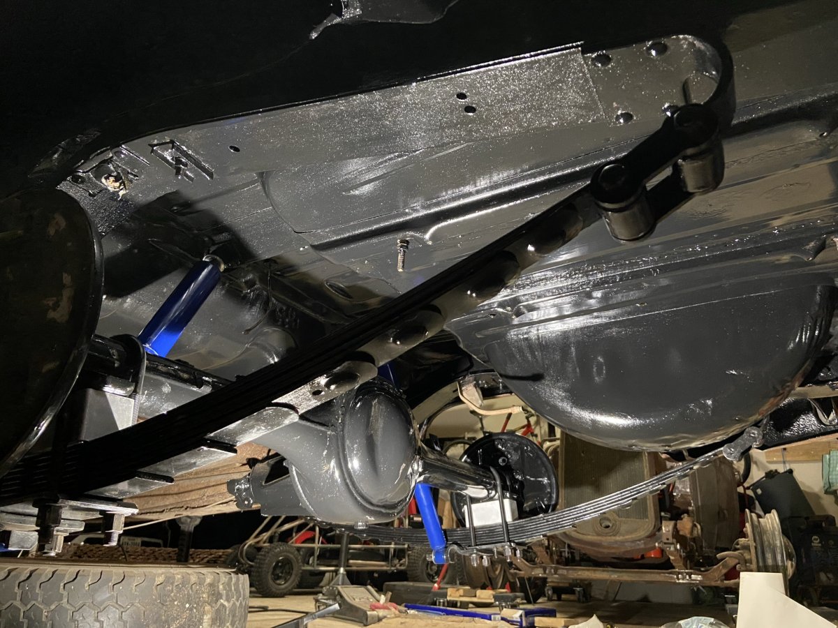

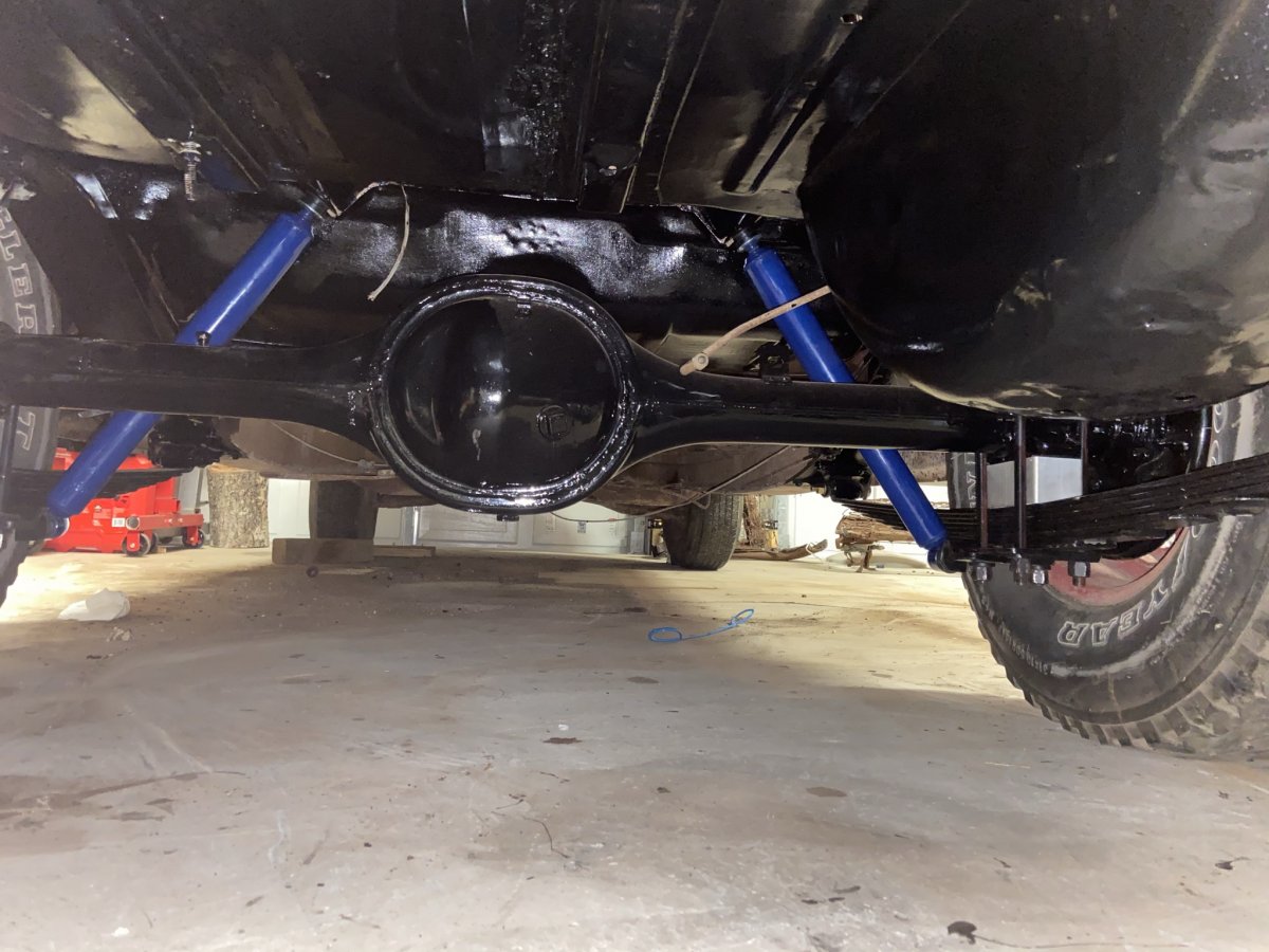

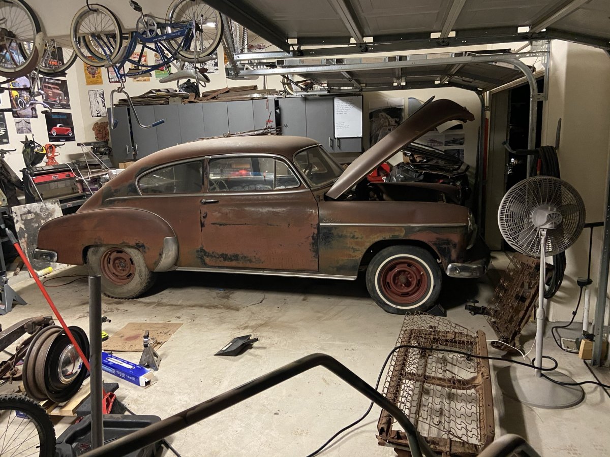

    Then we put the rear end in the car and set it down on four wheels.
  29. mlagusis
    Posts: 1,259
    mlagusis
    We put 2" blocks under the rear end. It still sits pretty hight but will drop down some when we take the 31" truck tires off the rear. Will probably run 205/65/15 wide whites with 54 Olds Hubcaps.

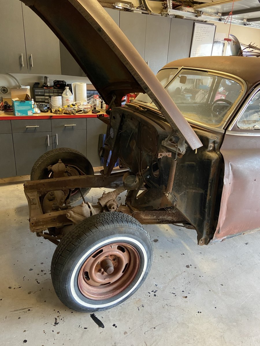

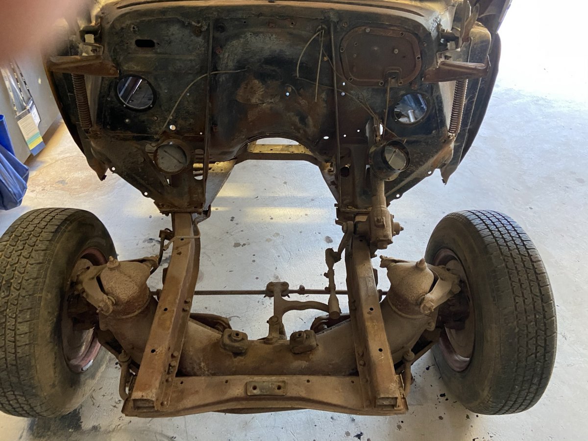

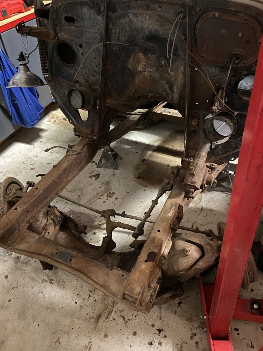

    Lastly, we pulled the front clip apart and dropped the front cross member. We are working on rebuilding the front end, finish painting the bottom of the car, then get the motor/trans in the car with the Walton fab motor/trans mounts. Mixed in there is welding in patch panels and replacing the body mount pads and bolts.
