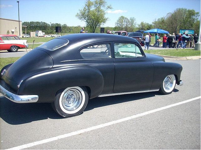

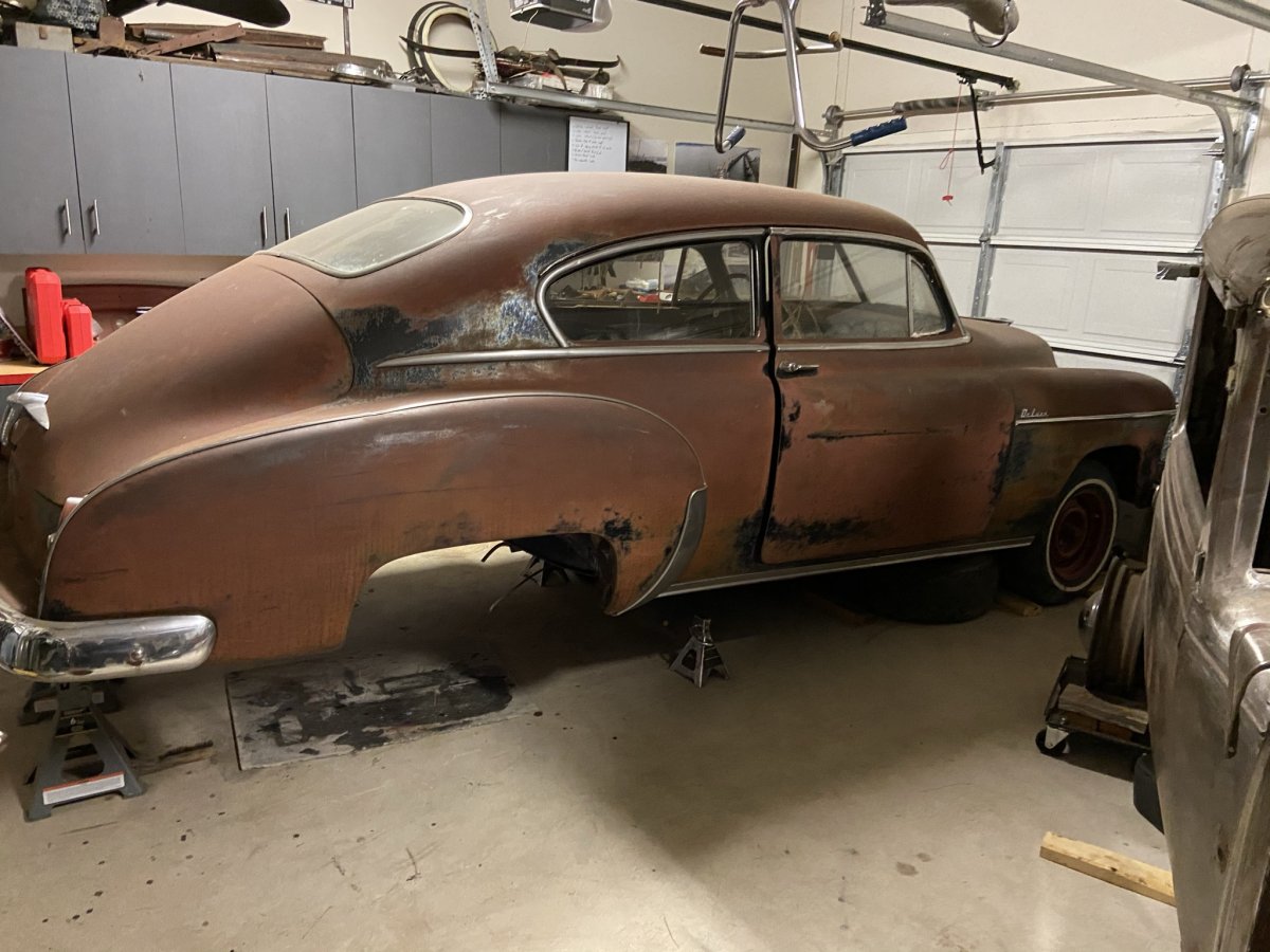

    I know I'm late to the party, but back when I had my Fleetline, I hadn't gotten around to dropping the rear end, but here's how it sat with 2 inch dropped uprights and a coil (maybe 2?...it was a little too much what ever it was. LOL) cut from the springs....just for reference for you.

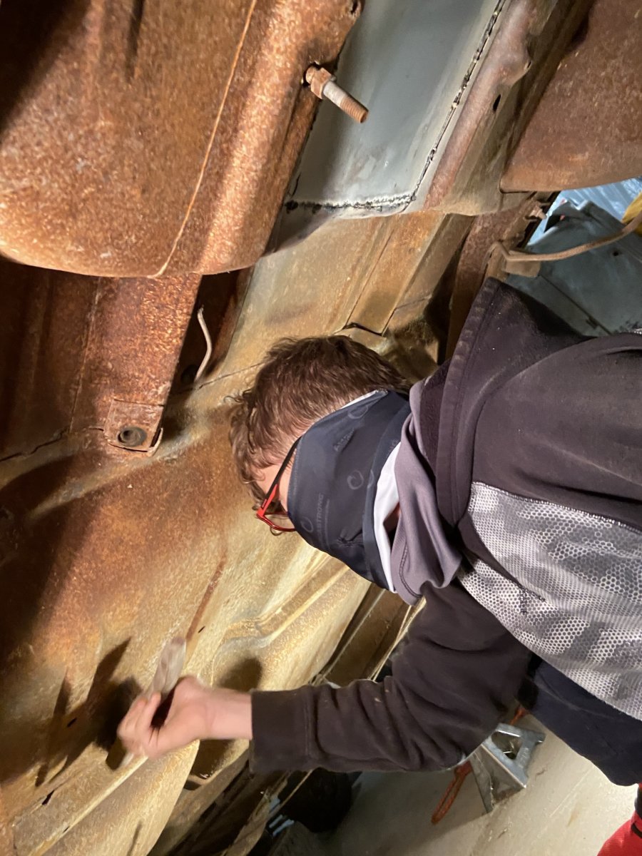

    We bought a gallon to use for the bottom of the car, inside floor, the bottom of the roof, inside of the doors and quarters. We are using Rustoleum to coat over it. We have maybe used 1/2 a gallon so far. It seems to work pretty good. I really wanted to pull the body from the frame but we don't have a lot of space so we are doing the next bext option. Ultimately, everything will have a good coat of paint so this car will hold up as long as possible.

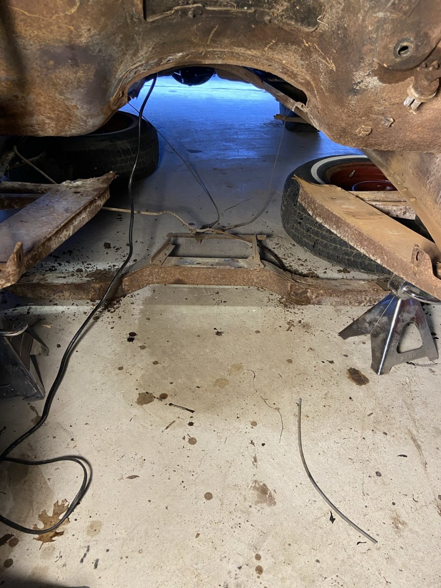

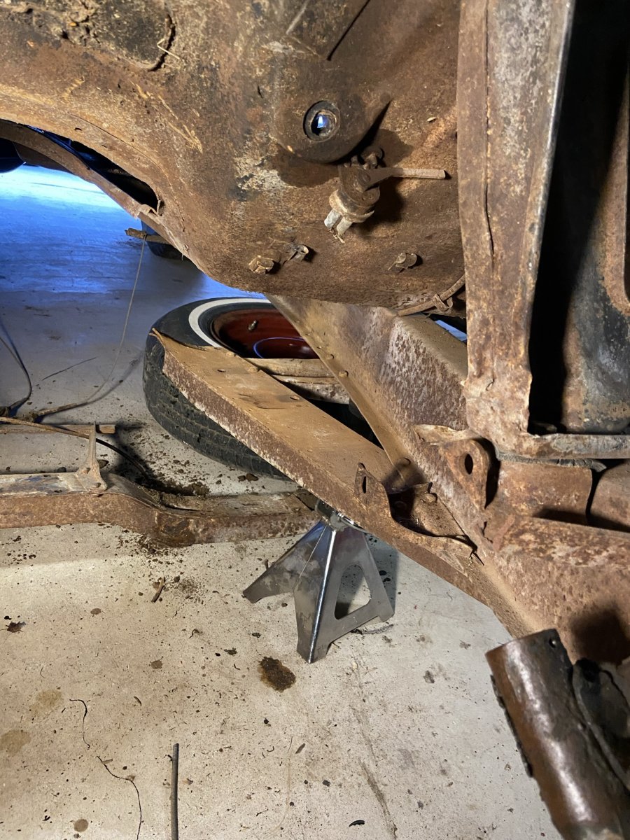

    Made a little progress this week. Got the trans crossmember out and have the suspension and crossmember out. We are going to weld in the patch panels on the floor next, then finish painting the bottom side of the car. After that we will move onto rebuilding the front suspension.
    We plan to use the 2" dropped uprights we picked up from a fellow hamber and new Moog coils with a coil cut.

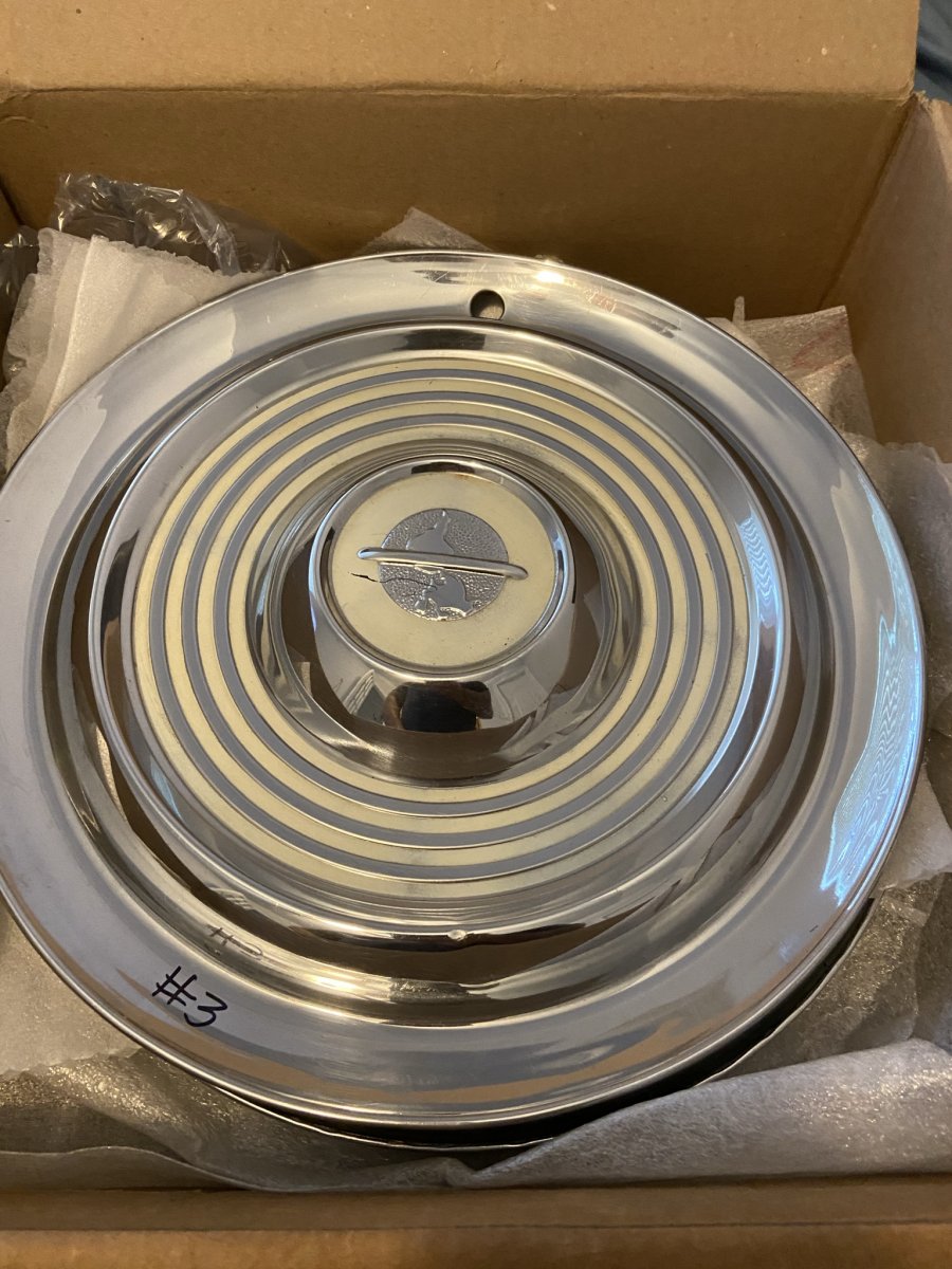

    Also picked up a set of five 54 Olds hubacps from a fellow hamber. I am hoping we can get some extra garage time this weekend...we will see.

    Your rear seems high. Are the rear shackles flipped the wrong way? They should hang, facing toward the frame. If they are facing the floor you need to flip them: jack up the rear if the car and use a big screwdriver or other tool to pry them past the halfway point. They will pop into the correct position, then lower the jack. (I made this mistake when I put new "lowering" springs on the back of my car and it sat a couple inches higher!)

    Thanks for pointing that out. The shackles are pointing downward. I will mess with it this weekend. Glad to learn this as I was a bit disappointed how high it sits with the new springs and 2" blocks.

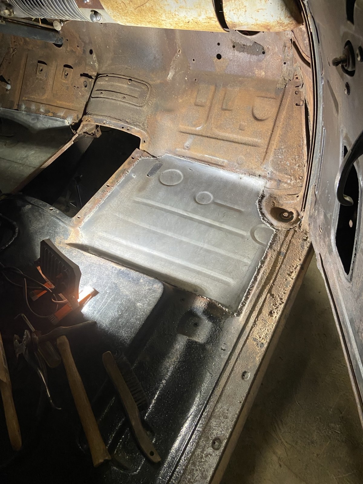

    mlagusis
    We are back on the car as of a few weeks ago.

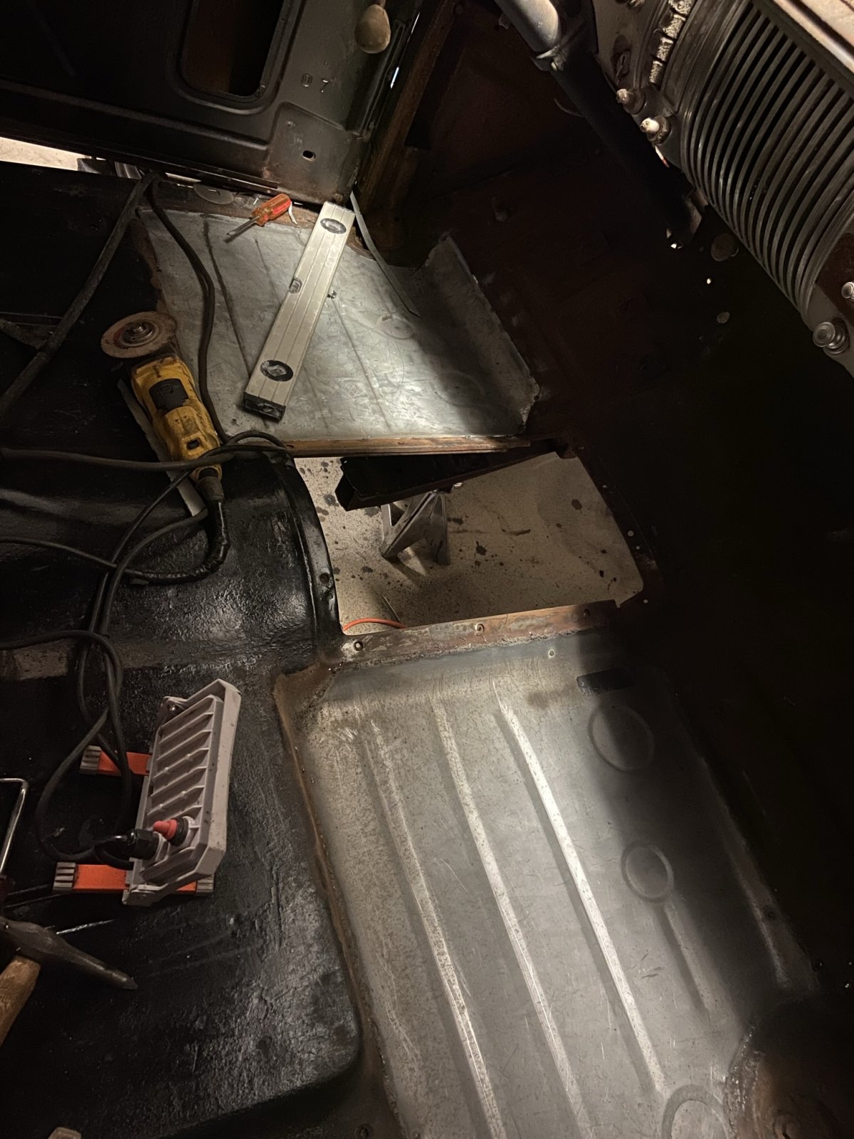

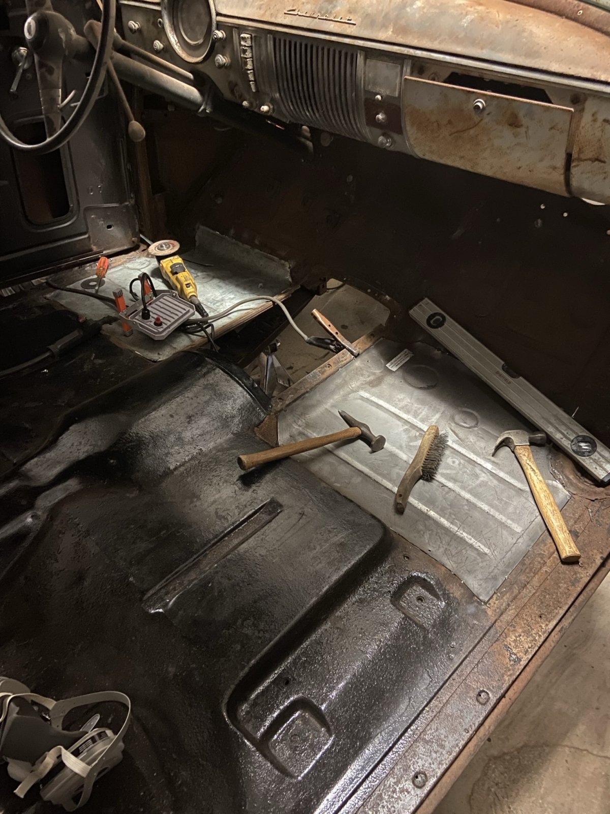

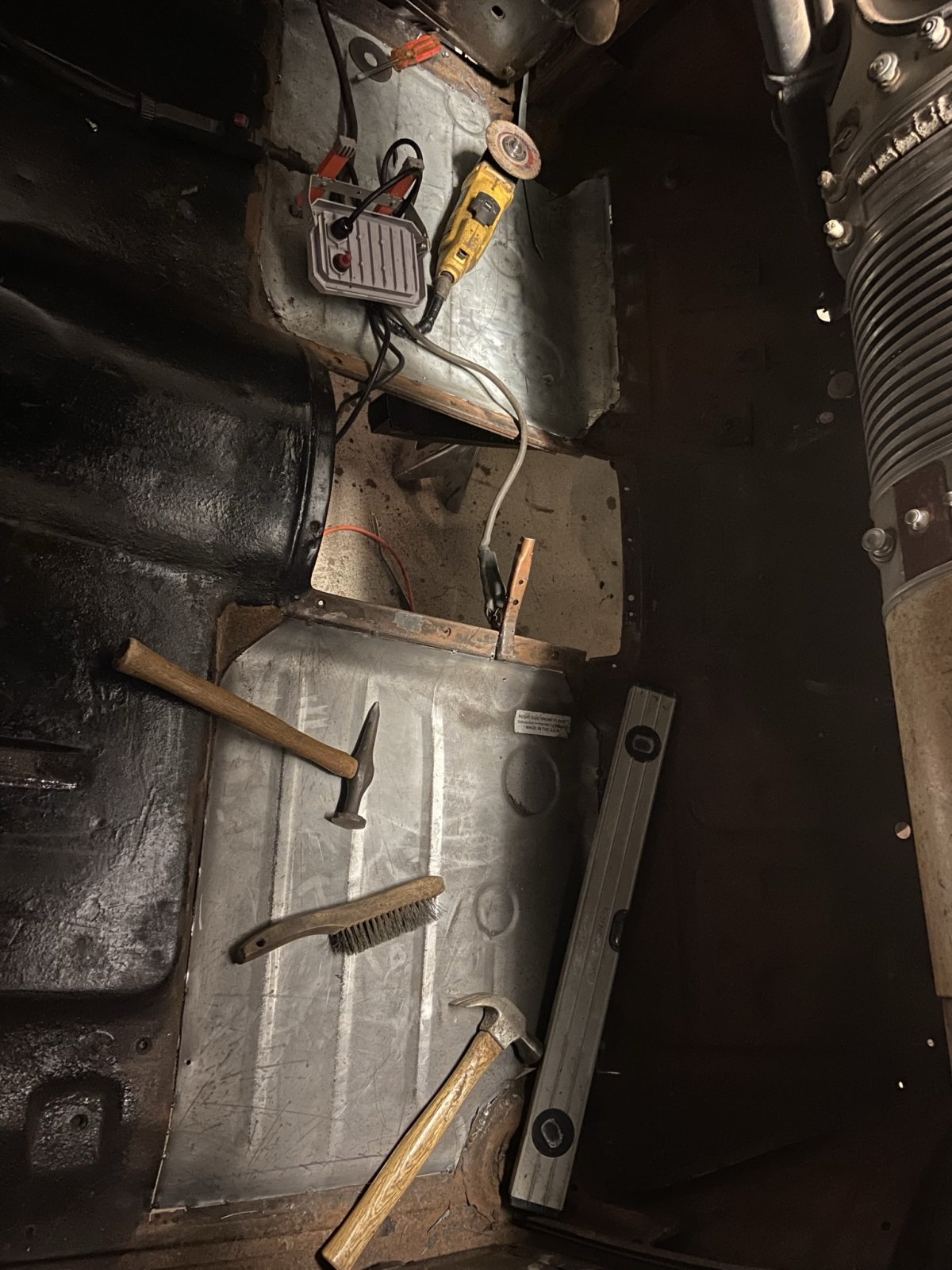

    Sorted out some off topic front suspension work. Now we are in the middle of the front floor patch panels. Once side is welded in, need to weld the other then grind and paint...etc. We are going to put all new body bolts and rubber pads before we get too far. Not pulling the body totally off, just raising it up, setting it on 4x4 wood blocks which will give us space to clean up and get paint to the areas we were unable to reach so far. Again, we are not building a show car, but want to make sure everything has a good layer of paint.
    Then we will be back on the front suspension, steering and motor/trans set up.

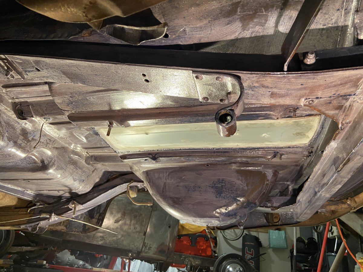

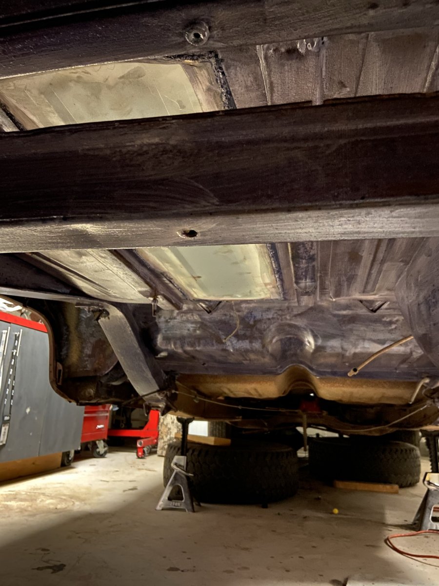

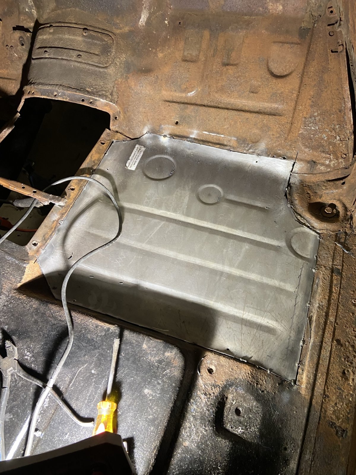

    Back at it on Eli's car. We got the front end back together and have the car on all four wheels. Finished up on the rust repair of the floor. A little more paint and stuff on the bottom of the car.
    We are not pulling the body off the car, but will lift it up and place 4x4 blocks between the body and frame so we can replace all the body mount bolts and rubber pads. Plus, this will allow us to get more areas coated with a solid layer of paint on the top of frame and other areas where we can't reach.
    After that, we are dropping the SBC/Auto trans in which should be pretty fast. We bought the Walton Fab motor and trans mount kit which will be fast. Also ordered their power boaster/pedal kit too.
